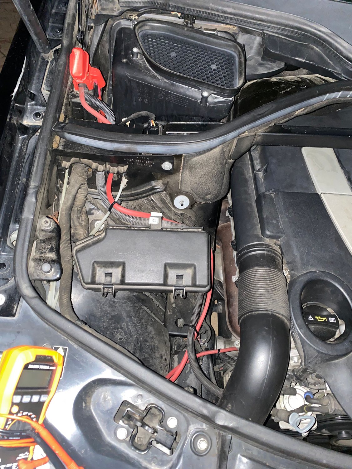

For anyone worried about the primary battery cable: There is one inside the engine compartment. It goes from the firewall terminal (under the red cap, for jump starting or trickle charging) down to the alternator and then on to the starter. It seems like the section of the wire from the terminal to the alternator gets corroded inside because it is not sealed and it is continuously conducting the full steady load of the motor, upwards of 50A.
Measure the voltage between the alternator positive lug and the terminal when the motor is running. You should only see a minimal voltage drop. I saw 0.5-1V, which on a 12V system is a huge loss. The alternator terminal was getting hot. Low charging voltage means the battery is routinely stressed.
Rather than replacing the whole cable, I just sistered a cable to the original from the alternator up to the terminal. This
Amazon Amazon
fit perfectly and left me with a spare. I got 4 gauge but since I was sistering I probably could have gotten away with 6 ga. $27.
The cable from the firewall terminal to the battery might sometimes need to be replaced, but maybe not, as those connectors are not exposed to the environment like the one on the alternator. Corrosion is the problem here.

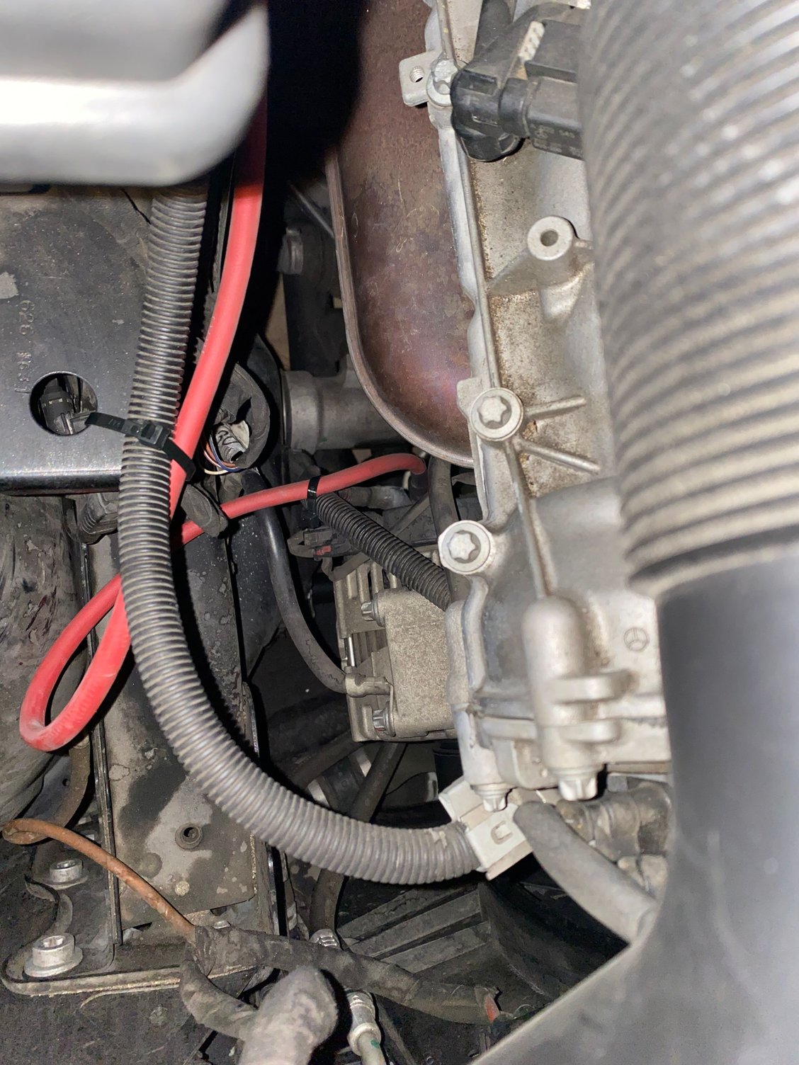

thank you for this recommendation. It helped fix my slow cranking issue and battery draining issues. I bought the cable off Amazon like you recommended. I’ll attach some photos of it “sistered” to the existing wires. Like most people on this thread, I’ve replaced the battery and the starter and the problem persisted. This cheap cable fixed it and took less time to install than a battery or starter replacement.

Glad it worked out for you. You might want to sister it the full length, so as to not have loops of primary cable, vulnerable, as you have it. Also be very careful of any possibility of the cable rubbing on the body. Try to imagine the engine wiggling around - which it can. You also can get wire loom, which is already on the existing primary cable and acts as a secondary protection (but is mostly aesthetic).
Good job; glad it saved you.

ok thank you for the further recommendations. I will get some wire loom and try and sister it the full length to make this more of a cosmetically and functionally better repair. Great idea. Thanks again as I thought your post on how to repair was the best so far. You must have some proper electrical training! I’ll try to post another photo when I get the loom.
Thanks, just trying to help, and glad it did.
Note I would post a picture with the loom - I have some available - but I haven't bothered! The cobbler's son walks barefoot.
