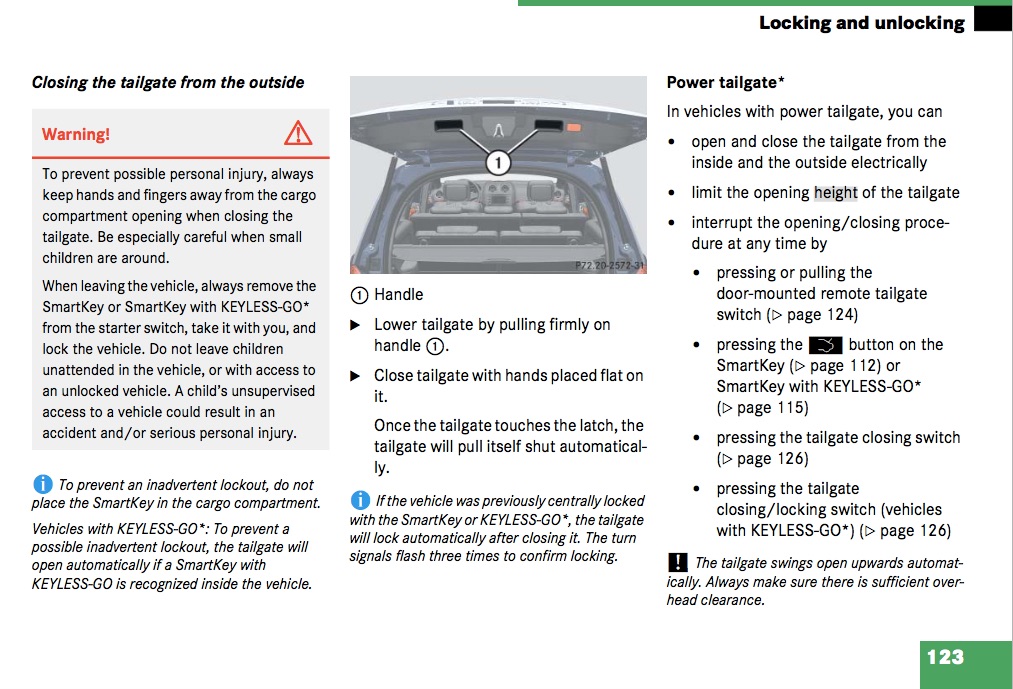

In the manual it tells you how to reset the height.
First set it to the lowest height settings then close it two or three times, set it to the desired height.
Try that, it worked for me.
Attached Thumbnails Help with rear hatch.-height2.jpg   Help with rear hatch.-height1.jpg
