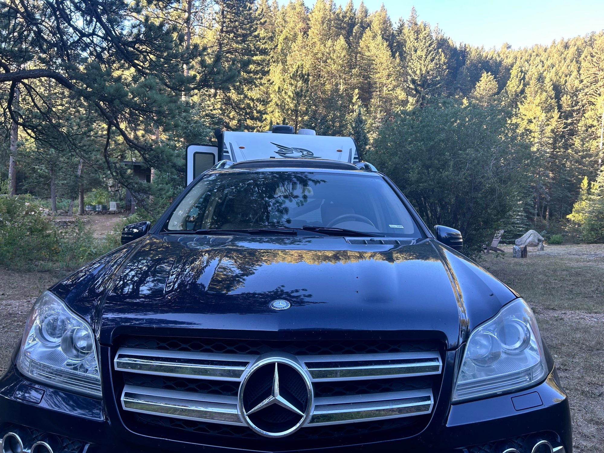

Update several years still going
Originally Posted by Chaddydsm
I just had it done and completely regret it. Have a 2011 GL450 we’ve driven all over the country. Replaced air springs a few times, decided to do coils because I intend to drive it forever and cost over time appears less for a guy like me that doesn’t work on his own car. Had strutmaster conversion done - Car rides like a tank now. I’ve had warning lights, sensor problems, you name it it’s been a nightmare since they took out the air springs. Reliable mechanic in the past, swing and a miss on this one. I’d trade it straight up for an old Prius at this point. Loved the GL for years, the coils made it a tank with nothing but problems. Pay the money to fix the air springs.
9/2025- after 3+ years and another 80k plus miles I’d have to say the coil overs have been reliable. Worked out the light and warning bugs. I still tow a 5,000 lb camper all over the country with our 2011 GL and it’s been great. Doesn’t ride like it did with air struts but the strut master coil over conversion has been really reliable. Still love my GL - about to turn 200k right at the next oil change. Still going strong.
