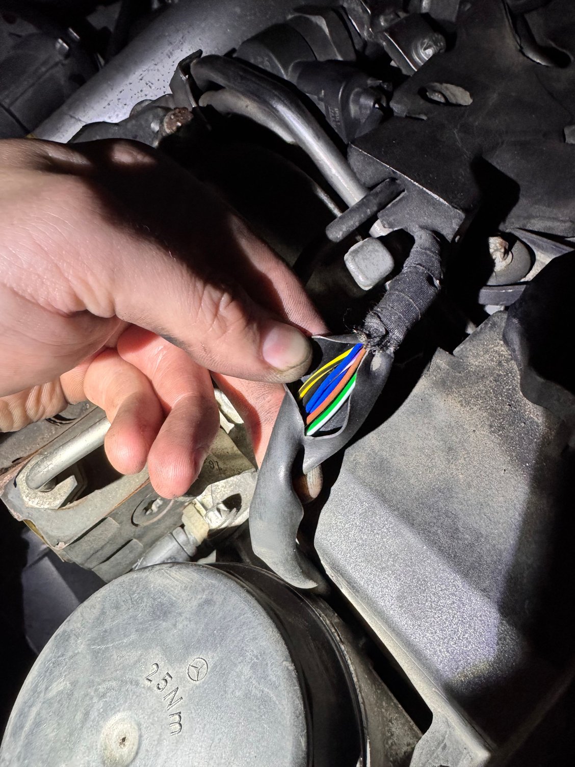

Which wire
Originally Posted by Lamont Clemons
hey guys for the same Problem, my harness Looks Similar to this one, cant firgure out which is the Right one Cam somebody help with That ?
