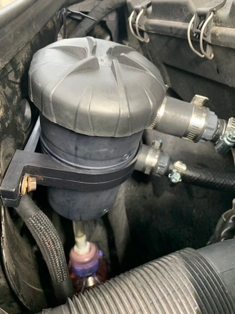

I installed the MannHummel ProVent 200 on my GL350. Just returned from a 4000 mile trip and it scooped up almost 16oz of oil .
It is amazing how much crankcase vapor voltage volume is generated by these engines.

I have had the setup installed for 3 months / 8,000 miles. It seems the large supply hoses (1") allow added volume to the system and also seems to slow the velocity.
I live in a hot climate but upgraded the heater element where it goes into the intake. The Mann Hummel instructions show draining back to pan but I put a 36" hose from the bottom of the ProVent to a nice brass ball valve, then another 24" to a drain point.

I used 1" ID hose that fits the Mann Hummel provent 200 intake and exhaust nipples. The provent has a check valve and pressure valve built in, I did not add another. I came off of the factory CCV valve at the back of the passenger head with the factory hose, went to the inline nipple that is there (factory crimps), seperated these and then adapted to 1". Did the same 1" to factory nipple ID (5/8").
On the heater i used the updated part number for the OEM. The heater is the copper inline deal that goes into the intake right before the turbo.
I have not had the setup in the cold weather yet but have seen others get a moisture in the catch can which ends up being a "creamy" mix. Due to this I thought I would just capture the oil in the can, rather than have this mix go back into the pan. Same scenario if you do short trips. If you returned it to the pan that would work as well, you would want to use I think super high quality AN type fittings as you would not want any failure at the oil pan level. The pan on mine is steel so welding a bung into it would be easy.
So far i am super happy with what i am seeing. Dry intake for once, Hummel seems to be very effective. Curious as to how long the coalescing filter inside will last?

where did you get the bracket that you attached to the catch can, that looks great! Did you fabricate yourself or buy one…also, where did you get your hoses

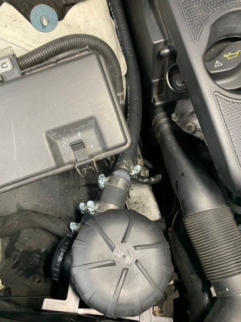

Here’s my install with 5/8 hose to MACHSWON’s “Provent 200”
Added a short hose to a drinks bottle with a threaded on connector above the FR wheel liner.

I have done 3 catch cans - I have used 5/8 hose, cut the breather line and then run both hoses up the right of turbo. and wire tied one to the turbo heat shroud to keep it in line
I have just used copper tube as a joiner and put a hose clamp either side to join the hose to old breather, I have also rotated the breather line 180 degrees on the black valve box to help the hose not kink too much
I have NOT run to sump - sort of like to keep an eye on how much oil I am catching.
think it is a great idea and worthwhile project

I fabricated that bracket to get the Mann Hummell in just the right spot. I purchased the hoses from McMaster Carr, fuel and oil duty. If you look at hoses specs it is surprising how many hoses cannot handle oil. These hoses are for fuel supply lines, they have a metal coil so they will not collapse under acceleration.
