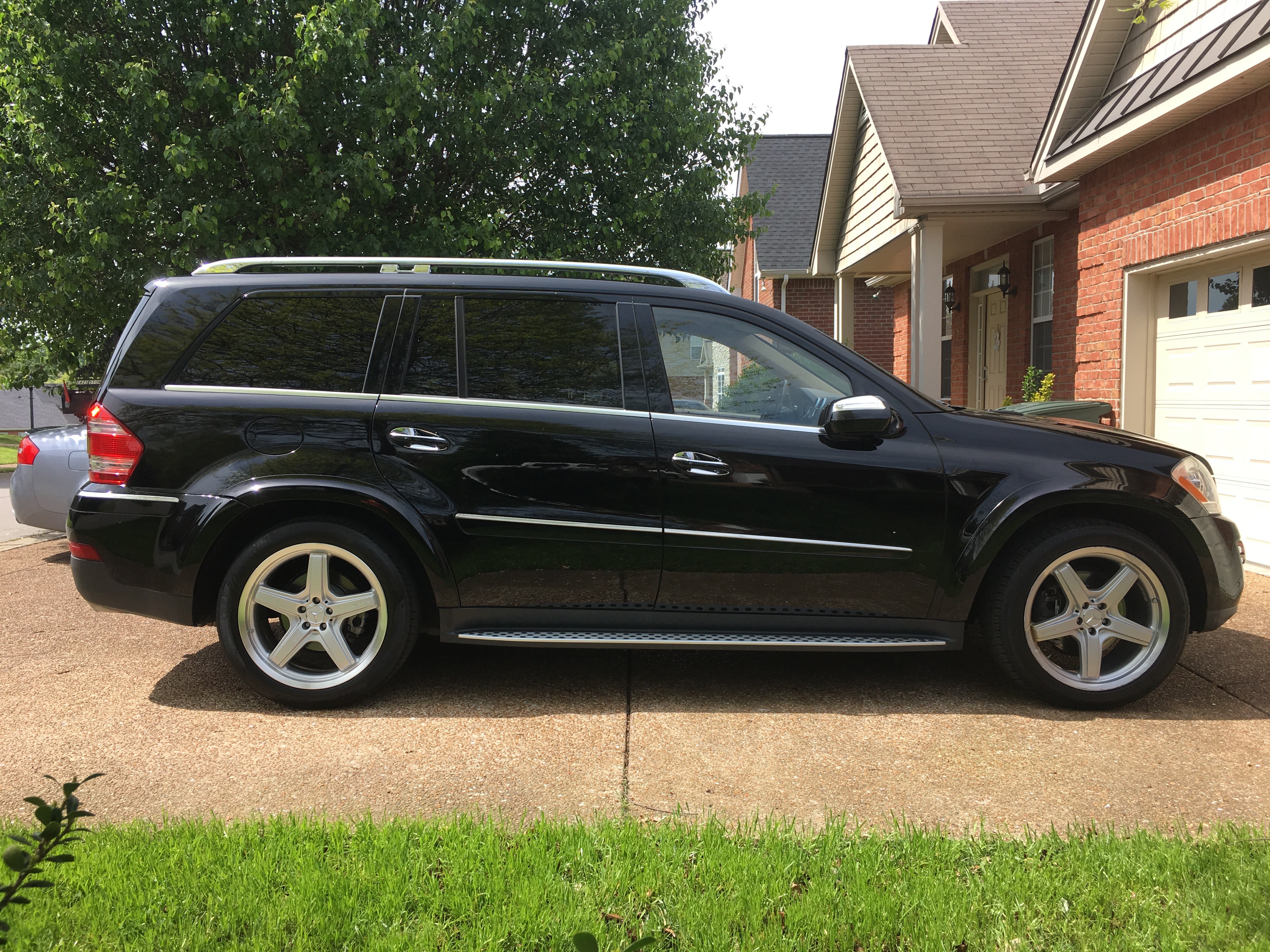

current status update after having the car for a week:
- A/C solved: pinhole leak in a hose. Hose replaced and system recharged.
- liftgate is throwing "pinched sensor strip" code but nothing else. after popping a trim piece (black, right behind the bumper on the right side) back into place, it's closing 80-90% of the time now.
- the interior looked rough, and the asking price was thousands below book. I replaced a broken driver's side lumbar switch ($80, eBay), and a tatty and smelly center console storage bin and armrest with broken latch ($160 for both on eBay).
- still undecided on whether to fix the sunroof switch. It works with one finger except when closing, where I have to hold one end in place with my thumb and pull down with my index finger. I'd have to replace the whole dome assembly and it just may not be worth it.
- cleaned all the leather and other surface and took off a ton of grime. just need the carpets cleaned and it'll look like a car worth paying full book retail for.
- I'm going to tint the front windows; OCD requires all windows to match :P
- I put in HIDs in the foglamps and LEDs for the high beams. The HIDs came out to be too blue; HIDs in general throw more light than top-notch LEDs, but I should have just slapped in a pair of Philips H11 LEDs; I put a set of them on one of my Ducatis and I can't complain. A tiny ballast and no cooling fan makes them truly plug and play. Three years on my bike without issues; I think they're worth the $110 or so - the set cost $160 when I bought them back then.
- still need to find a good quality LED for the parking lamp
WARNING: when fiddling with the high beams, do not push too hard on the reflector. It's on a ball hinge and can pop off with relatively little force. To get it back into place and to connect everything to the auto-leveling servo motor, one needs to pull the whole headlamp assembly. So the car is going back to the trusted local indy mechanic to sort that out, plus to get Service B done.
- brakes feel a little mushy (compared to our deceased '11 GL450). So I'm going to ask for a brake bleed as well. I'll find out the condition of the pads and rotors then as well. One good thing about these cars - new rotors and pads are surprisingly cheap.
Feeling that this car is working out more and more. Mechanically it runs perfectly. The entire air suspension was replaced by the previous owner, so the air compressor is new and there are Arnotts on all four corners. Come time to replace the air springs, and I'm out labor only.
