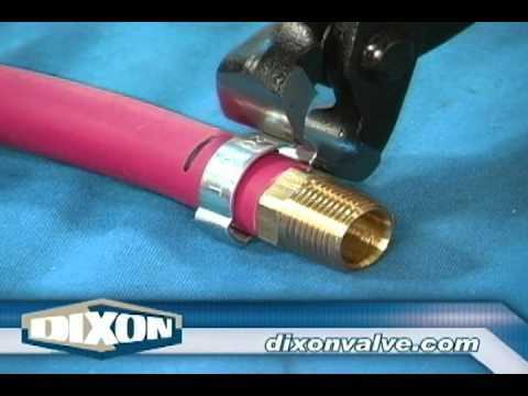

Got this jaw pliers for this clamp
I got this off from the tank but looks like I have to cut it to remove the clamp - please suggest.

I have removed clips like that. You can cut it if you like. But, if you put an item right in between the gap, like a screwdriver, you can spread it so it opens up.
