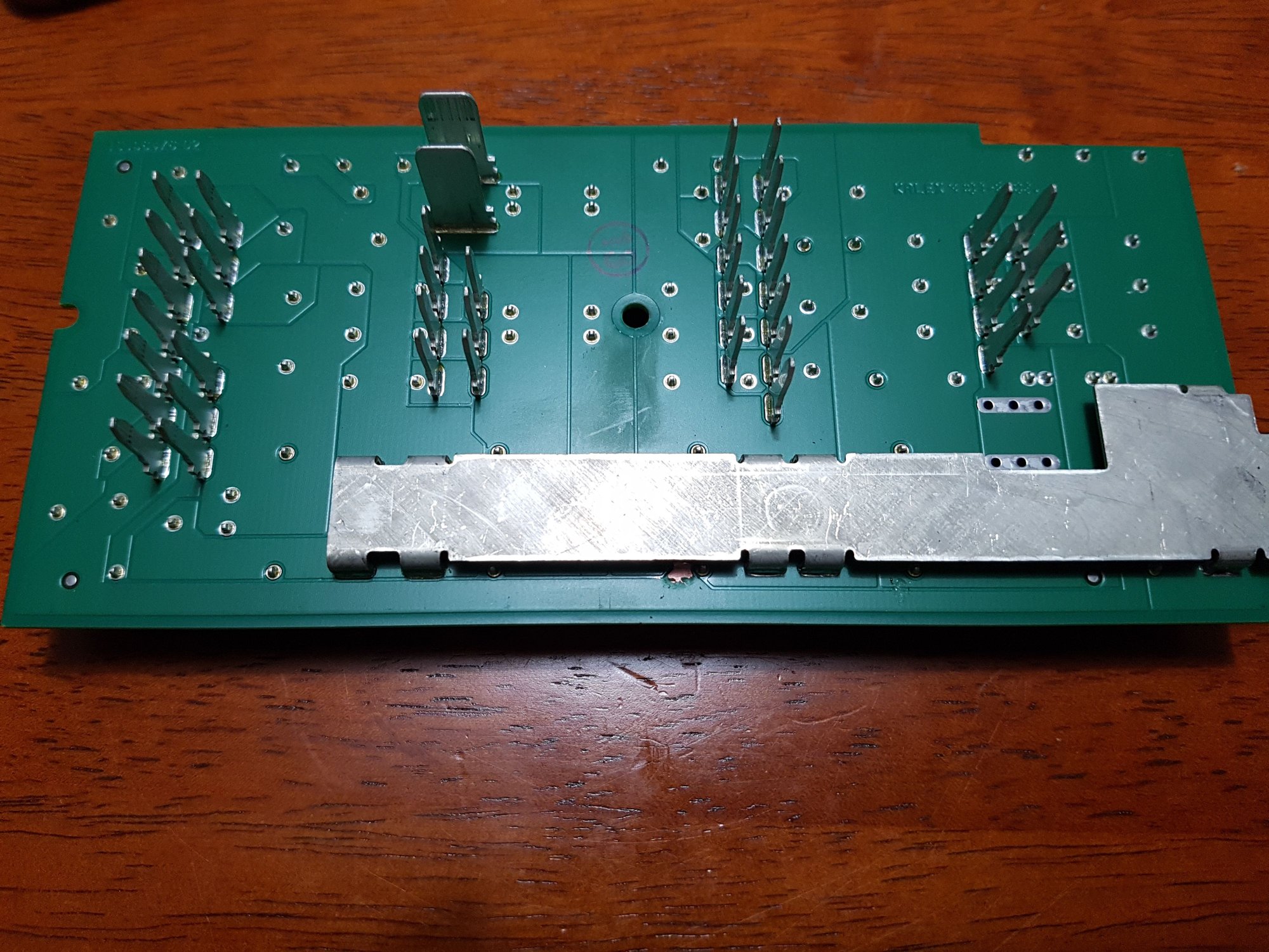

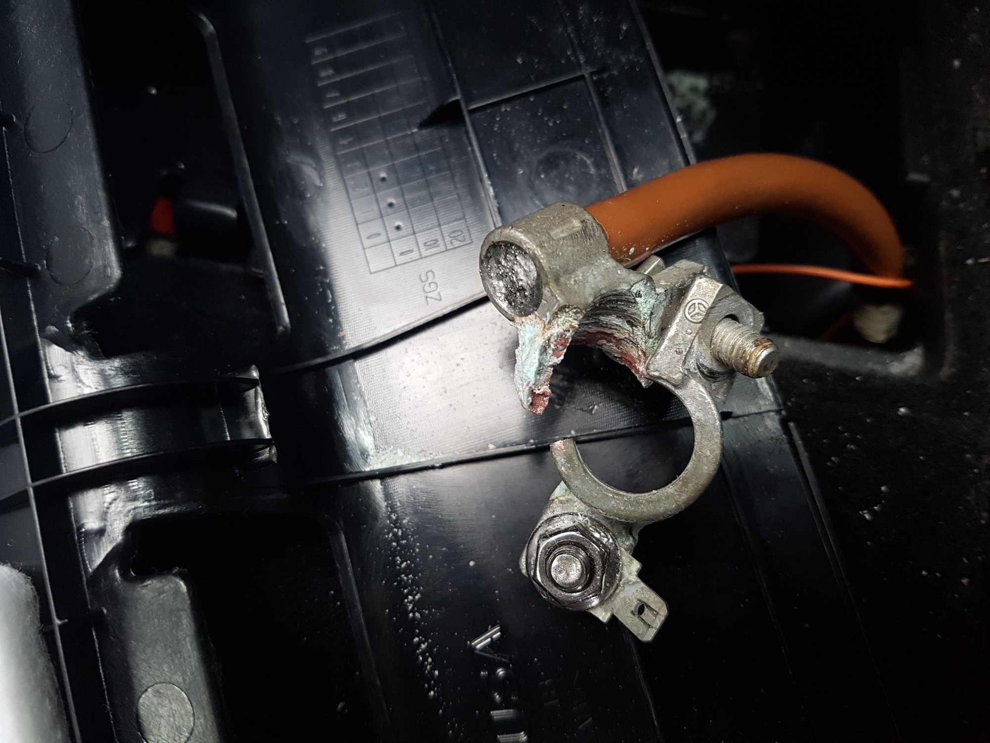

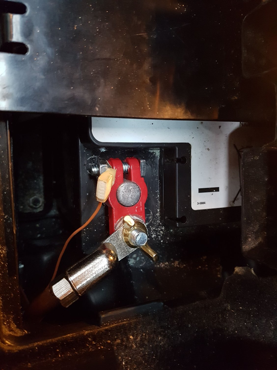

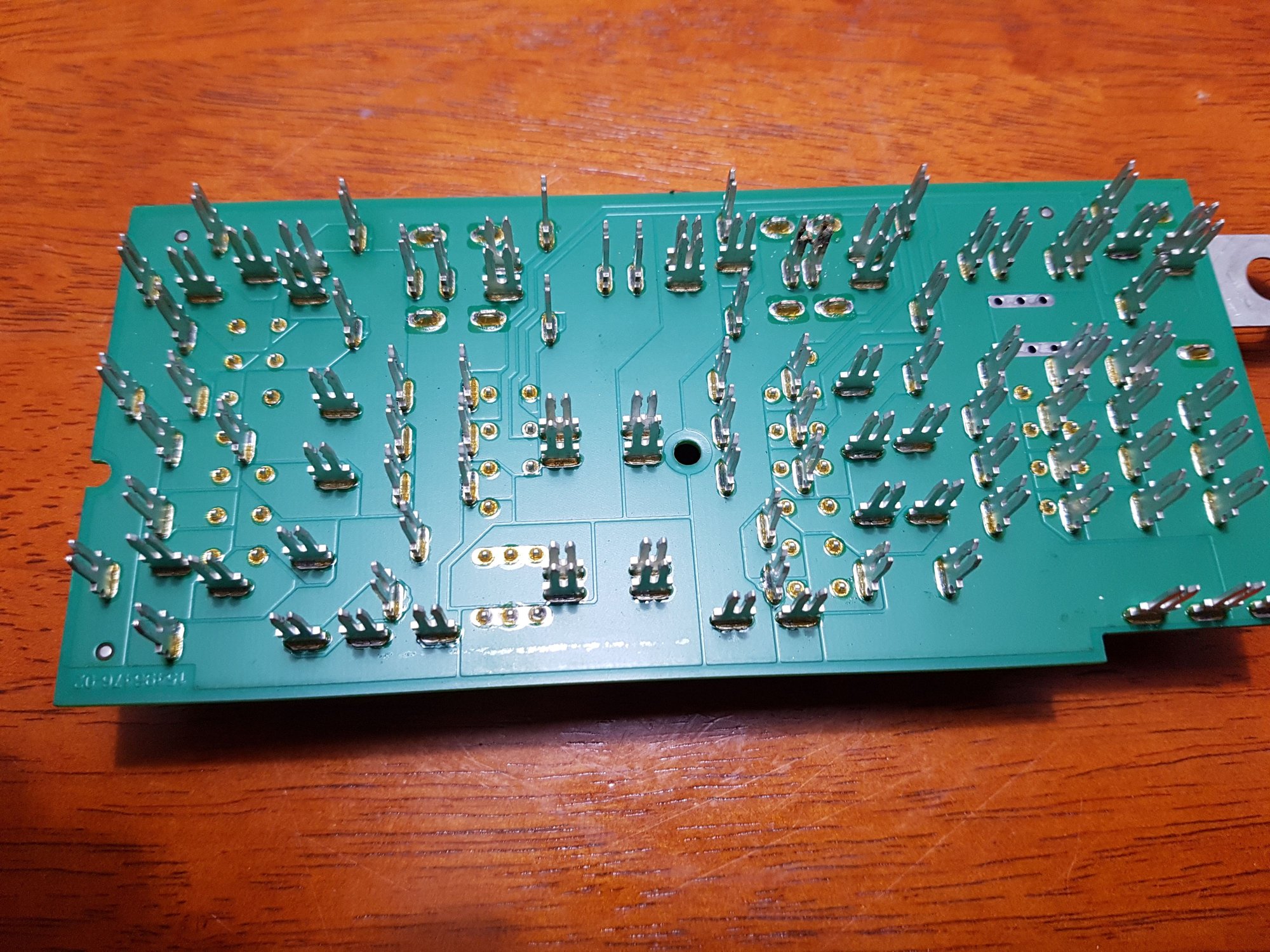

I decided to pick up used front fuse box. The used part full of water since it was sitting outside for unknown days, months, or years. my new pumped arrived last Friday. Opened used Fuse box and started cleaning each connection after I went to my car and replaced my pump. When the time to replace my fuse box, I tried to disconnect the battery and look it broke when I tried to wiggle it .... grrrrrrrrrrrrrrrrrrrrr...................
Oh when I removed my pump, i didn't put jack in 4 corner of the car and the car still sit at level.

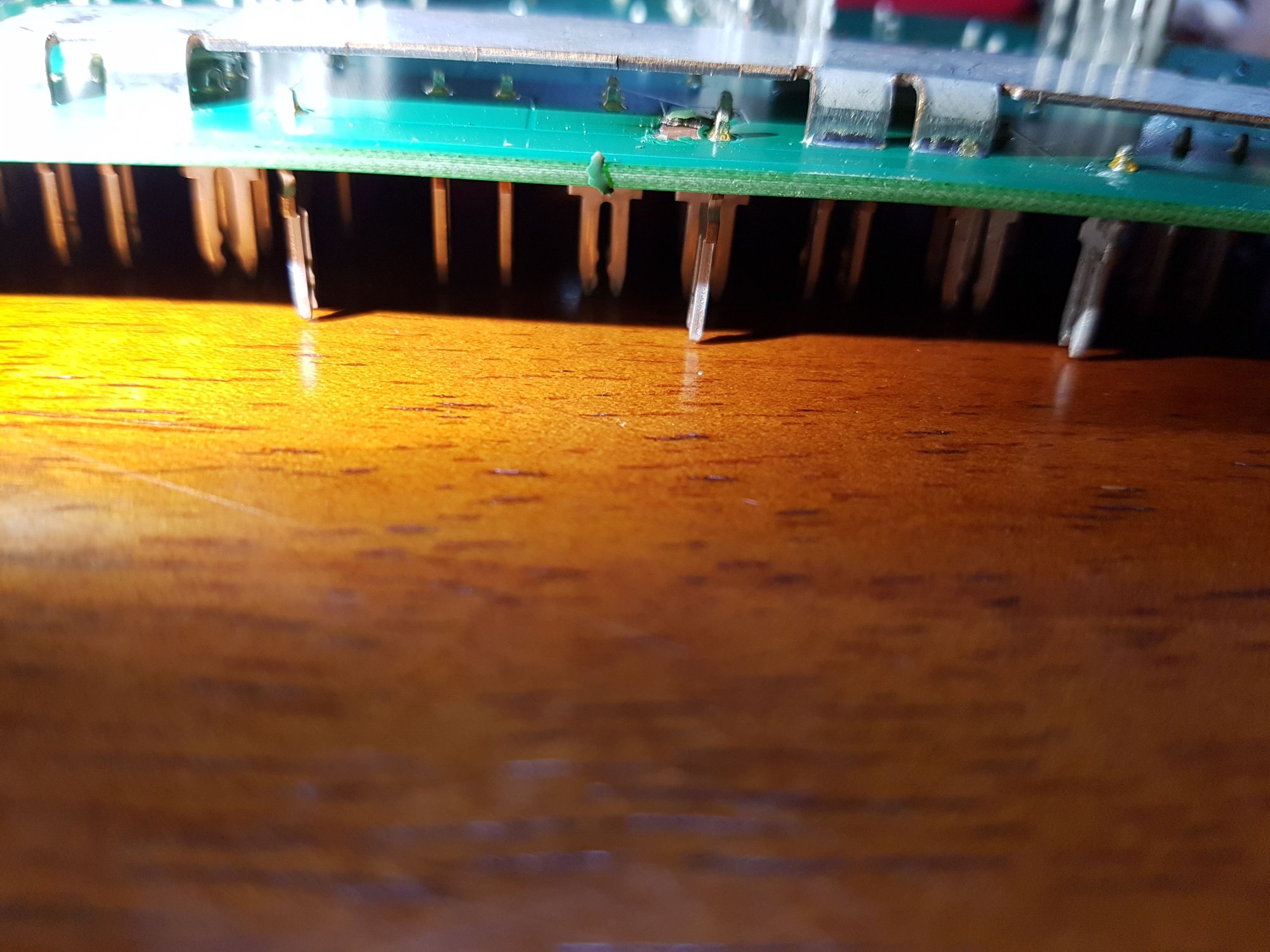

Removed my fuse box, open my fuse box and found the burned. Anyway I matched everything with the used part and put everything back and fixed that battery head the broke. Connect everything back and start the car. All good and car back on the road. I am paling to fix this fuse box when I have time in case this thing happen again.
I still don't understand why the fuse box for airmatic relay burned when I put other relay. The other generic relay has the same connection and out put. Also I don't know why if you remove the airmatic relay, the car would not crank. All light will turn on but can't crank.
