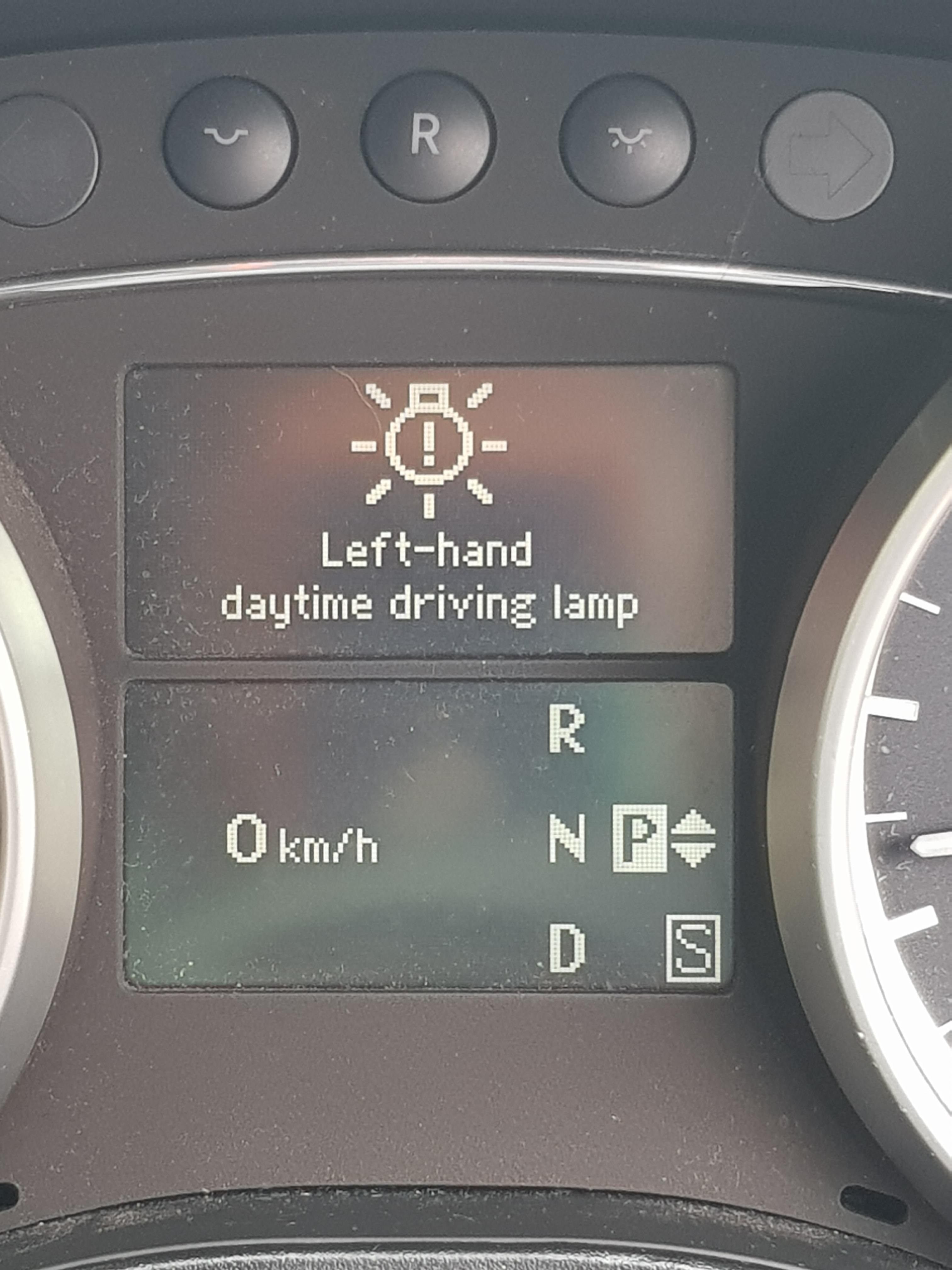

my Left hand factory fitted DRL burned out and found virtually no information on this online, so I thought I'd join up and create this walkthrough.
error message

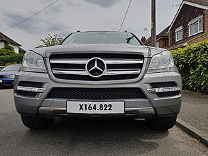

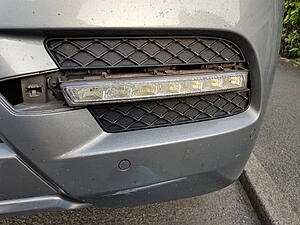

light not working

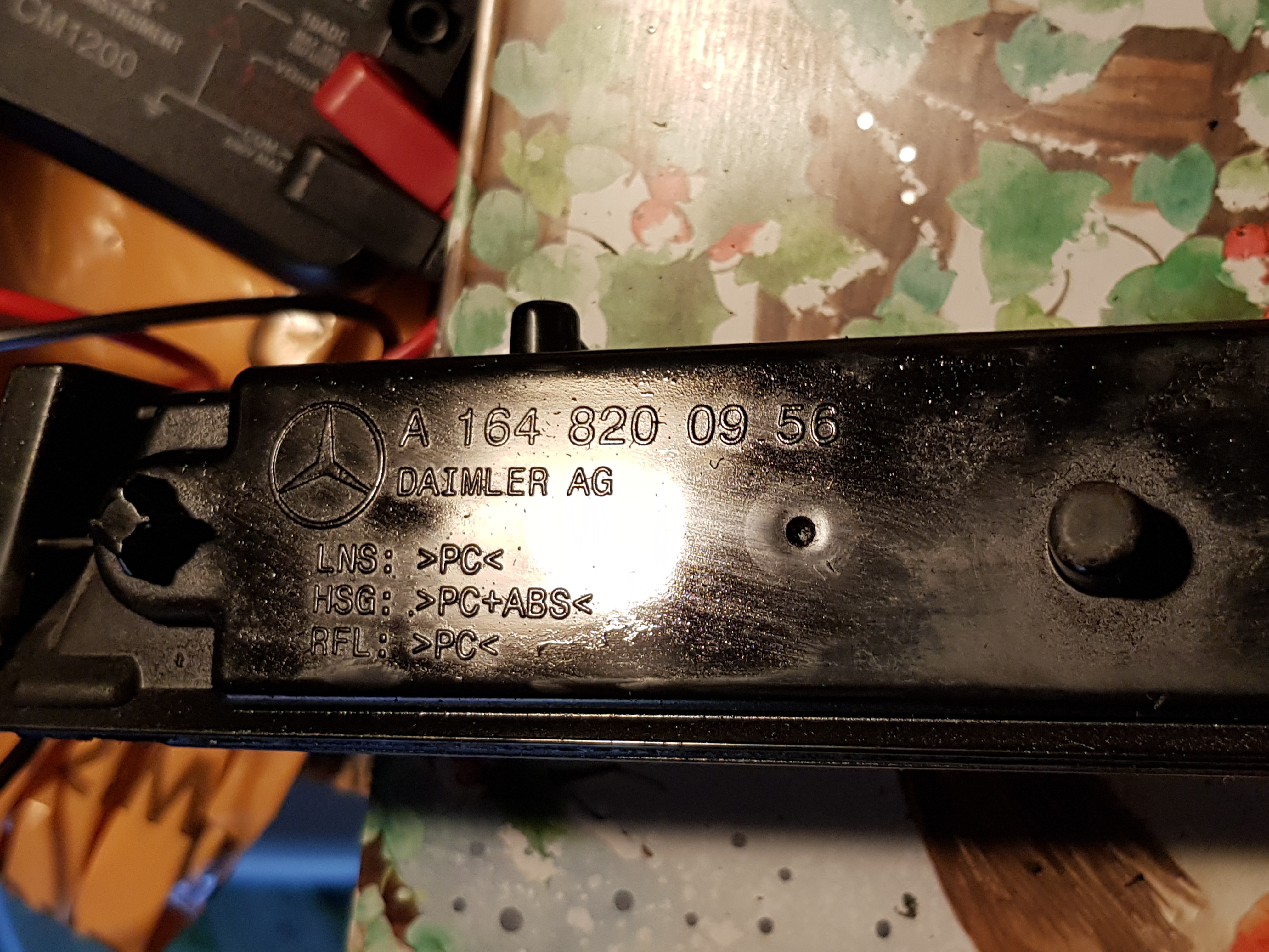

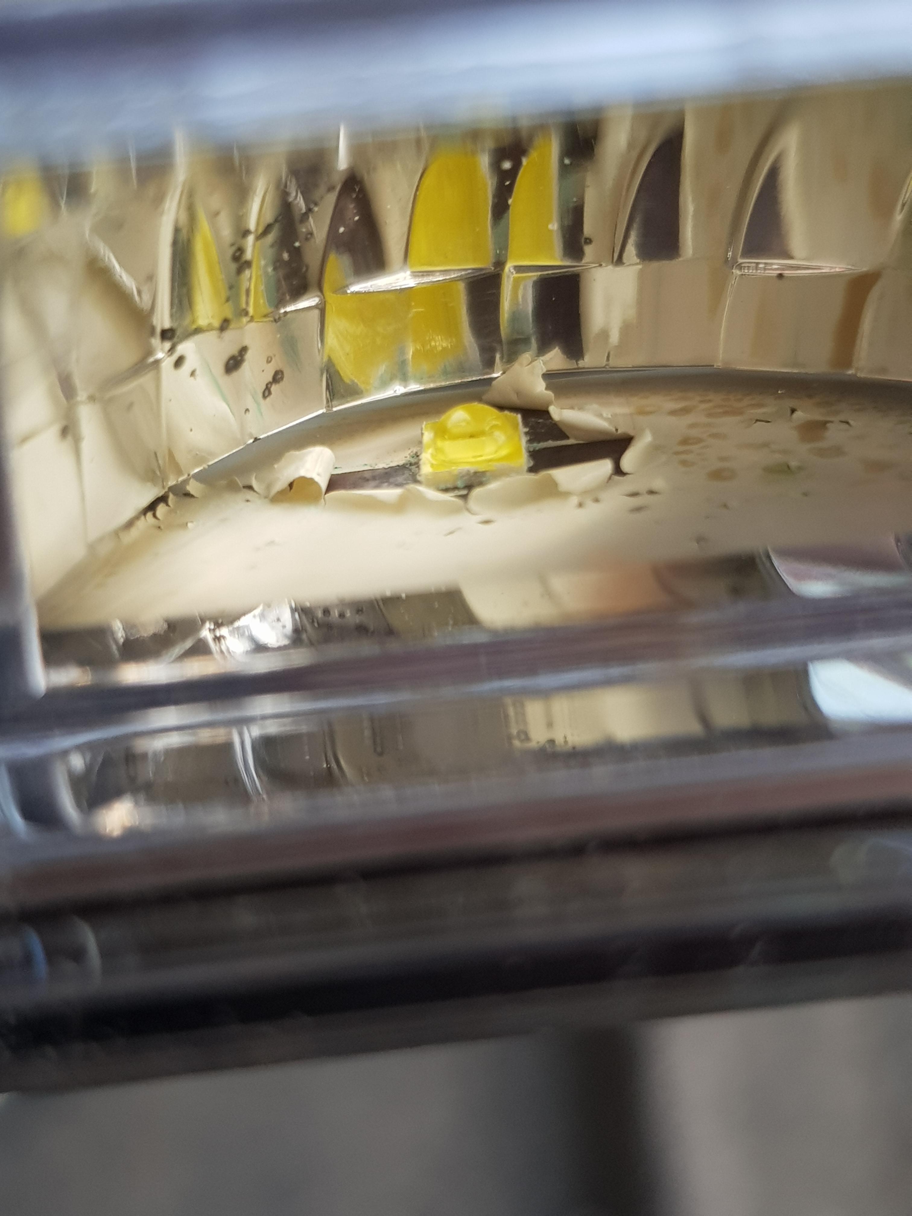

found the problem
GL DRL part number 1648200956 (164 820 09 56) required for left - LEFT AND RIGHT ARE DIFFERENT UNITS
interchangeable with ML DRL part number 1649060351 (left) 1649060451 (right)
always double check part numbers before ordering replacements.

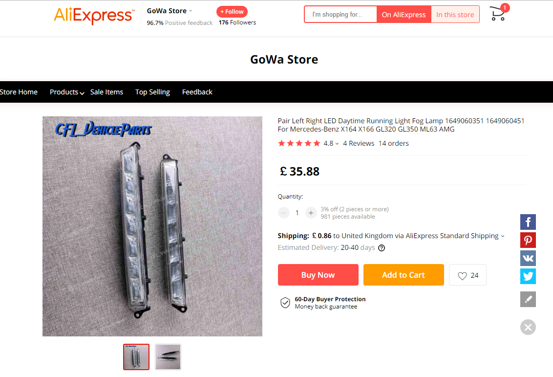

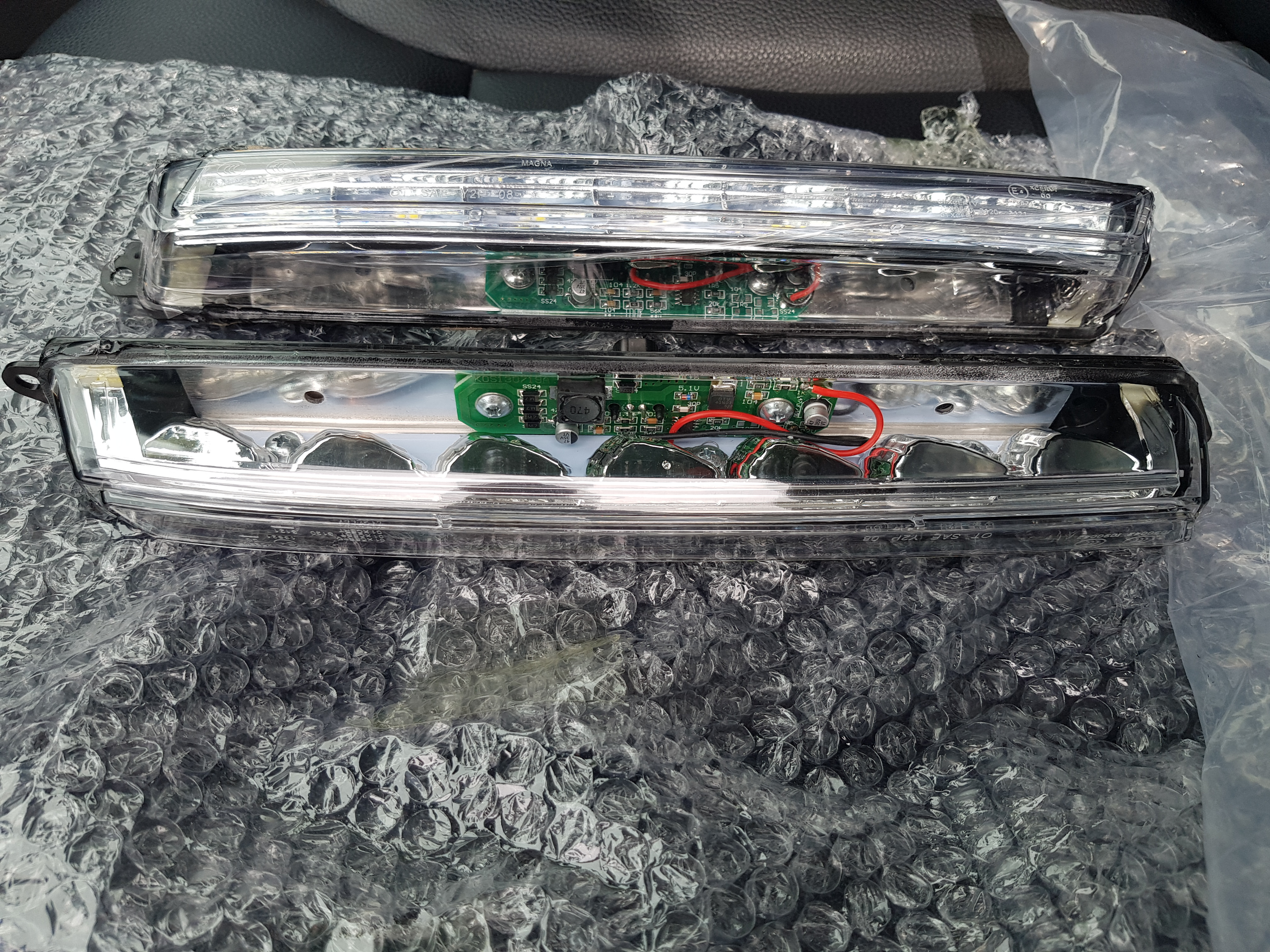

replacement pair direct from china
parts arrived in 2 weeks

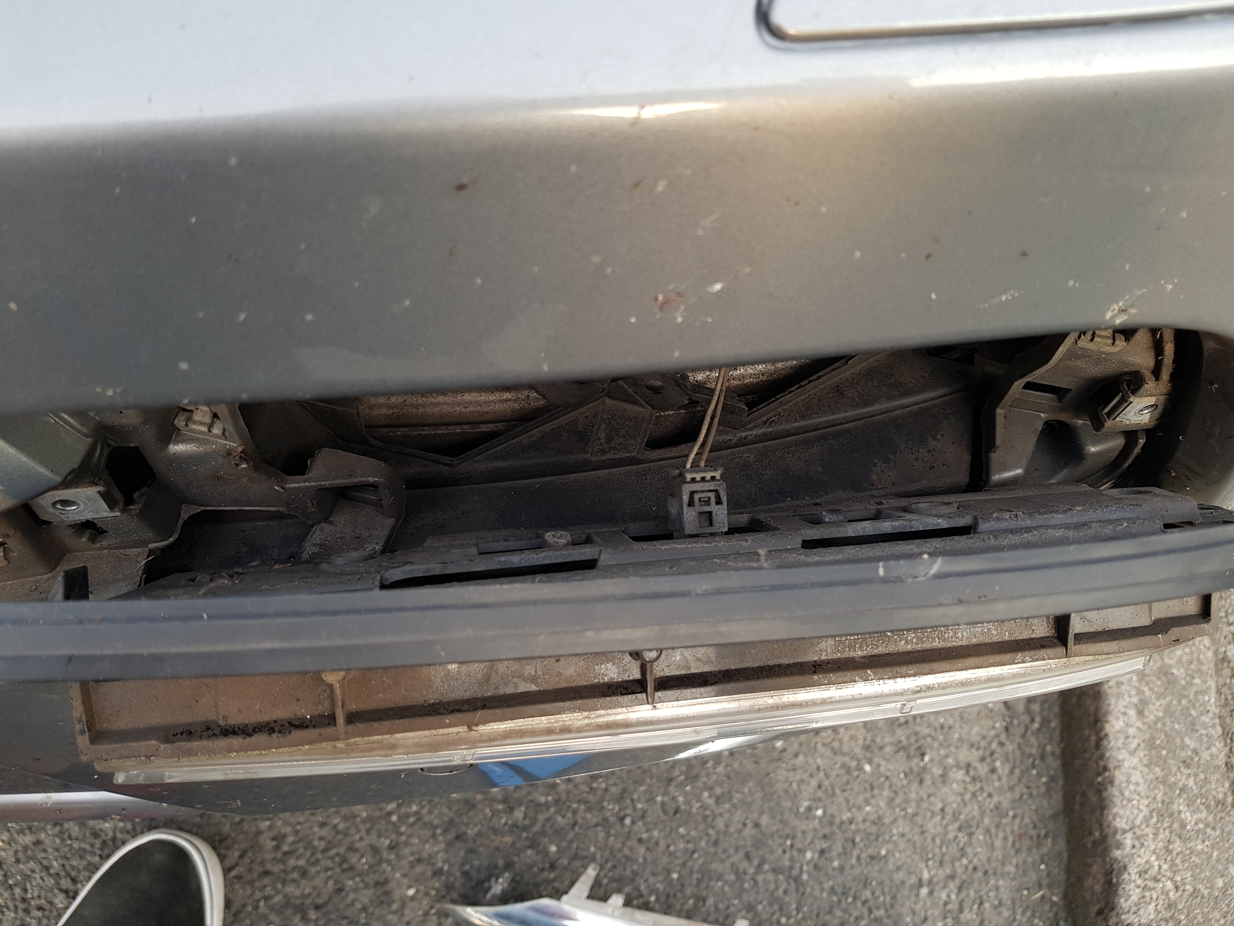

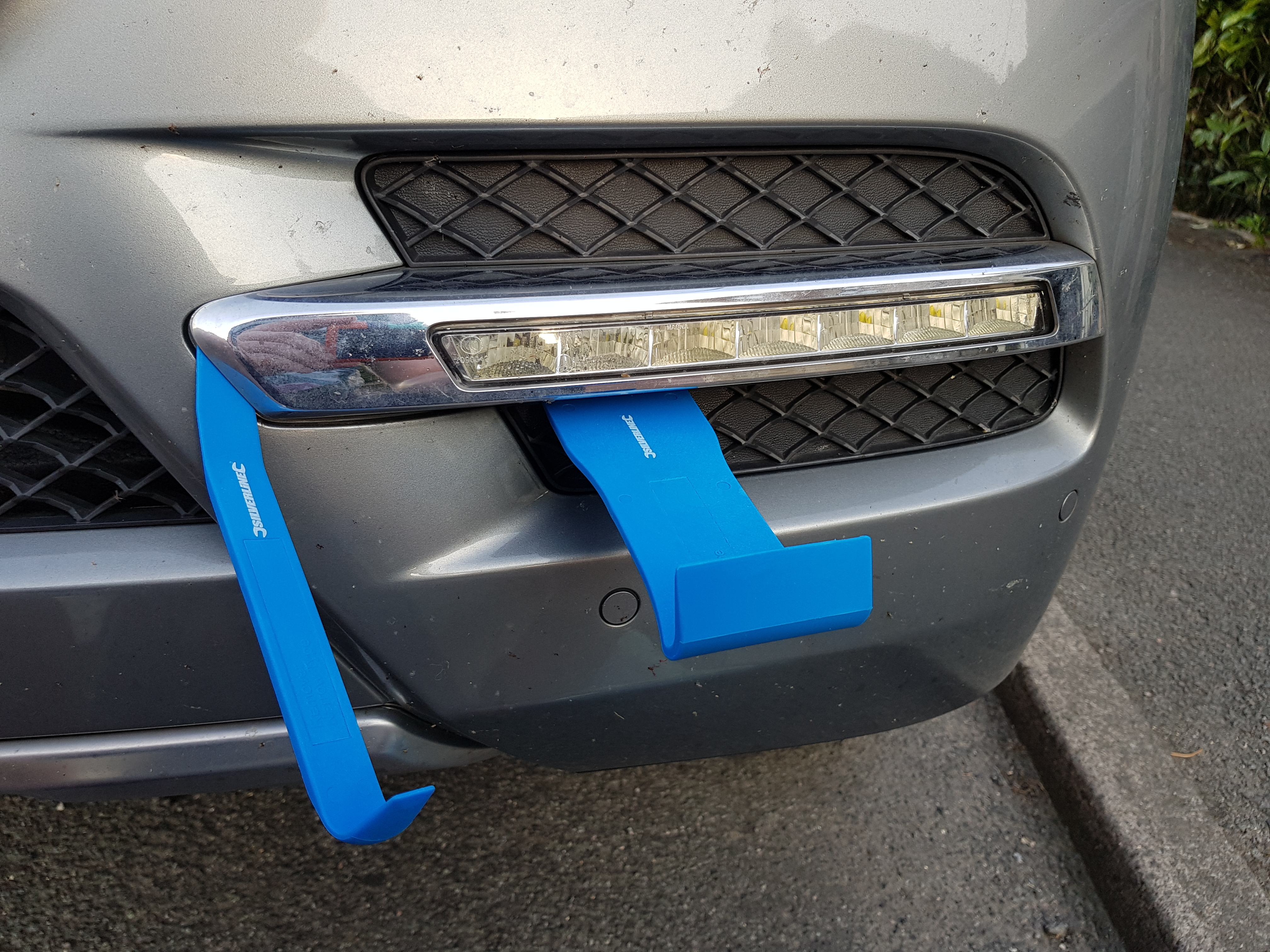

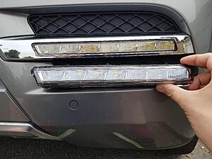

trim removal

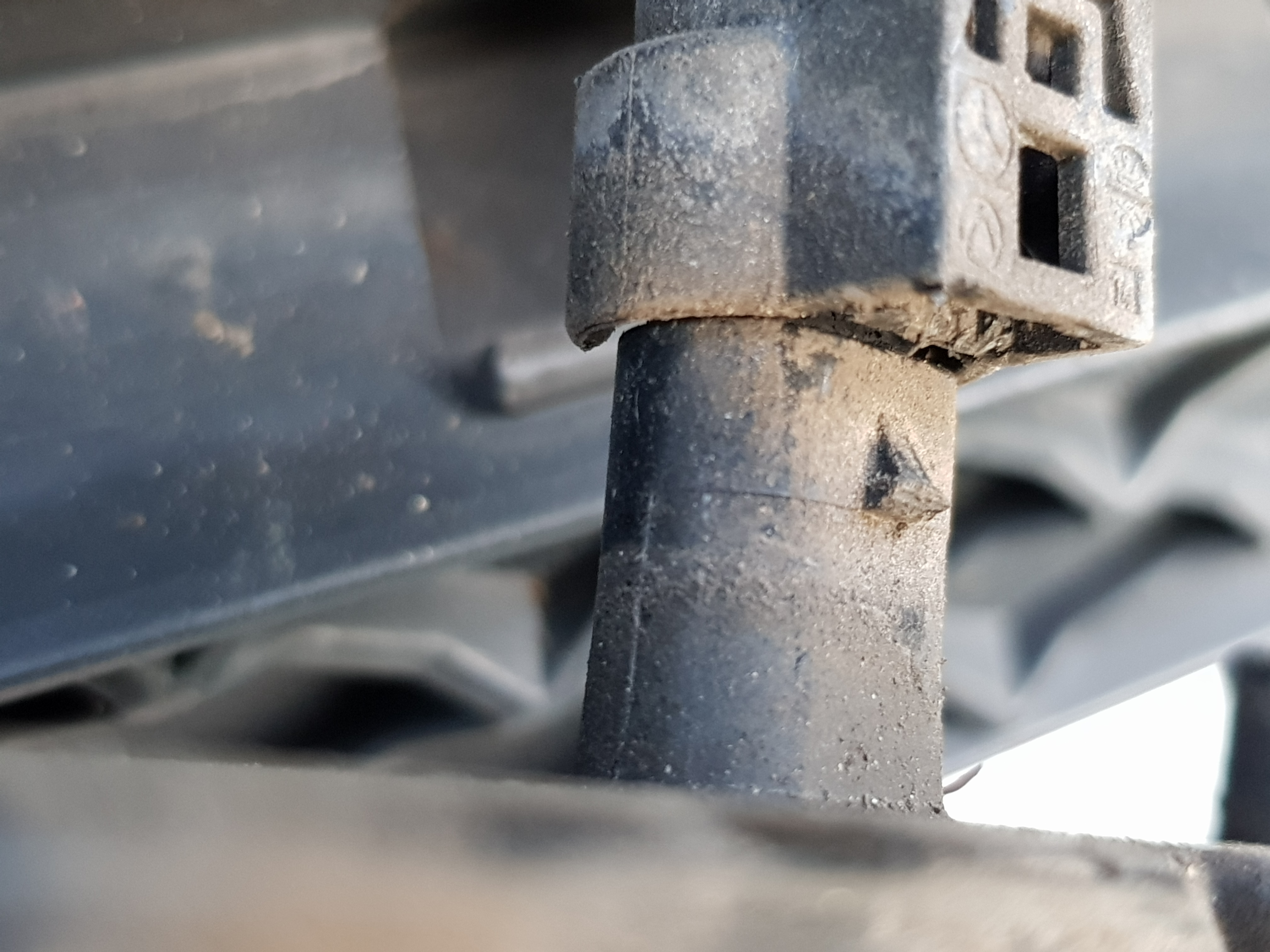

with bottom clips released, pull out and towards the middle of the car

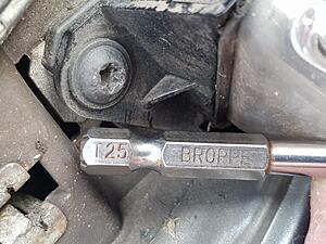

T25 Torx required for retaining srews

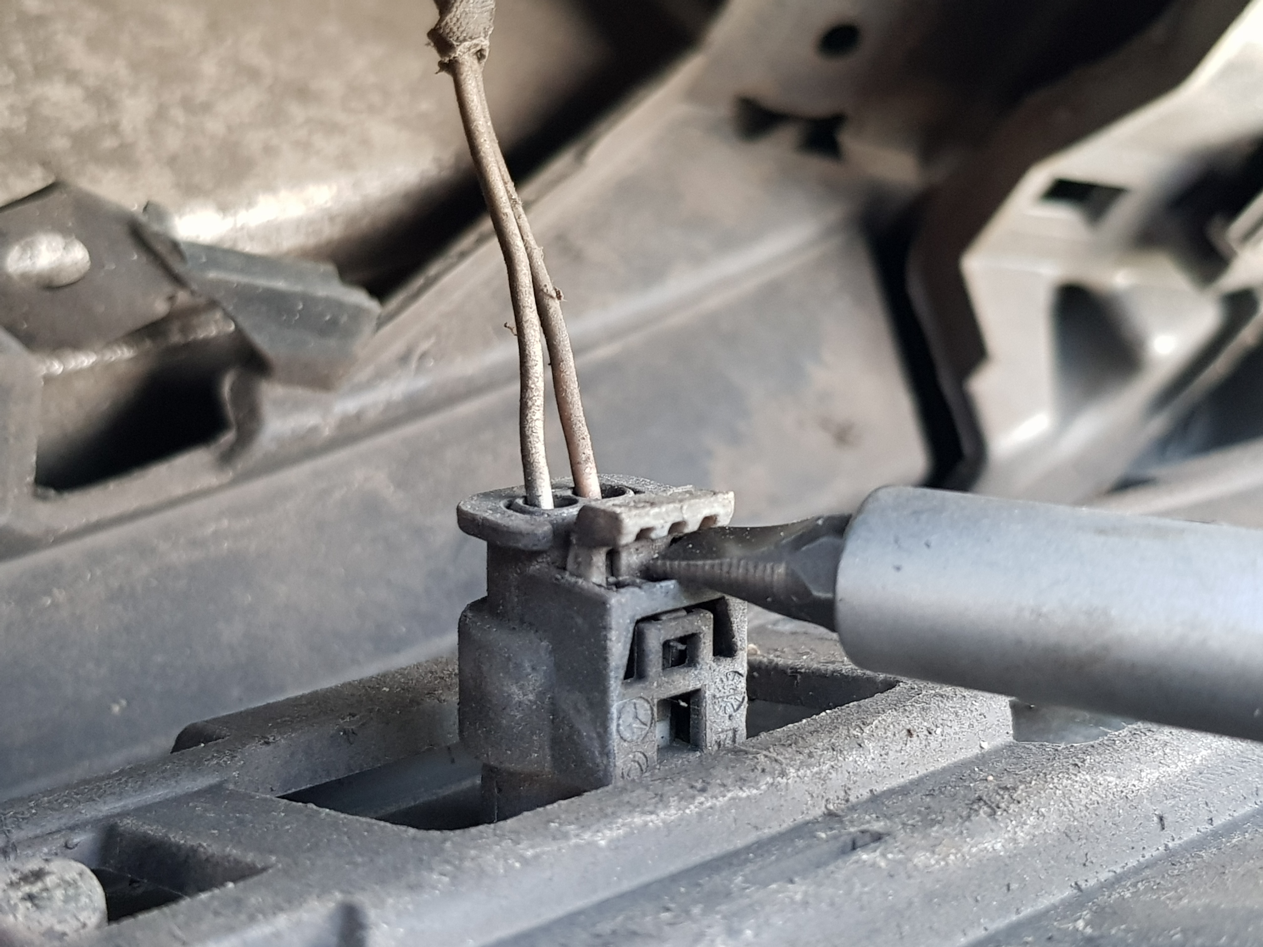

use flat head screwdriver to release the retaining clip on the wiring connector, then just pull connector off

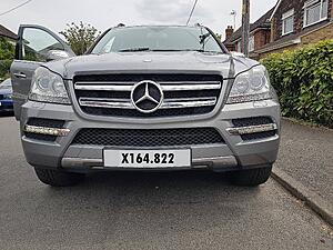

new light fitted by simply reversing steps using new light unit. test before reattaching trim

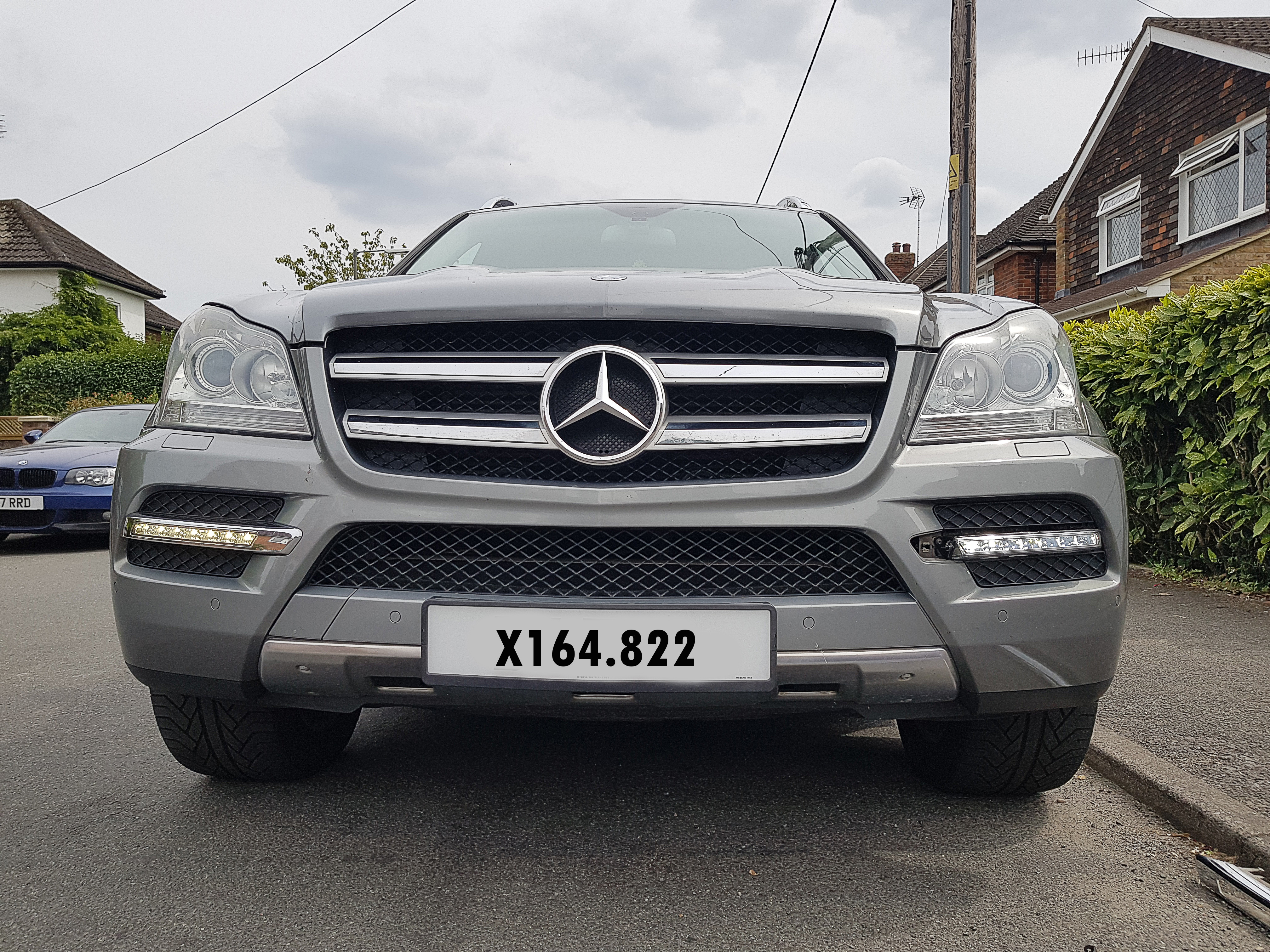

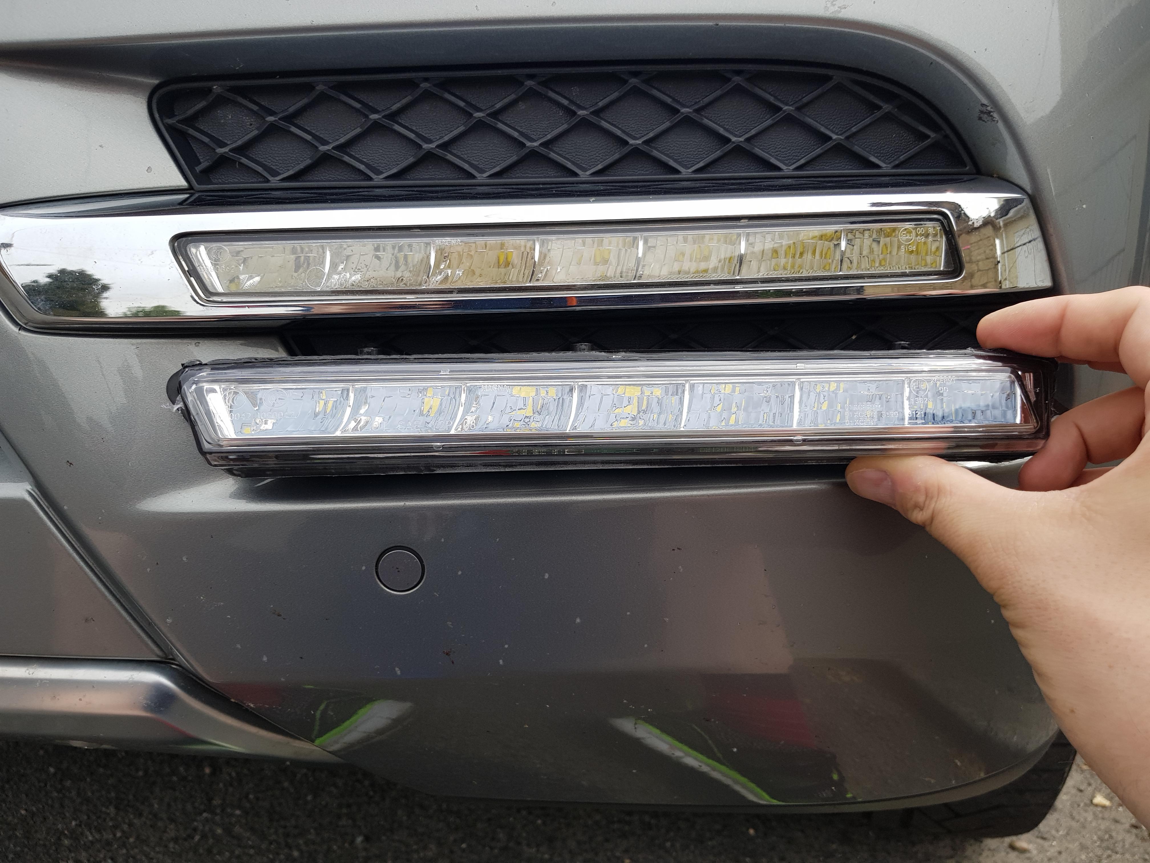

new light is less yellow than original
if you're going to replace one then it's worth replacing both
result is a nice, clean white light and no error on the dashboard.
