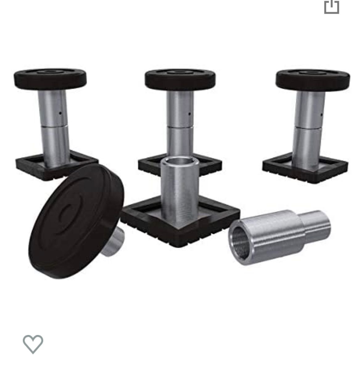

I ended up getting the standard length 7000 lbs. version. It is almost long enough to use side to side (which I didn't realize was an option until I got it), but not quite. The extensions quickjack sells would have worked, but since they're not cheap and I only needed to extend the lift by 1-2" at each end so I just ended up getting two 4 x 6"s long enough to span the car. I lay them on the lift with a rubber block at each lifting point and use them to slightly extend the lift. Works well and gets the vehicle up slightly higher as a bonus. I like the quickjack quite a bit - much easier and seems safer than jacks and jackstands. Try at your own risk etc. etc.

I have 7000 model and I use the lift kit and it work fine in my 10gl. There a jack point under the near the step footboard. No extended rail needed. Waste of money. I been using this for 8yrs now. Next time when I do the rear diff and transfer case I take some pictures
