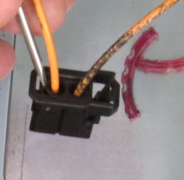

There are also little black tabs that hold each cable end in. Pry those outward to release each cable.

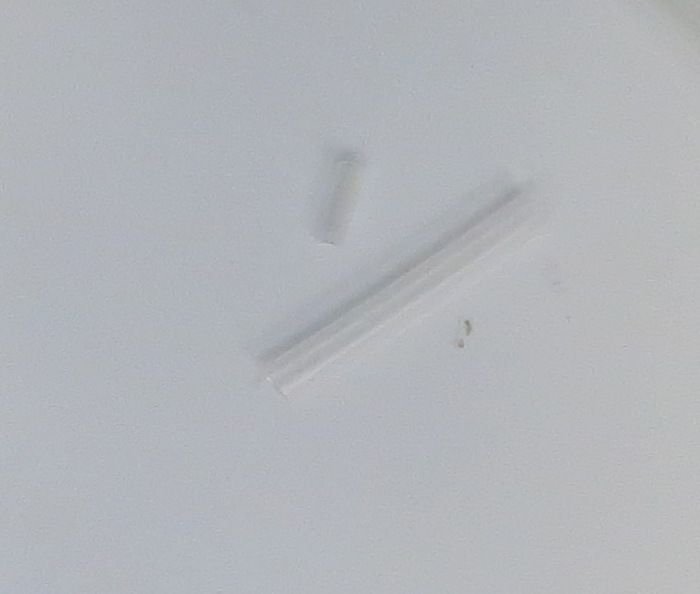

Go get yourself a trigger spray bottle. This is from a smaller bottle, and its dip tube is the perfect size. The dip tube fits snugly over the short cylindrical section at the cable termination. Windex dip tubes probably work too, but they are a little big. I didn't try it. The cable ends just need to be butted up against each other and as close to in line as possible.

Put the little piece of plastic tube on the cable termination tip. The plastic tube needs to be shorter than the sum of the two terminations' straight ends, so it's holding the connection straight and also not preventing the tips from butting together.
