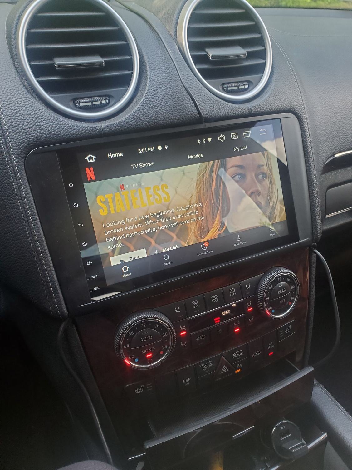

Well I went with the Chinese branded headunit. And so far I'm loving it. Downloaded the Sirius XM Radio, iHeart Radio, Pandora, Netflix, Amazon Video, Tubi, Gas Buddy. YouTube came installed as well as Chrome browser. Basically an Android tablet in your dash.
Install: Fairly plug and play. Had to tap a few wires from the after market harness/adapter to the aftermarket head unit wiring.
Problems: Radio reception (apparently a common issue with these units due to MB complicated antenna setup). I didn't worry about it. I have enough music options. Backup camera. For some reason there are 3 fakra cables. One must be the camera right? I had to buy a fakra to RCA adapter and tried each of the 3 and none seemed to work. I wonder if it doesn't like the fakra to RCI adapter. But there was an Amazon review of a guy who had an ML 550 who specifically mentioned it worked for his Chinese aftermarket unit. I gave up for now, but I want to revisit, backing that thing up without a camera is not going to go well if something small is behind me.
Positives: Capacitive touchscreen. Equalizer really improved the Harmon Kardon sound. I was impressed that all my steering wheel controls continued to work. The head unit will show when a door is open. Speed. I download a custom launcher that looks better. It's smart enough to pause music if a call comes in or if you switch to another music app (basic I know, but I wasn't expecting much form the head unit). I ordered an external mic just in case, but before using it everyone said I sound like any other bluetooth device (there's a small mic built into the front of the unit on the left). So I left it alone. Less wiring for me. The unit also came with a new backup camera but I was definitely not in the mood to run that cable. I'd rather get the current one working.
In the photo you just see me pull up Netflix. The two wires on the side are USB cords to plug devices into the unit. Don't judge my install. I was proud I bothered with doing the install at all.

Glad it worked out. I wish I had done mine years ago - the stock head unit is just horrible. Having Google Maps/Waze/music app/podcast app available on the screen via Android Auto (or Carplay) is a huge improvement over trying to navigate them on the phone. My kids asked me if I installed a new backup camera as well because it looks so much clearer on the new screen.
What year is your GL? If it has Comand 2.0 (pre-2010 I think), the backup camera output is integrated into the wiring harness, and you have to do some splicing to wire in an RCA plug (I posted a link to the details earlier in the thread). There are many pages of discussion on how to get an antenna working in the other threads on Android head units. My 08 seemed to work fine on a brief test with one station with the fakra----> antenna adapter, but I never listen to the radio, so I haven't tested it very thoroughly.
