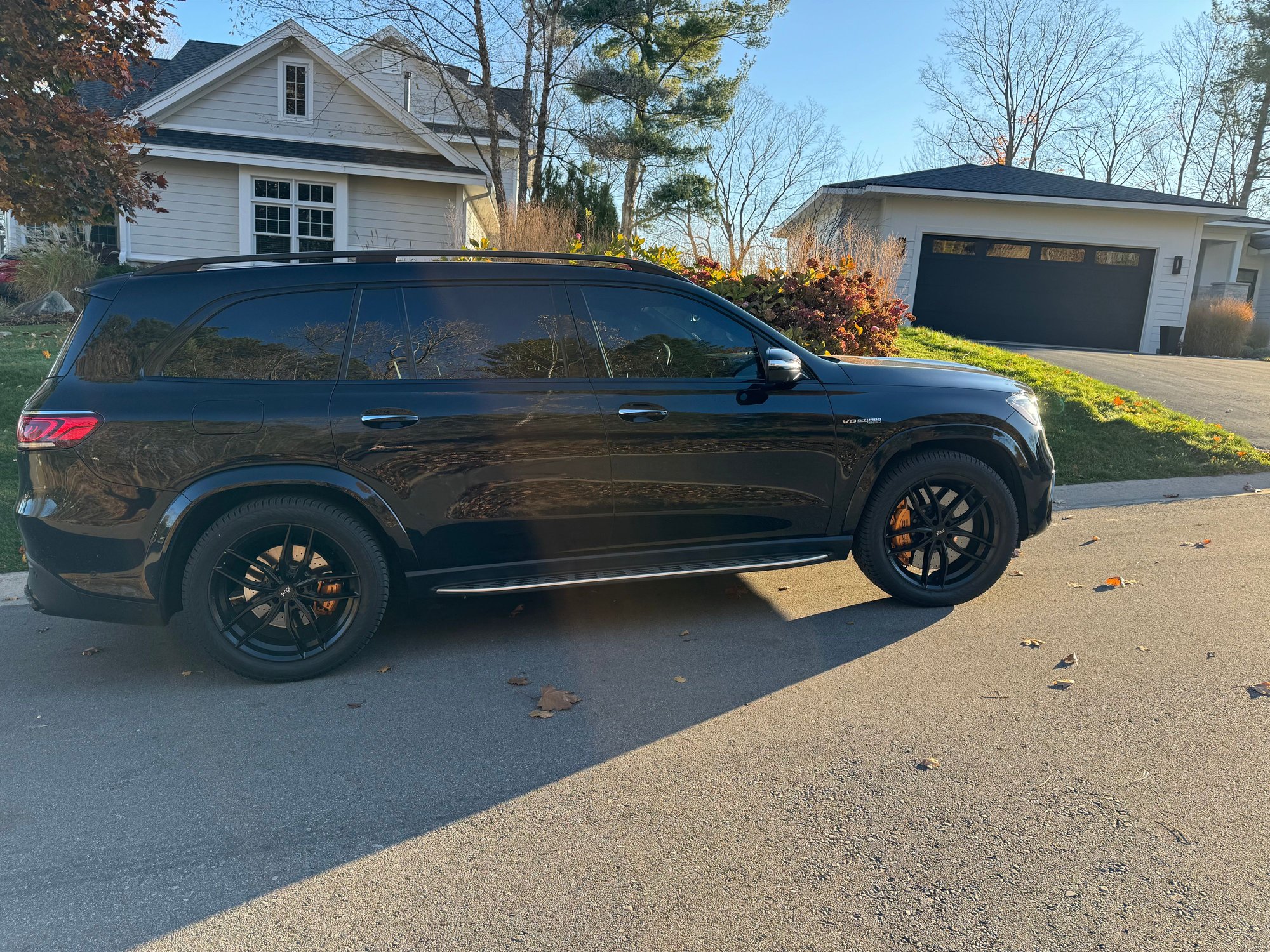

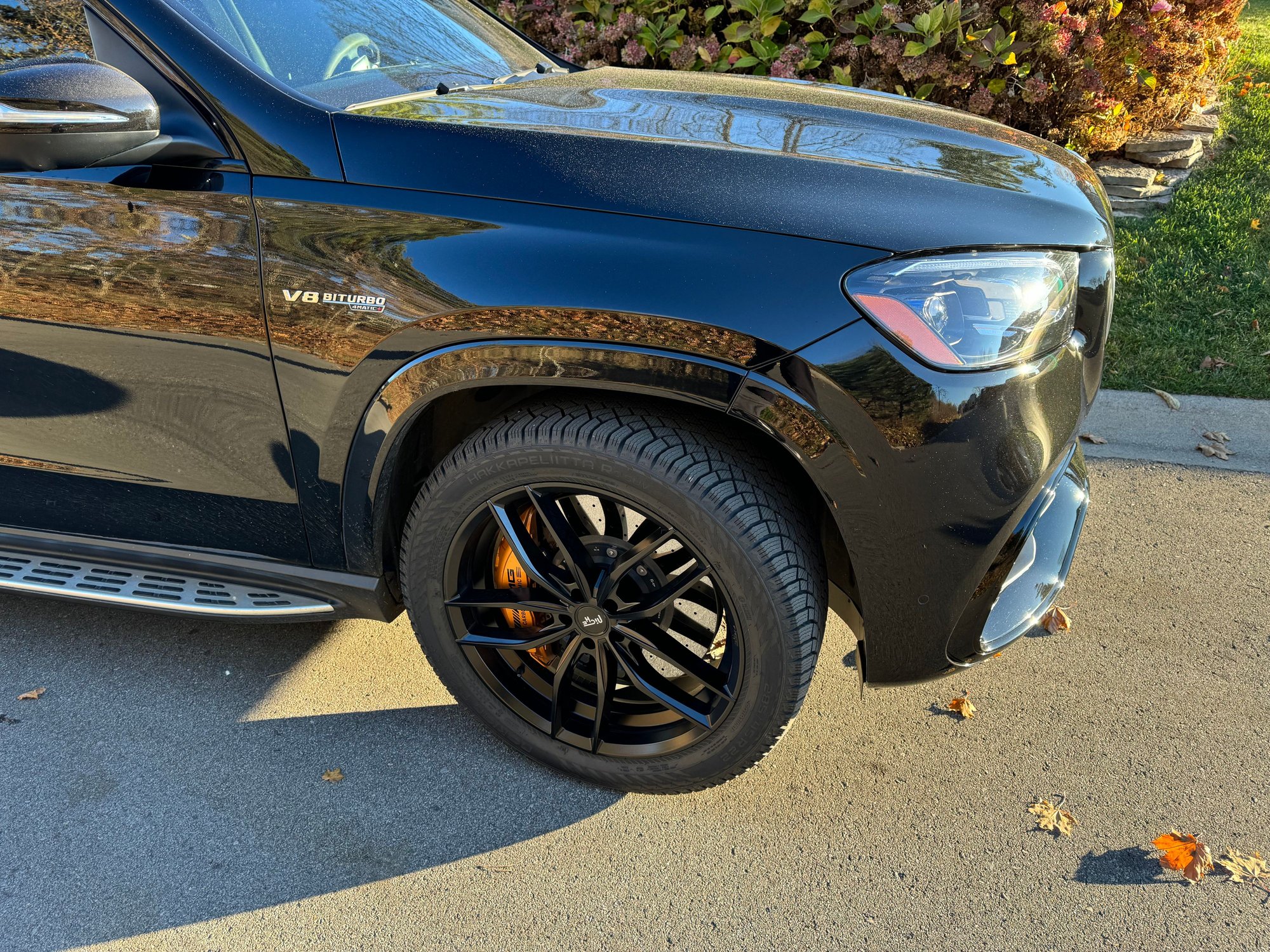

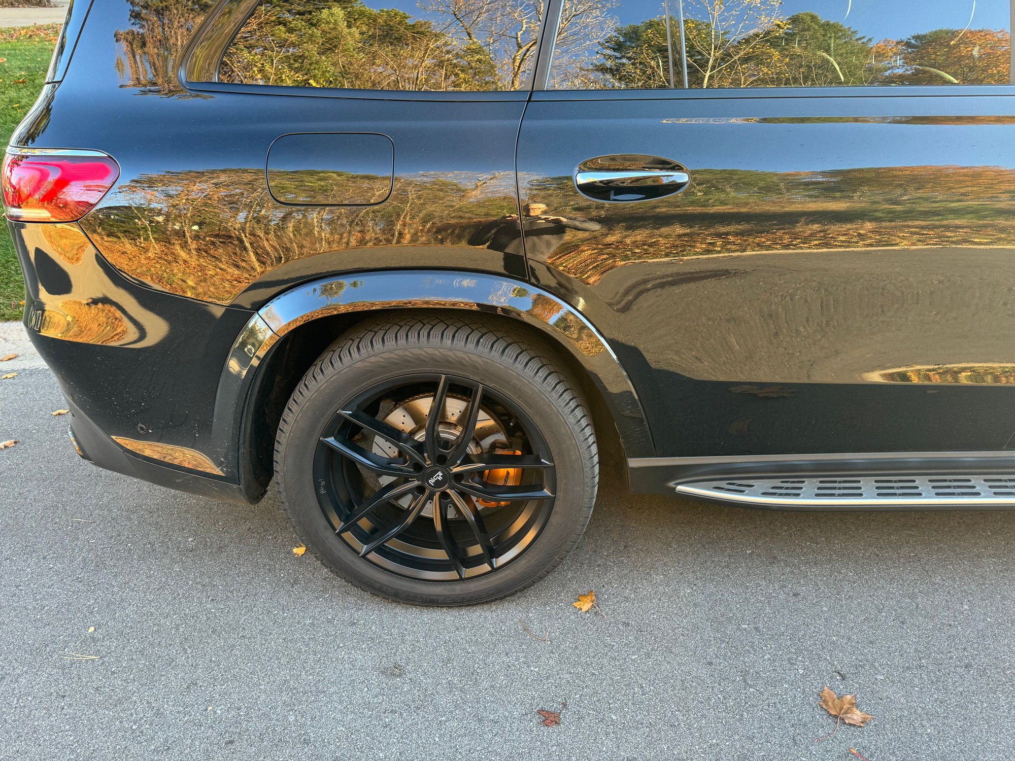

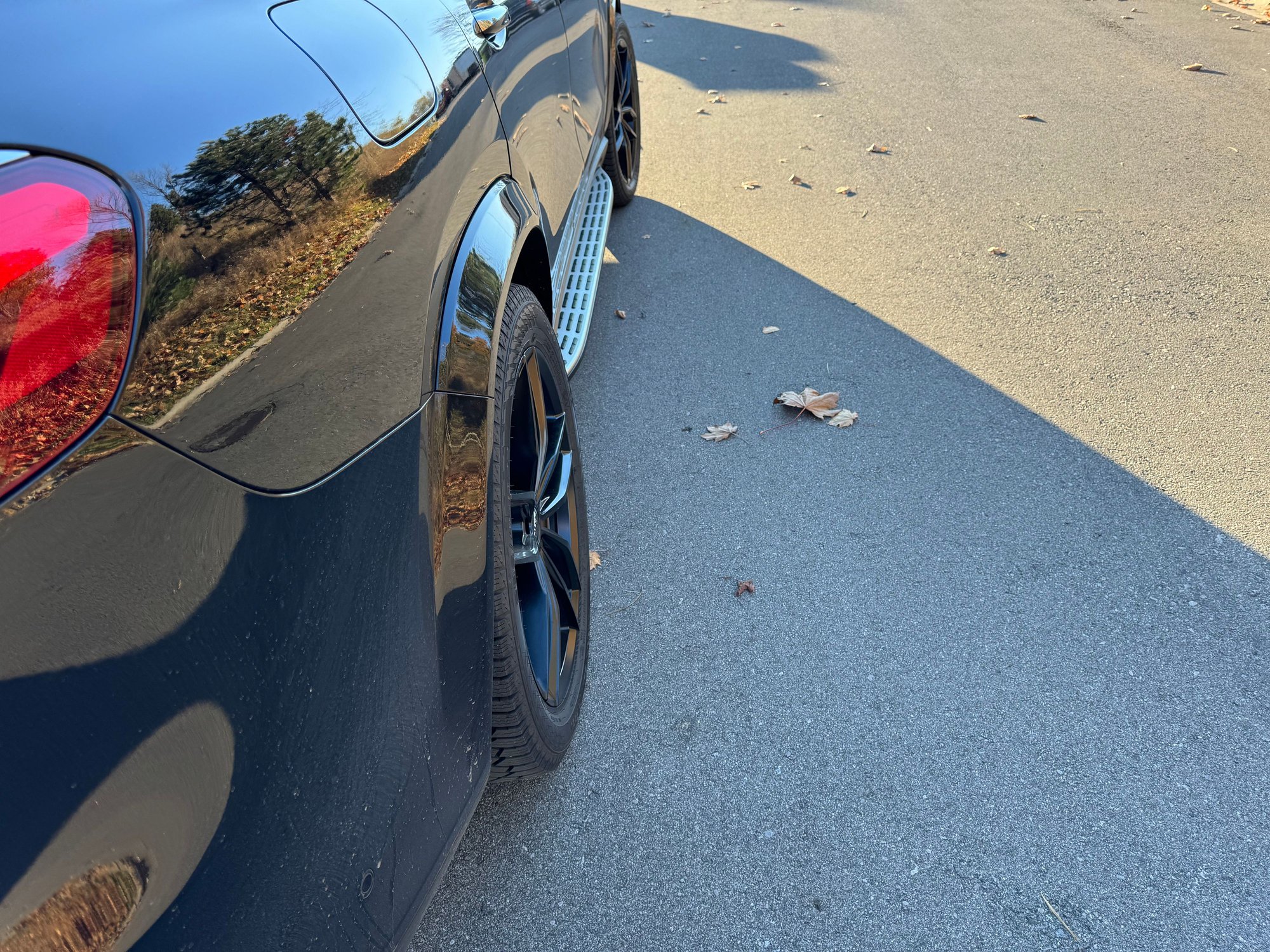

Old Nov 8, 2024 | 09:13 AM
Pkardish33's Avatar
Joined: Apr 2024
Posts: 6
2022 GLS 63
Here are a few pics of the squared
winter setup
