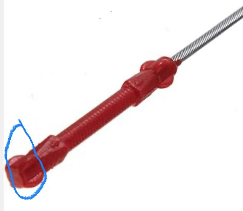

Okay so I checked oil level cold after car sat a day. I always thought all these yrs that full max was the whole plastic piece on MB but now I just learned where min max lines are. Anyways oil level covers the whole Plastic to where I circled so obviously slightly overfilled?
Reading up on this group people say using the drain plug will not remove all oil so whatever it doesn’t remove stayed in there plus 9 quarts. Anyways I’ve always filled my MBs to this over the mark level no warnings no issues.Do these x164 oil sensors actually read overfill??I thought they only sensed low levels?Can anyone confirm?
I really appreciate everyones help.Sorry for all the long posts. It’s just a oil light is not something to ignore.And Its only got 120k now.
looks like I’m gonna just have drive it like this hope it goes away on its own. I started the truck and checked the level and there’s no oil on the stick running so it’s pumping and has pressure.
So It comes down to either a sudden bad sensor just from removing the plug on Pan and such a small disturbance killed sensor or the only other thing wich is what I am really thinking is the issue,the Mann filter wich I purchased from their online store wrong part bad part etc. or something with how he installed it. That’s all it can be.Some People say to put some
oil in there maybe to prime it idk but he didn’t do
That. Maybe that’s just online propaganda.
I’ll pop it off see if it’s soaked. I’m sure it only goes on 1 way I watched him do it. But that will give me peace of mind. btw this Mobile 1 place was a bad idea from the get go. As I waited in line these kids knew nothing about the cars they were touching always jumping 1 car to the other always asking what model what weight oil etc. things that are clearly on the car. And I was going to leave but it was my turn. I knew something was gonna happen when they didn’t even have the socket for MB filter I had to give them mine and this is a Mobile shop.
Thanks to everyone who responded.
It’s filled to the tip end

If it is only filled to the area you have circled, you need about a quart and a half additional oil. Overfill message is completely different. It literally says you have too much oil.

https://cimg7.ibsrv.net/gimg/www.mbw...1036adaac.jpeg
That is not enough, get it to the middle of the min and max line at least.

Unless you're in Australia, you actually have it backwards. The "tip" end is the (or near, anyways) LOW end of the range of where oil should be.
Think about how it gets inserted - the tip end would be closer to the bottom of the oil pan.
Put another quart of oil in there.

Yeah, your level sensor is correct
You need to put it at least another liter of oil in there and remeasure. Should be to the top of the indent.
that being said you’re not doing any damage by running a quart and a half low you still have like 7 1/2 L of oil in there which is twice a normal car engine.

you have circled the MIN, not the MAX.Max is at the other end of the indented area.

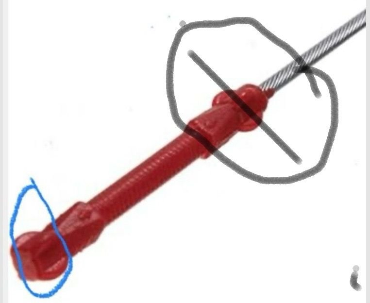

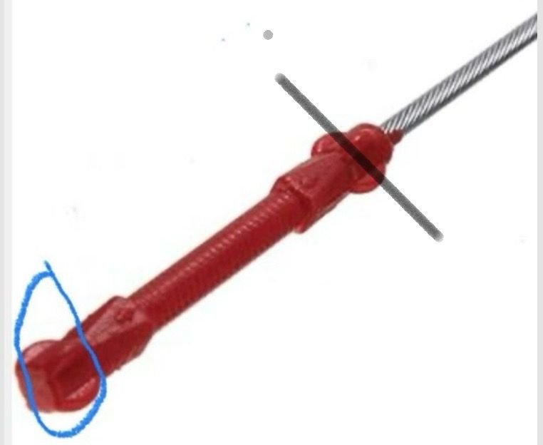

I’m still having this issue. Warning pops on always after only few minutes after driving but does not come on when car is parked warming up after a cold start even if it’s 15-20 min warming up on a hot day.This has to point to the culprit. You must drive for it to trigger low oil light.
Anyways mistake I made in orig post is oil level is not at blue circle it’s at black circle max Level and even slightly above that.
But these trucks don’t have a too much oil sensor. So I doubt extra oil is causing it?The truck got what the factory and this forum call for 9 quarts. The extra oil must be what didn’t drain out from oil pan.According to the stick,it covering the whole red area it’s atleast 1/2-1 quart over filled.

Originally Posted by USNAVY
If anyone is still around
You need to check the oil at operating temperature. Get it to 85 degrees C, and then check the oil. Then fill it.
It will appear higher after sitting. It needs to read in range at operating temp, a lot gets in the valve cover.
