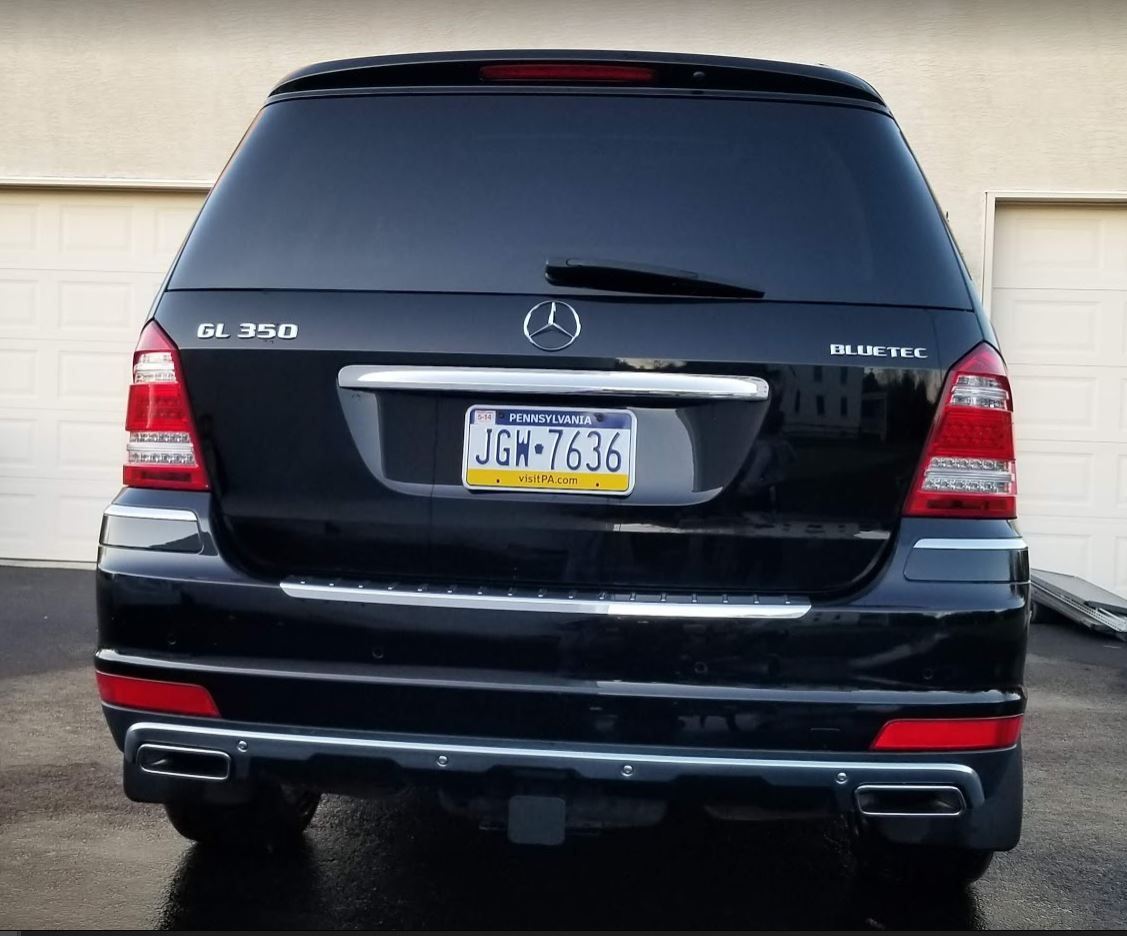

Before....in Pennsylvania

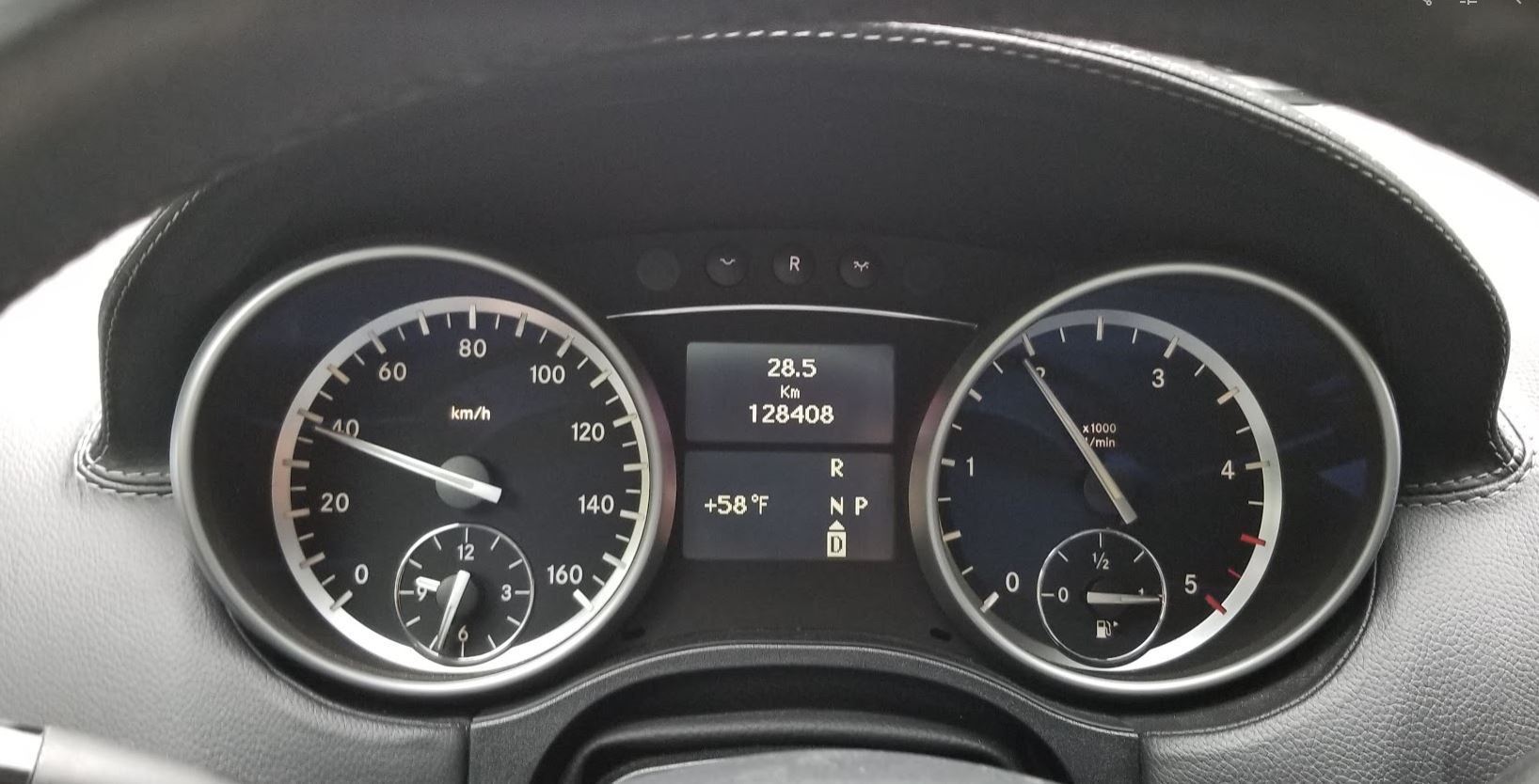

4. Get the car inspected. At this point, I had three months to get the car inspected. Ha, piece of cake I thought. Well...not so fast. When I got the car home from the port, I used my Autel tool to switch the instrument cluster display from MPH to KPH. I wasn't 100% sure that I would be able to do this, and my back up plan was just to use the center display, which you can use by toggling the settings. But in the end, I was able to reprogram the car and the little 'mph' in the middle of the speedometer now reads km/h and the speedometer, odometer, and other functions use metric units. I had read several places that this was not possible for US vehicles, but it is. You'll note that the speedometer only goes up to 160 km/h which is 100 mph, but the speed limits here are so low that won't be a problem. Incidently, the one unintended change that resulted was that my daytime running lights no longer light up (even though they are set to do so) but after messing with it for a couple hours, I've temporarily given up on them and not worrying about it. I can just run the headlights during the day until I get it figured out. Oh, one last thing; you need a warning triangle in your trunk. I got three for $15 off eBay.

Also decided to take a photo of the instrument cluster area, so you can see what it's like after coding the vehicle to use Km/h on the original speedometer. This would work fine everywhere except Germany I guess. The highest speed limit in Finland is 120 kph so it's no issue here.
