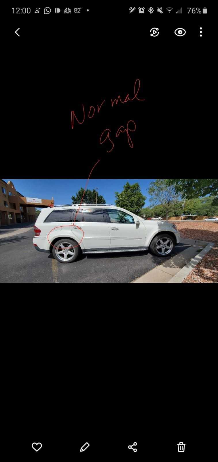

hard to see, but car is lower on drivers side, so appears sinking down on left side
this is where the problem is. all other tires i can put 5 fingers between wheel and fender. when this one lowers, i can only put in 2 fingers
this is the normal passenger side.

Airbag is leaking to replace the bag. There is a small chance it is the hose that feeds the bag. But almost 90% of the time it's a bad bag. It will get progressively worst. And your air compressor can die constantly trying to keep up with the leaking bag..

If you hear a hissing, and your trusted mechanic cannot find a problem with the airbag, then it is most definitely the air line.
The rear air line runs from your airbag and into the spare tire well (under the carpet) where it joins with the other side and feeds from the air tank which externally under the spare tire.
Once again, if you can HEAR the hissing from outside the vehicle, I suggest you inspect the air line from the rear air bag to just before it enters the cabin - - this is likely to be your source of air loss. Move it around a little bit, bending it ever so slightly, to see if you can pinpoint the leak. If the line is damaged, then you can choose to replace the air line, or get one of these bad boys and repair it at the fracture point:
Air Line Hose Repair Straight Union Connector Air Line Hose Repair Straight Union Connector
On a 1 to 10 DIY scale, this is a 1 (super easy) -- you cut the hose where it is leaking, then connect both ends to the coupler..... done.
Your local MB dealer will try to sell you a brass coupler for about US$100...
Mine had a fracture that grew wider (circumference wise) with time and the hissing became more pronounced. I had replaced the airbag twice (Arnott lifetime warranty), but the problem had persisted.. then I found the leak in the line so I bought the coupler. Problem solved.
