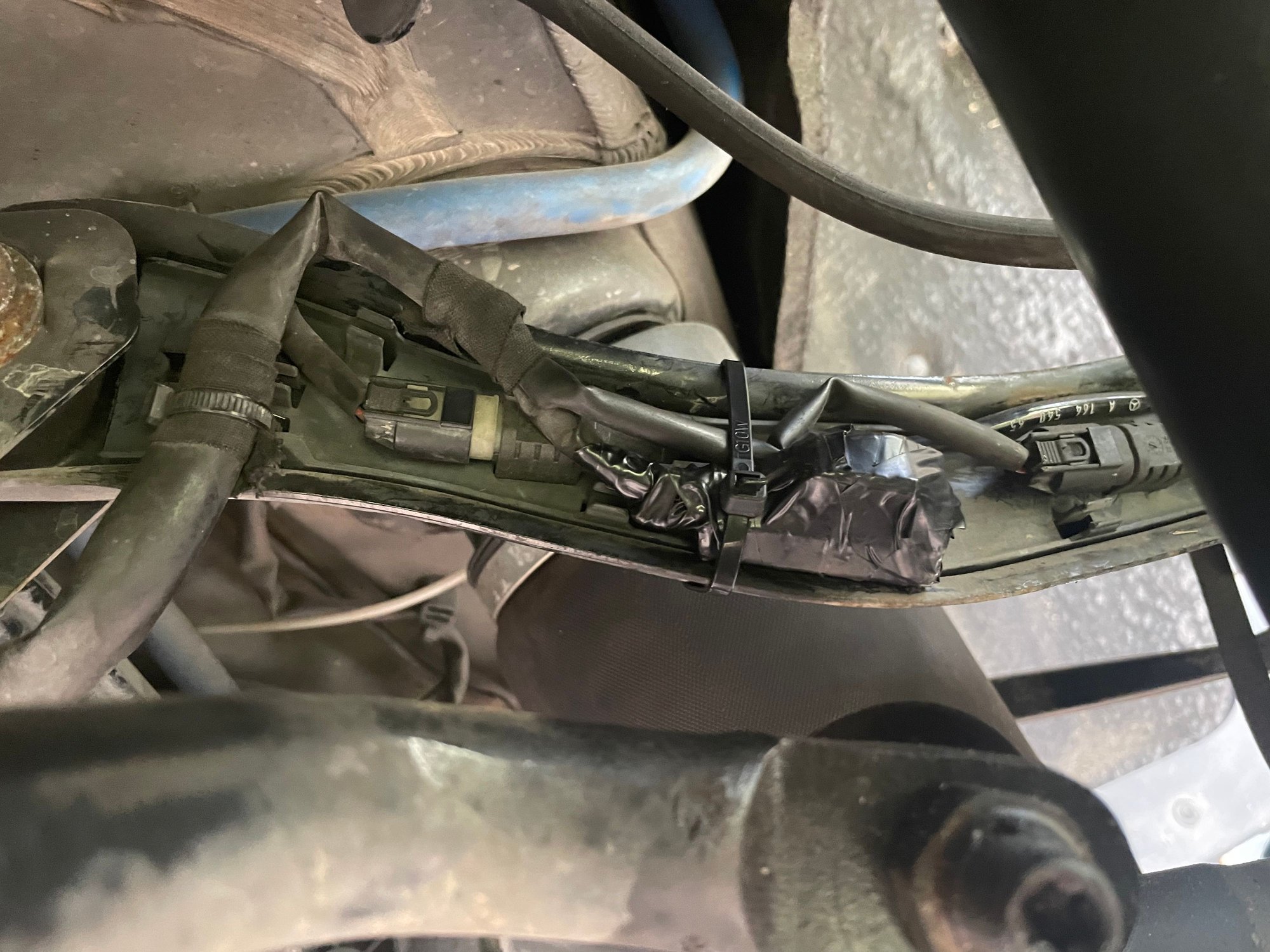

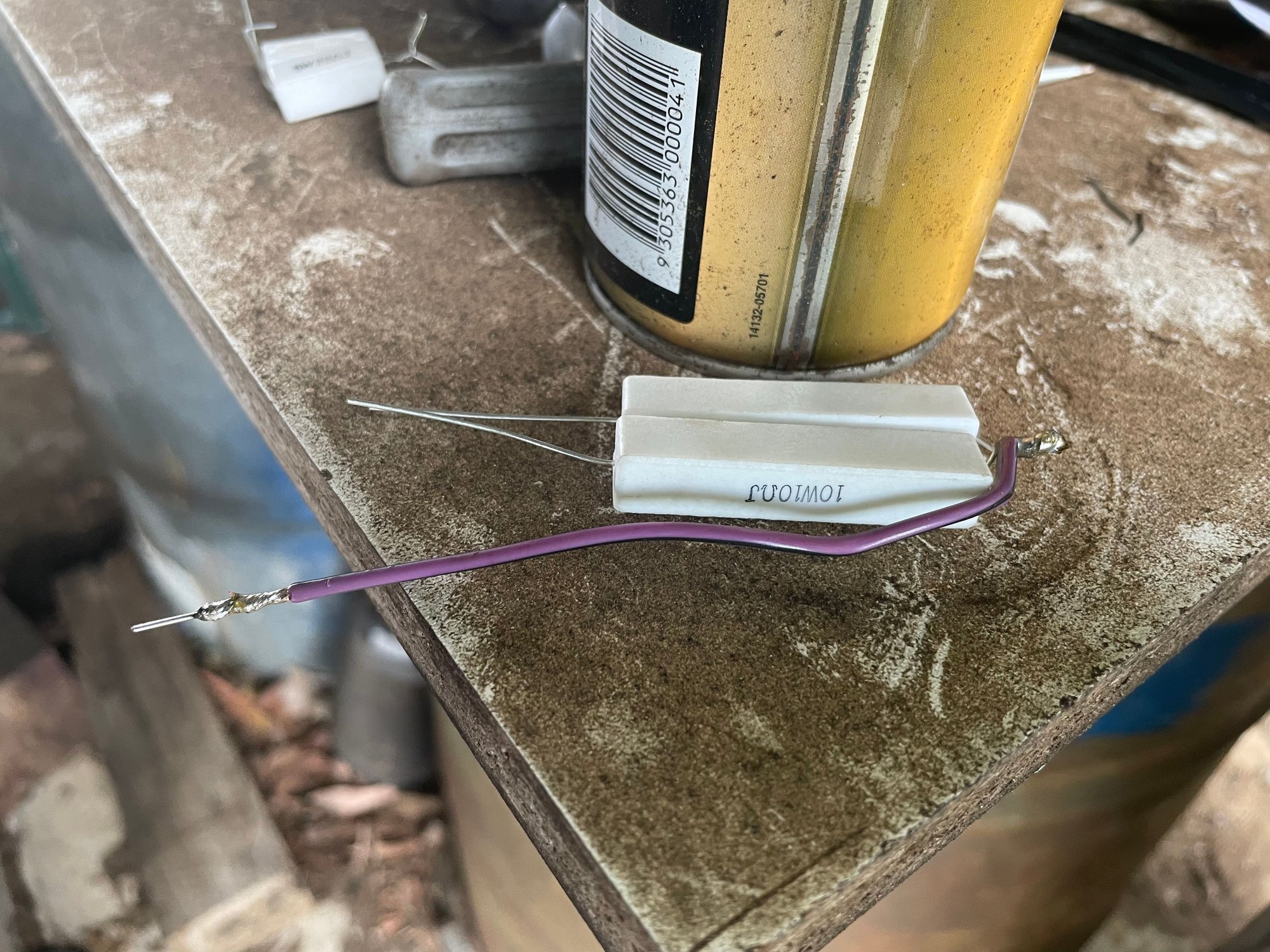

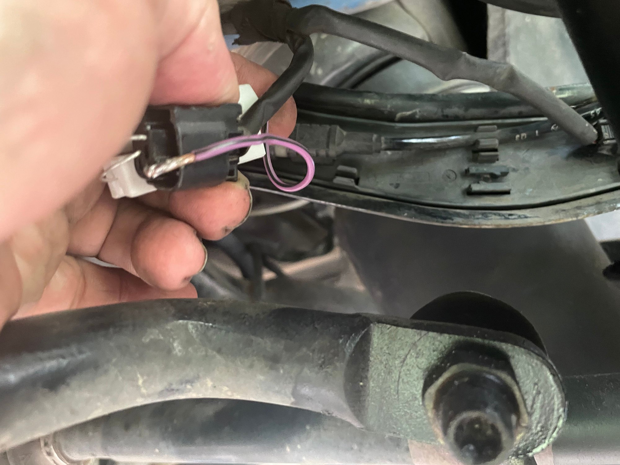

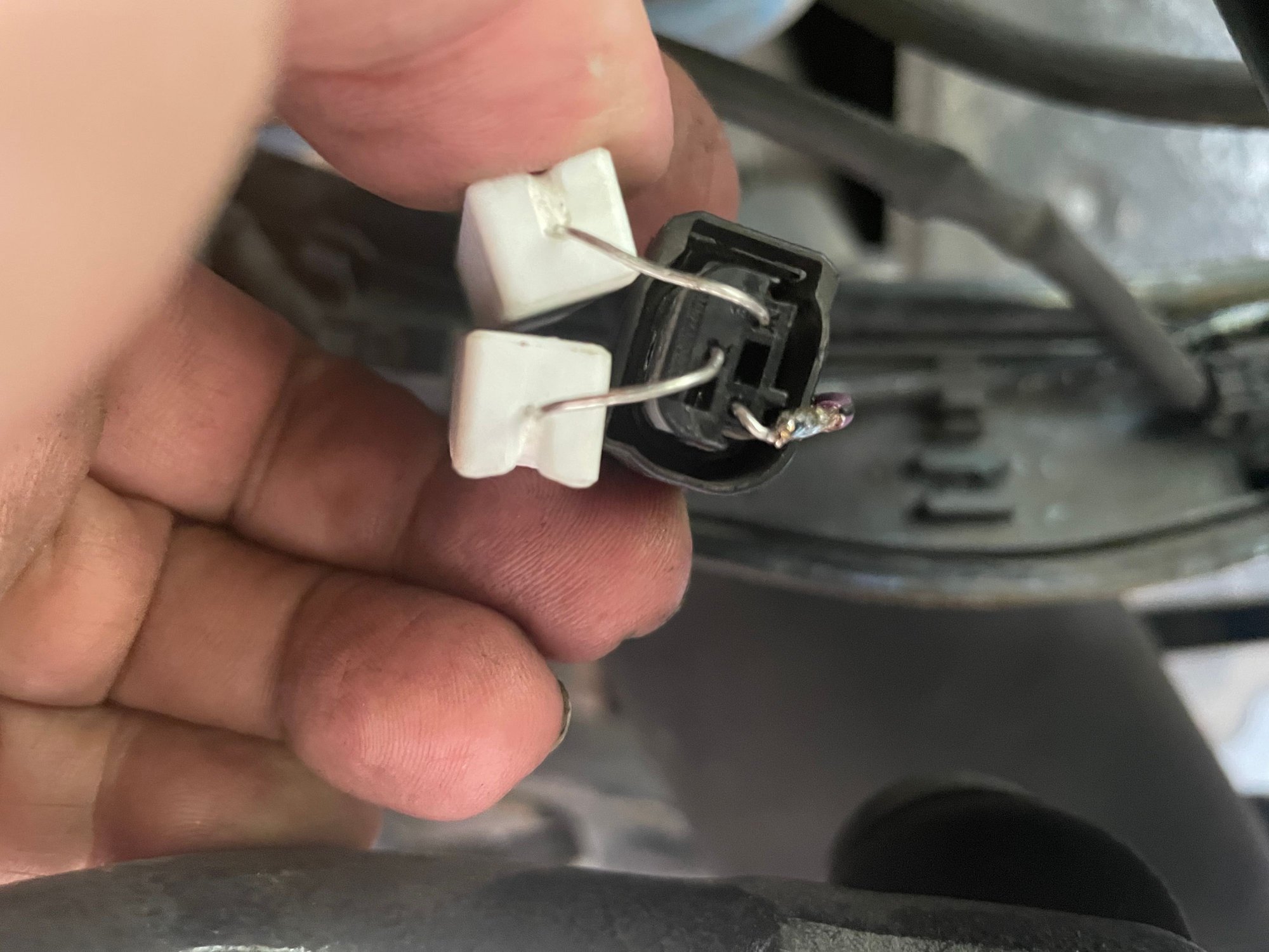

I got sidetracked till last week. A few days ago got back into it the second photo is out of order. Final stage. All wrapped up in insulation tape. Taking care to separate the conductors
Resistor pack. 2 of 10 ohm 10 watt
Wrong order. Finally
Resistors tail ends in socket. Wire is from other end of resistors (joined). I just soldered the tail offcut onto end of wire as it seemed good fit to socket. Had to grasp the tail with needle nose pliers a mill at a time to push into socket or the tail buckled

At this stage still a work in progress. The resistors seem to work fine if you leave it in “sport” setting
if you come out of sport shortly later get an error which is for valve 1. One time left. Next time right.
might try 2/22ohm resistors in parallel for each valve (as previous). And see how i go
