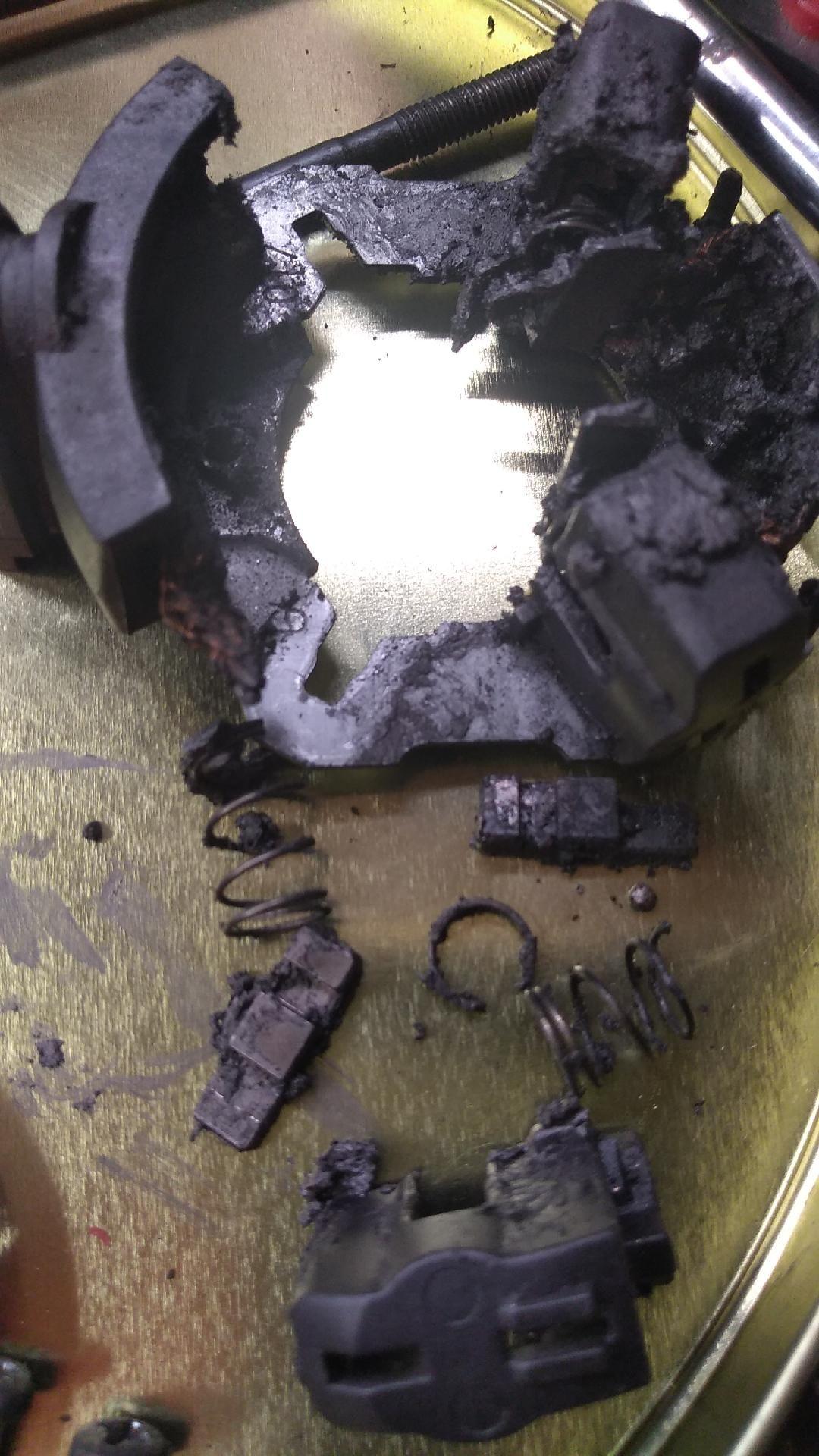

I removed the starter yesterday. no brainer really, takes about 1.5 - 2 hrs
Was kinda hard to remove a heatshield and a "+" cable because of limited space.
Took it apart and found two out of four brush wires fell off.
brushes themselves almost gone!
can not believe it happened on a vehicle with only 150K kms!
on a top one of the springs fell apart so two brushes didn't make contact at all.
I'm going to order a new one: it's $125 on Amazon.
PS. The black crap You see here is not dirt, it's a graphite grease. and there's a lot of it!
PS again. i read the post You recommended and apparently procedure on gl450 is different from GL350.
my heatshield is held by the bolt on top of engine mount and to gain access to it i jacked up the right suspension to make a larger opening
also I removed the large heat shield from inner fender liner, probably could've done w/out it but it certainly made my life easier.
