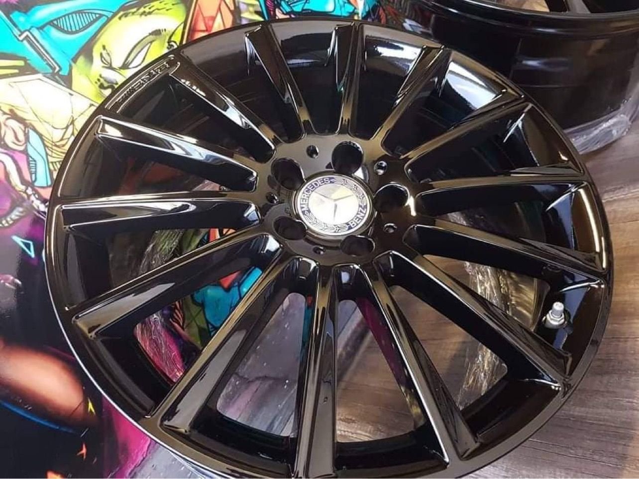

I've seen those on Alibaba.

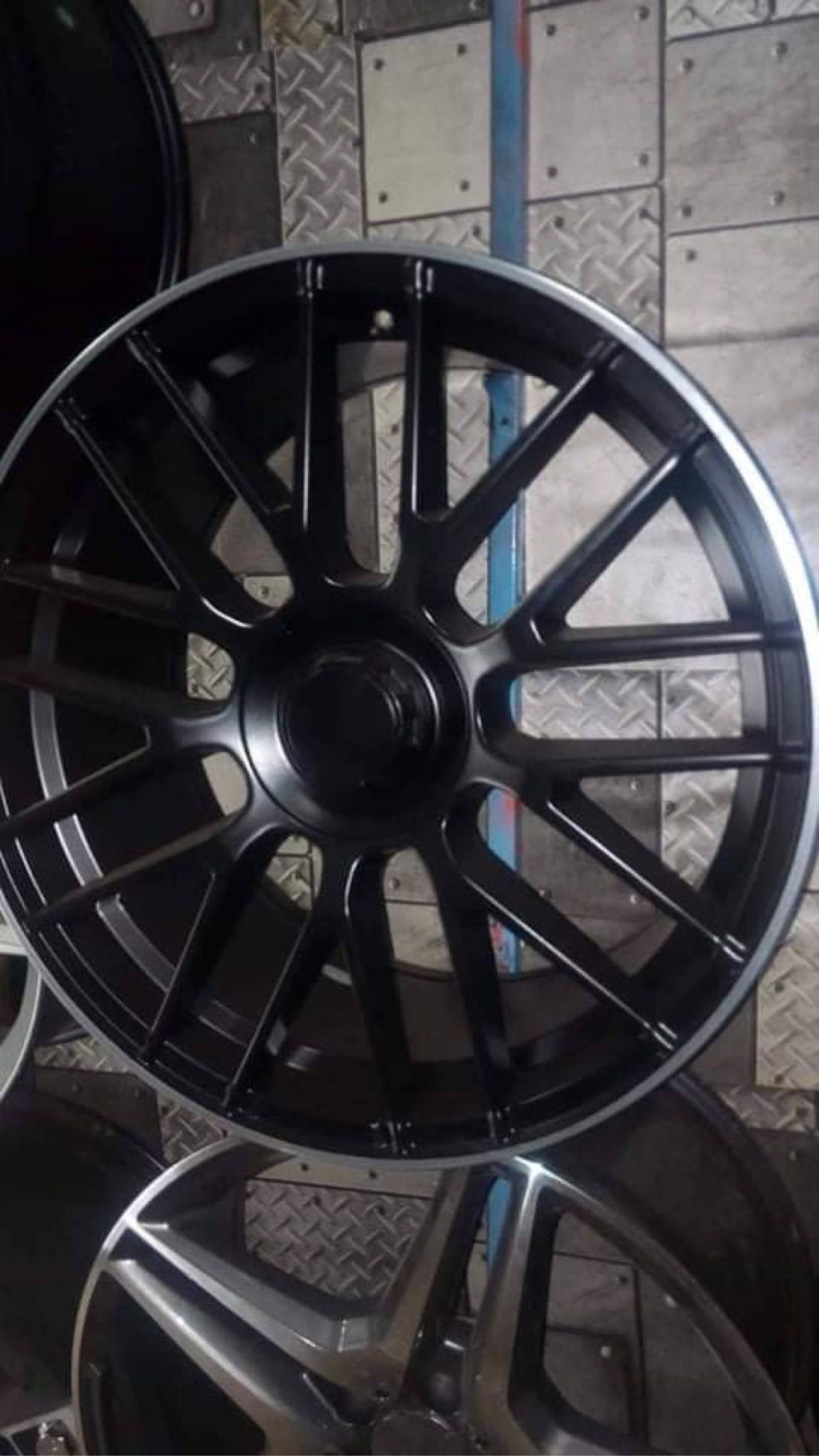

This has an offset of 42 and a bolt pattern of 5 x 130. if I get a wheel adapter will these work?
You will need to take into account the thickness of the adapters to calculate your actual offset. I'm not 100% sure how thin an adapter can be, but let's say that the thinnest you can buy is 20mm. The wheels have offset ET+42. New offset with adapters will be ET+22 (you have to subtract the adapter's thickness from the offset). The lower the number in the offset, the farther the wheels outside of the wheel well. This will make the wheels poke quite a lot from your wheel well. Even if you have the 550 or the AMG appearance package on a 350 or 450 which has fender flares (I don't think you were a fan of those flares), those wheels will be poking out of the wheel well. ET+42 is already high for the GL. Keep in mind that most OE wheels will be in the ET+50/60 range. Exceptions are AMG wheels which are in the high 30s (ET+37 for the 21 " wheels which were standard on the X164 AMG appearance package) to low 40s (I have seen AMG 20" wheels with ET+41 for 20 from a W166). So to get a wheel to sit relatively flush with your fender you need something around ET+70. I'm not sure these exist unless you were to custom order.

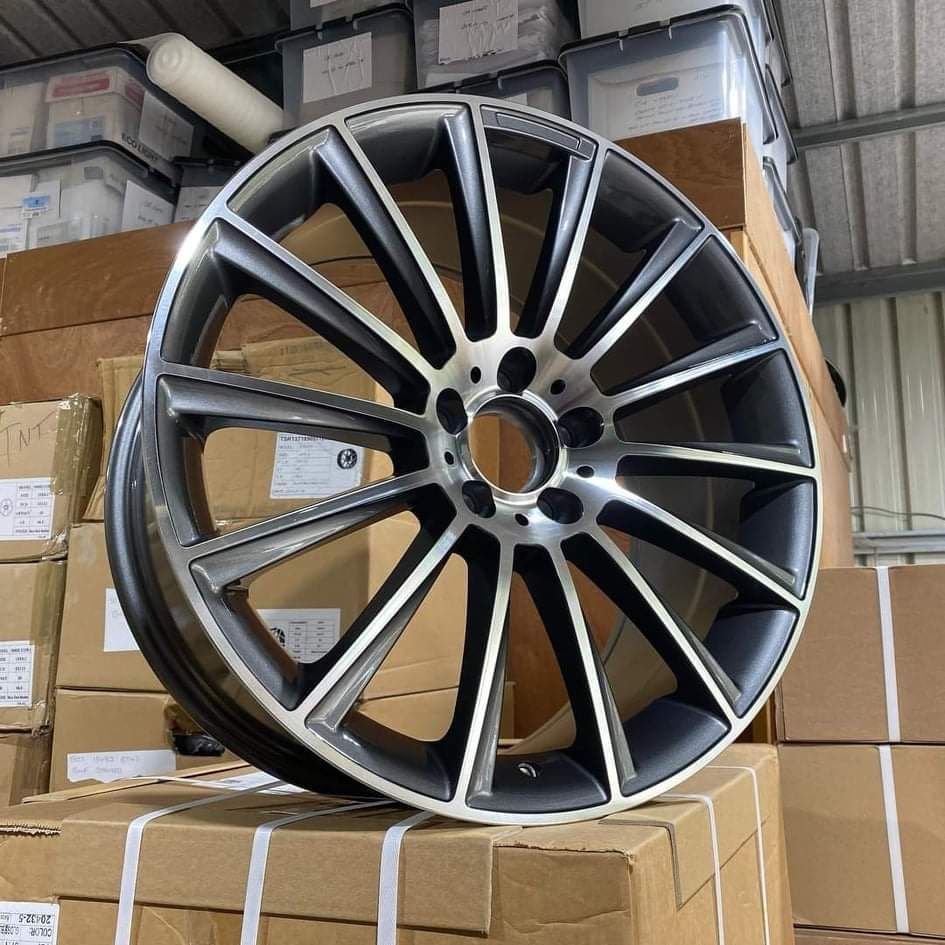

2016 New Design Replica Aluminum Alloy Wheels/car Wheels 17/18/19/22 Inch - Buy Aluminum Alloy Wheel,Alloy Wheel,Car Rim Product on Alibaba.com
No affiliation. You can find more by searching 5x112 wheels or 5x112 22", ETC, ETC.

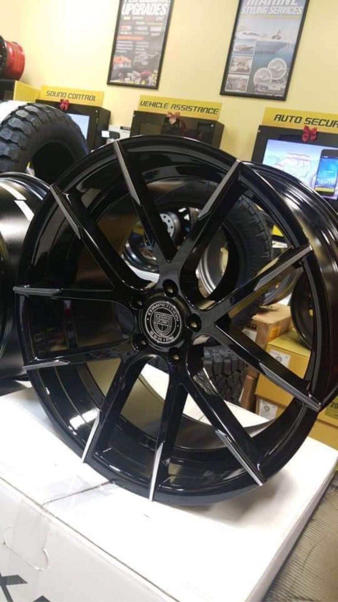

If new wheels are too cheap should I be concerned? There is this guy selling wheels for like $800-$12000 and they have a site but I just don’t wanna buy and they bend or chip easily
$800-12000 is a huge price range. What's the price point for your GL?
What do you mean by bend easily? If the wheels are painted and finished properly, they should not chip. Ask the seller what the painting/finishing process is for the wheels you want. Do they offer any warranty?

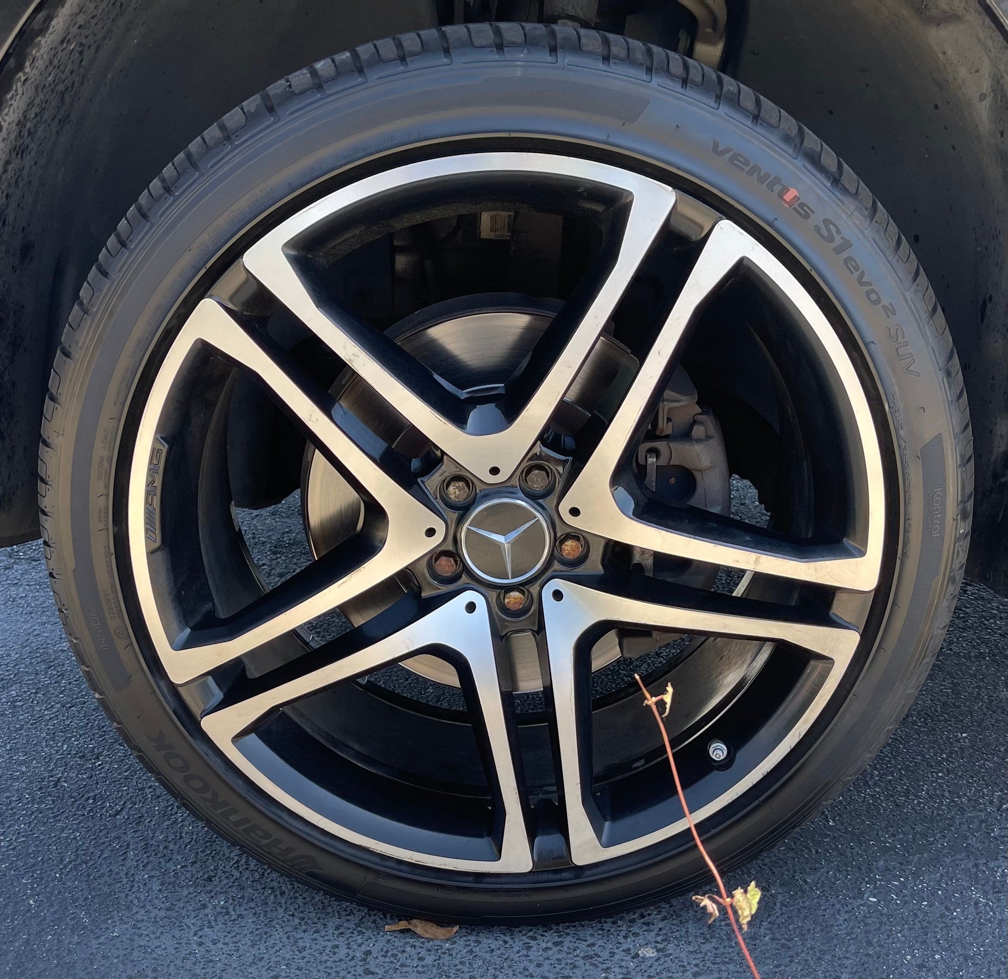

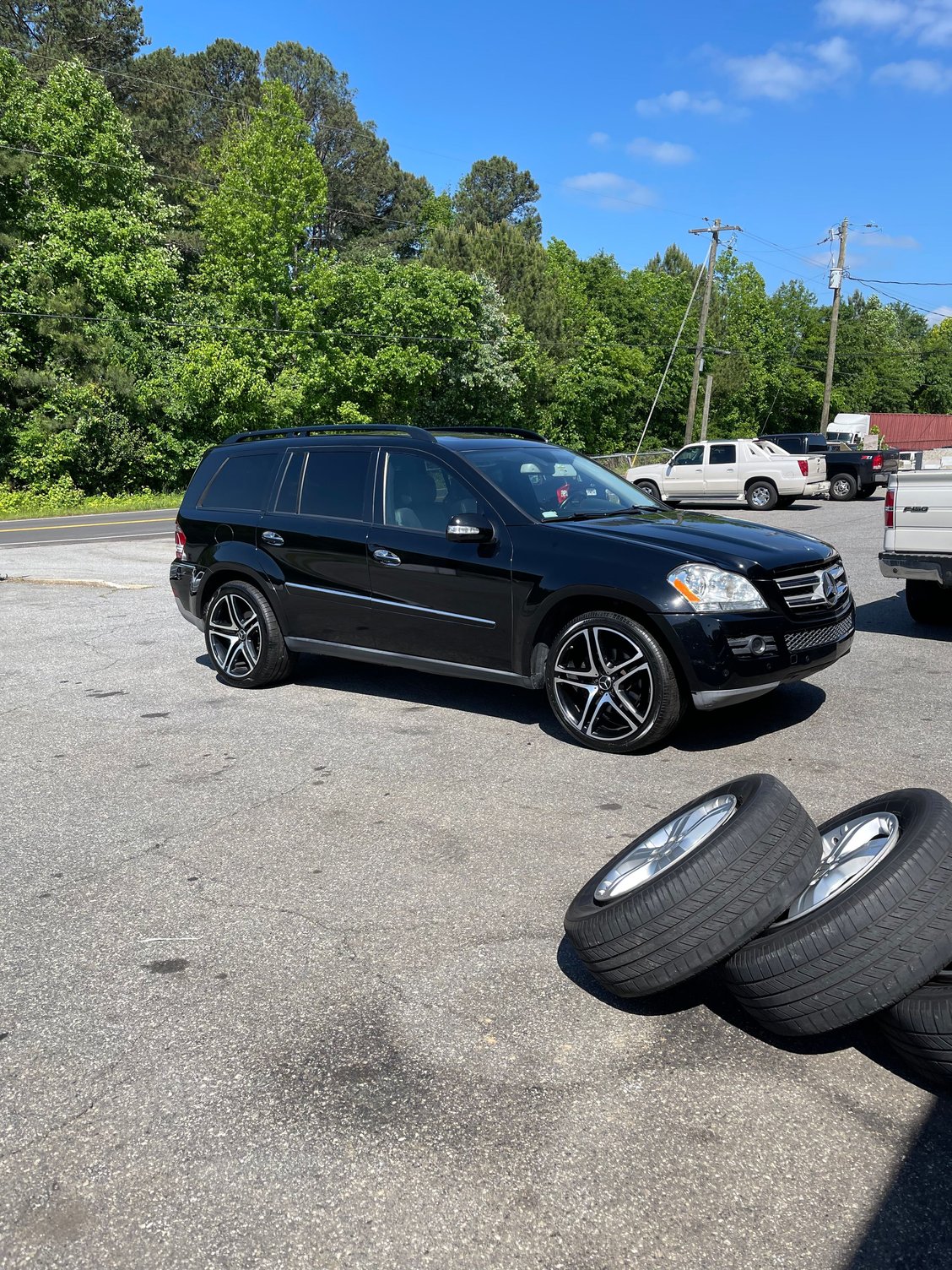

I started having issues with my tires which was one of reasons I was looking so aggressively. I decided to pull the trigger on a staggered set just to get an idea of what bigger wheels would look like. The wheels came off a GL previously and the guy made sure the circumference was right so I haven’t gotten my dash errors. I absolutely love the look BUT the ride is less to be desired. I feel the car rocking back and forth on the highway and it’s not as smooth. The guy said I need an alignment but could that cause that many issues?

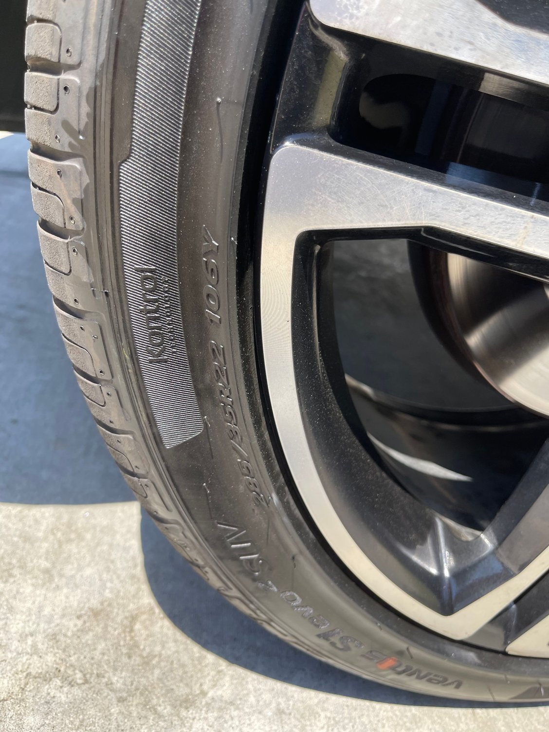

You’ll inevitably have a degraded ride when you have what really amounts to a couple of layers of electrical tape between you and the road.
but take this back to tires - what brand and compound are these?

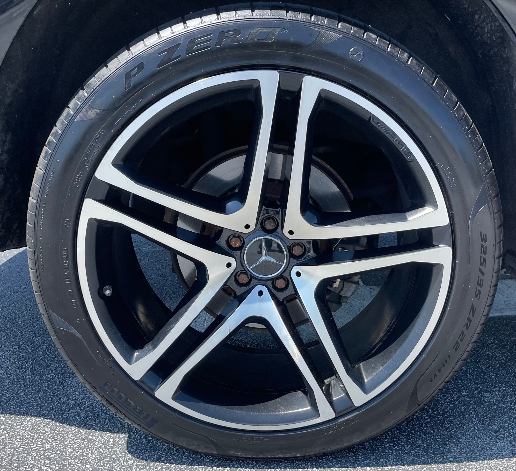

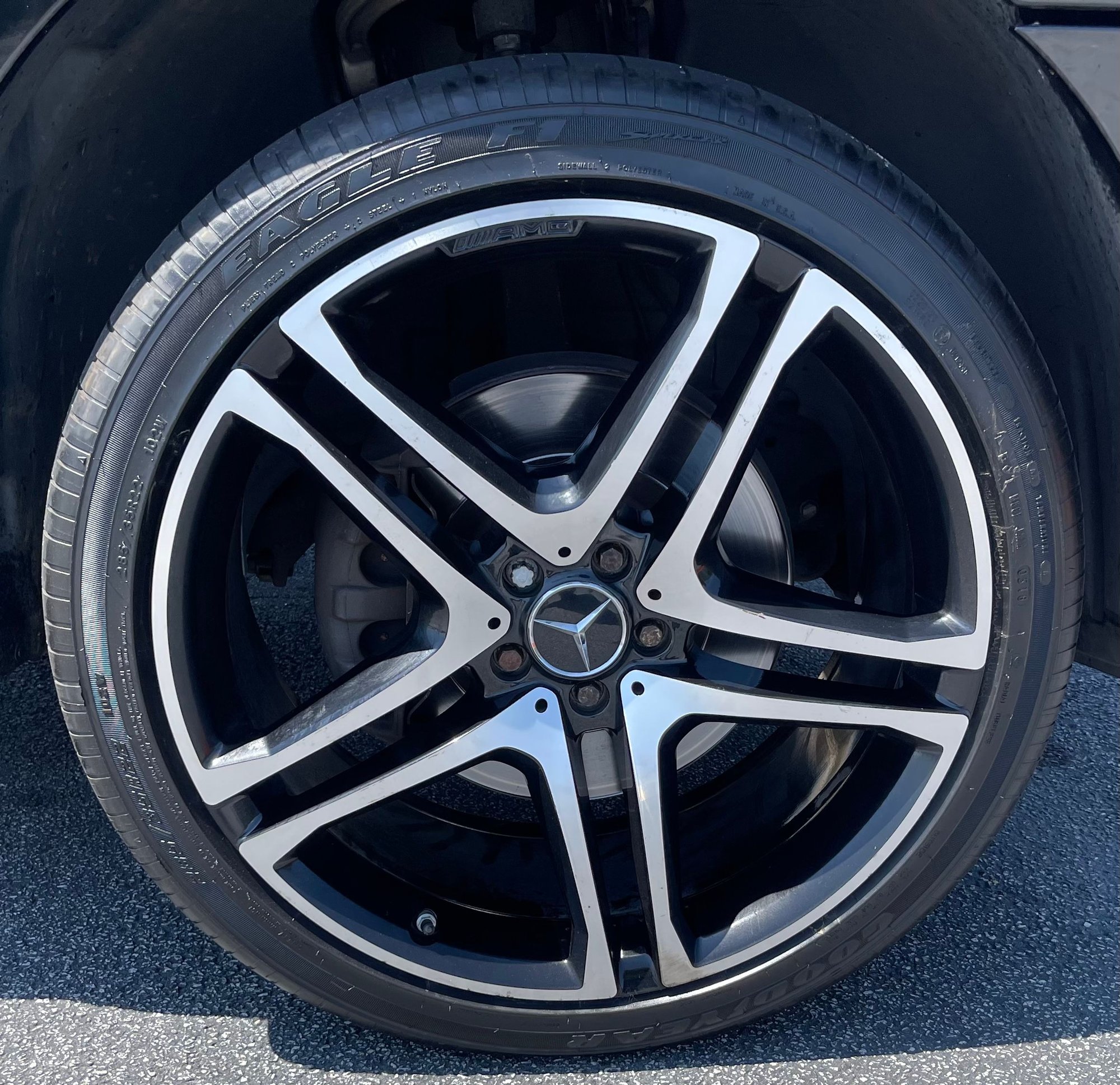

i don’t know what compound means but upon investigation it seems like the front 2 tires are a different brand (good year and Hankook) and the rears are matching Pereli…
