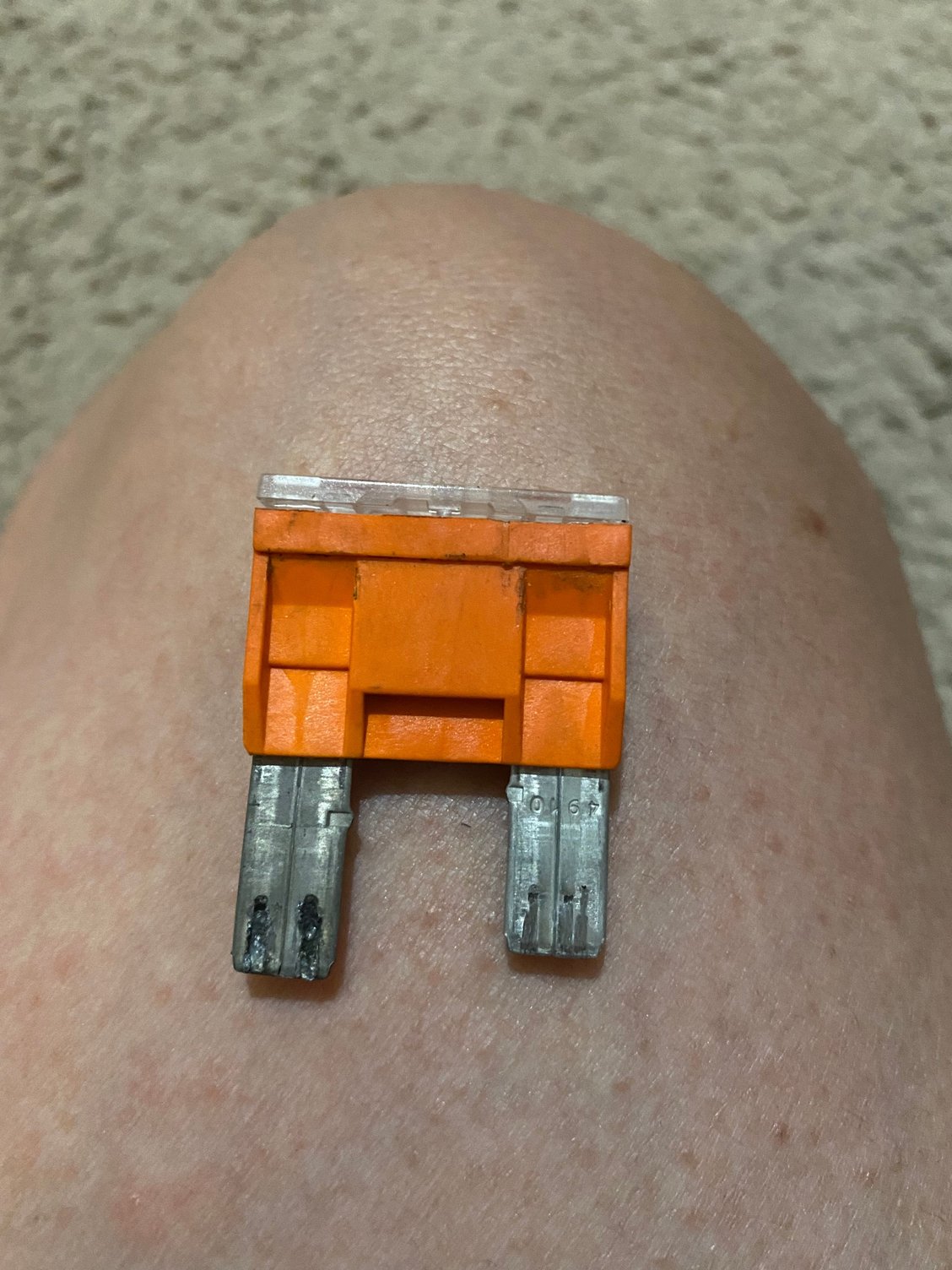

so update. I got curious and took off the bottom splash guard to check wires. To my suprise, no plug issue. I decided to check my relays and fuses. Removed the 40 amp fuse but had an extremely hard time removing it. I unfortunately broke it to get it off but, one side of the fuse is burnt. Is it because like y’all said, the compressor was over worked? Or am I now looking at a electrical issue? It rained a few days back here and I did notice the compressor had some water spots on it but I doubt a little water would short it out. There is a tiny slight nick on one of the plugs from when I was taking it off to replace the compressor. But it’s a tiny piece on the very end of the plug. Could that have allowed a little water to enter? Can I just buy another fuse and plug it in to see how it goes? I’m just really concerned at this point. Once again thanks for any info.

Did you check the pump relay as well? Sometimes when that sticks on the pump will exhaust itself by pressurizing the Reservoir which is then promptly released. But that’s not what you have described is going on.
Looks like you broke that fuse pulling it out. Just replace it.
It is fun to satisfy your curiousity, but: When you are a pilot, and one engine goes out, you don't sit and think about what might have caused it. You pull out a checklist and proceed. Don't try to investigate Just proceed methodically. Get the fuse back in, diagnose air bags, replace leaking bags, then turn your attention to the pump function.
yes I checked the pump relay and they look good. I even swapped it out with the same relay from another location. Didn’t see any damage of any sort.
