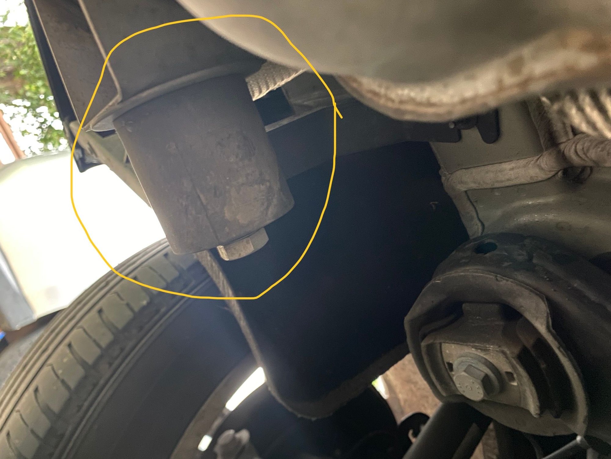

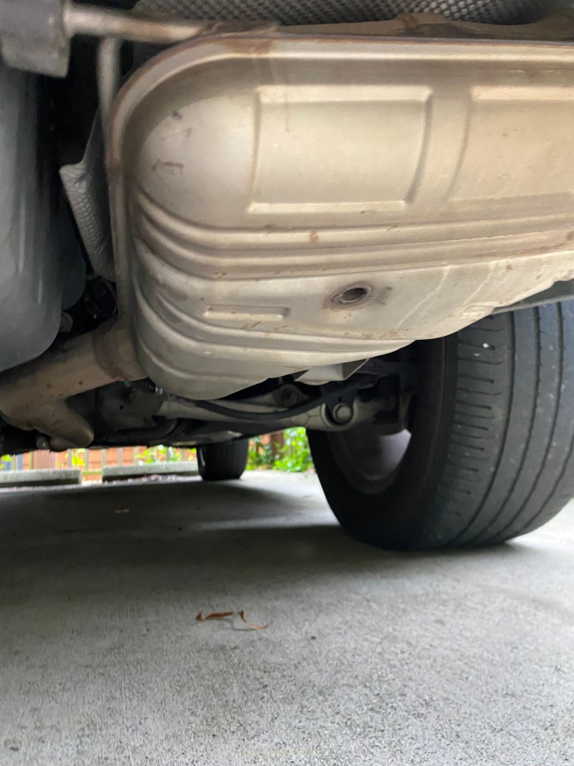

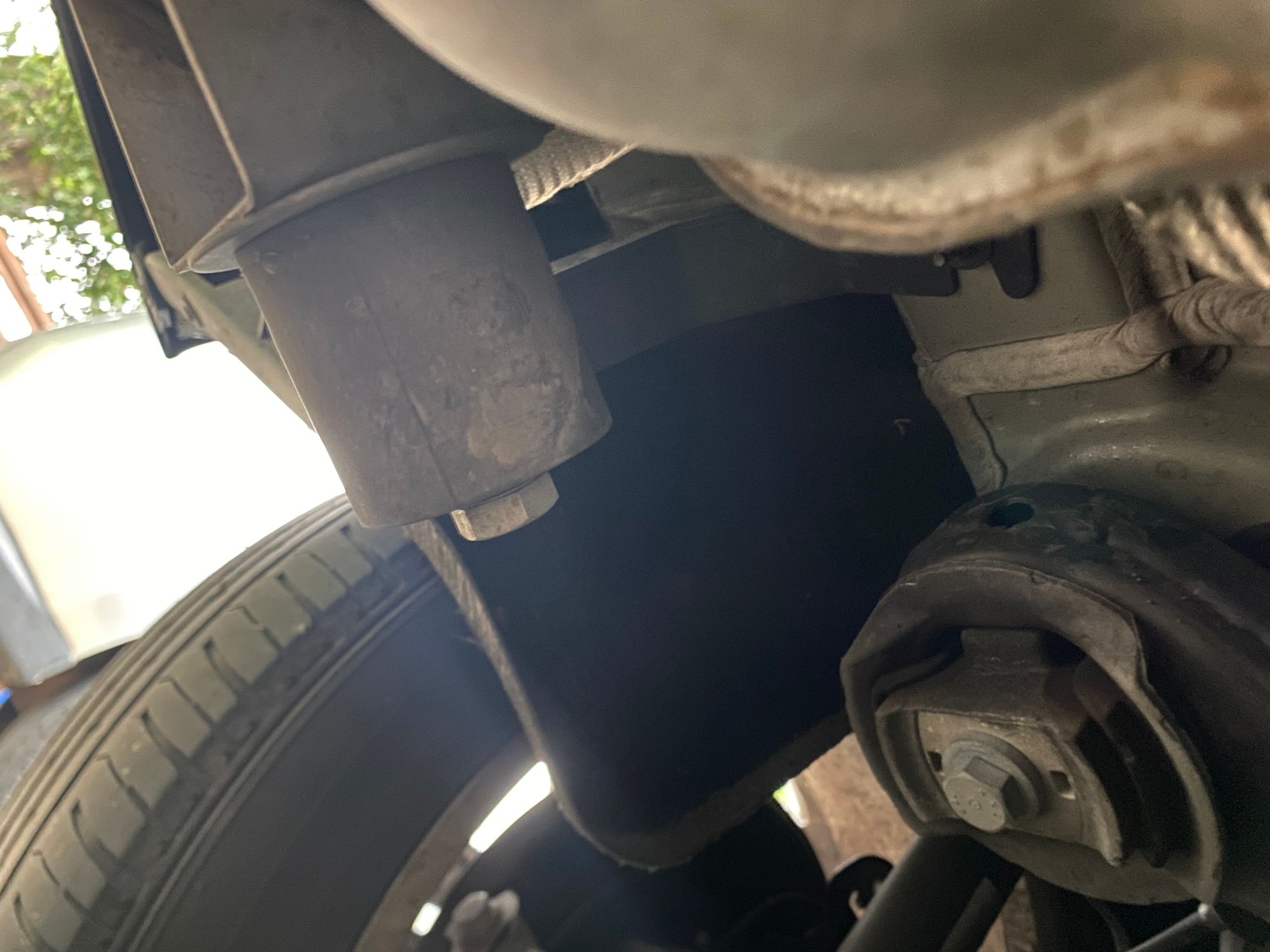

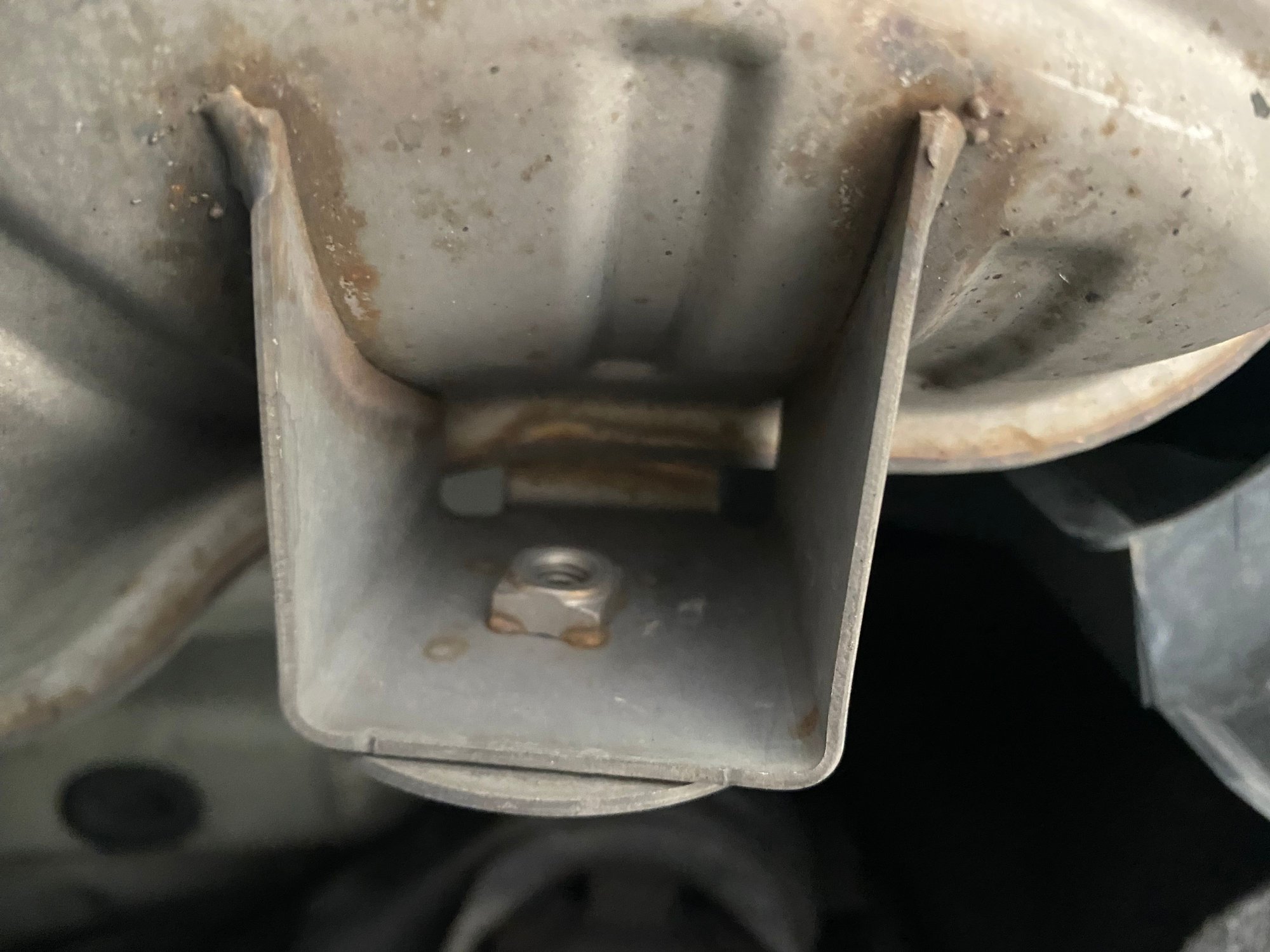

Hello and thanks in advance but I need to identify and order a missing rubber isolator on my new to me 2012 GL 350. I’ve done some online sleuthing and looked at parts diagrams but to no avail. I have a rubber bush or isolator on my drivers side exhaust but not on my passenger side.
Drivers side isolator above is what I need for passenger side
Missing isolator

Checking back in. I need the name of this part:
Item in yellow circle is what is missing on passenger side

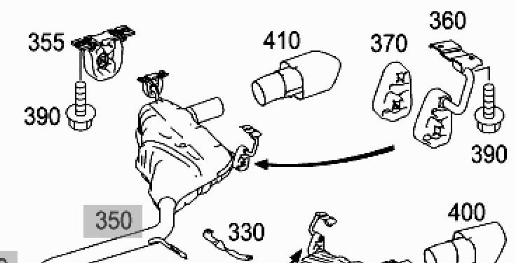

Unbelievable. VBB won't let me upload images. This is exhausting.
The pictures you posted don't match the diagram. I am unclear on what part you are missing.
This is the outer suspension ring, aka muffler bearing: A2514920044
This is the inner A1644920944

Did you confirm that the one on the driver side is actually connected to the exhaust?
I recommend the maxim: If it ain't broke, don't fix it.
