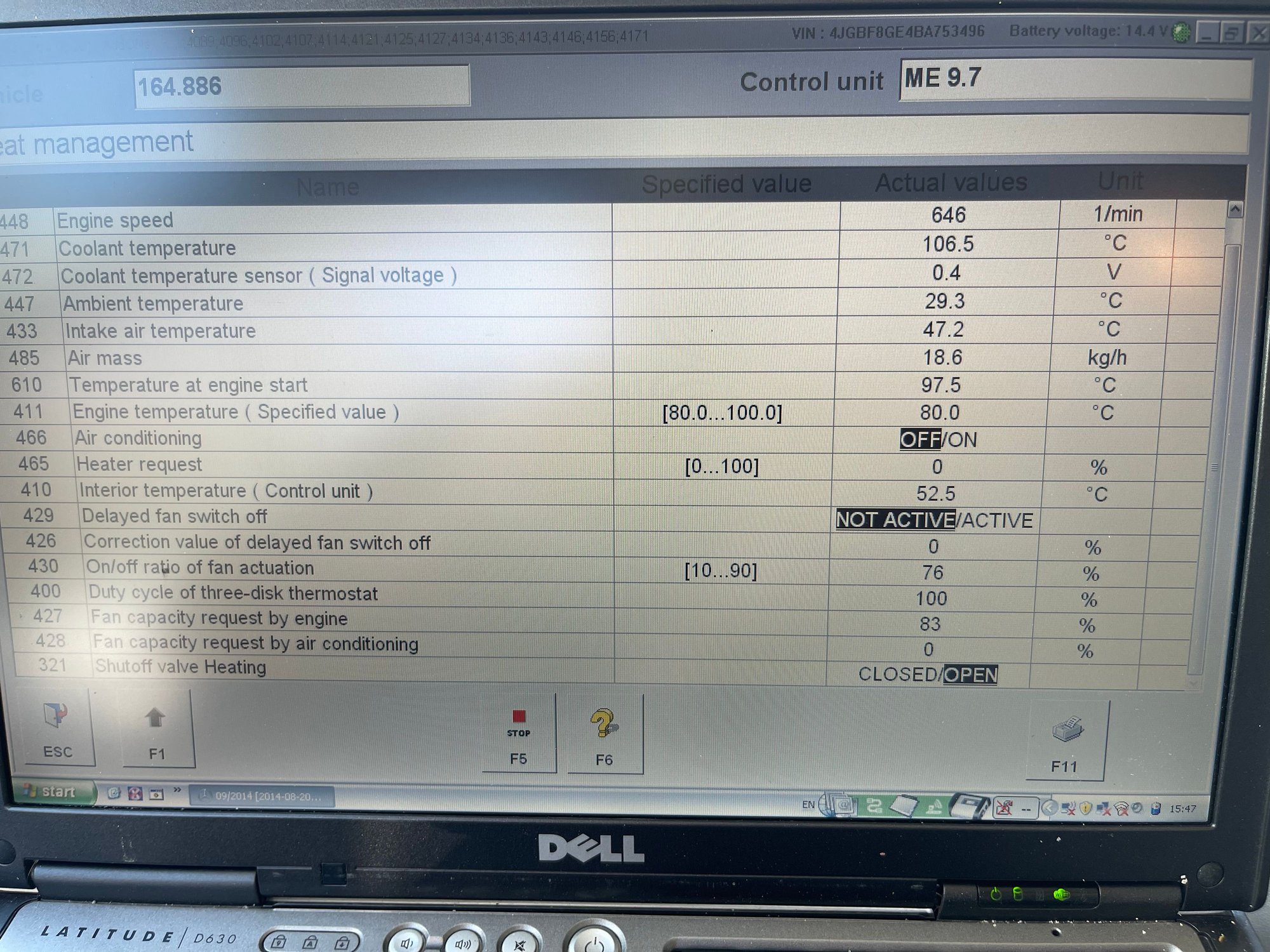

Eric lots of good questions and as usual I am pulling out what little hair I have left?
I do not think it was running hot at all because when I got home I probed all along the hoses,engine etc with the fluke temp probe… The Star system says the coolant is running hot and like you already stated the idiot gauge on the dash is sitting still as compared to the ride home it was very active.
Do you know where the coolant sensor is located ? Back of one of the heads ? According to the Star system it is asking for more fan motor .. the conversion to Fahrenheit says it is running at 230? I would think this would be boil over conditions and it gets there very fast in the driveway idling ?

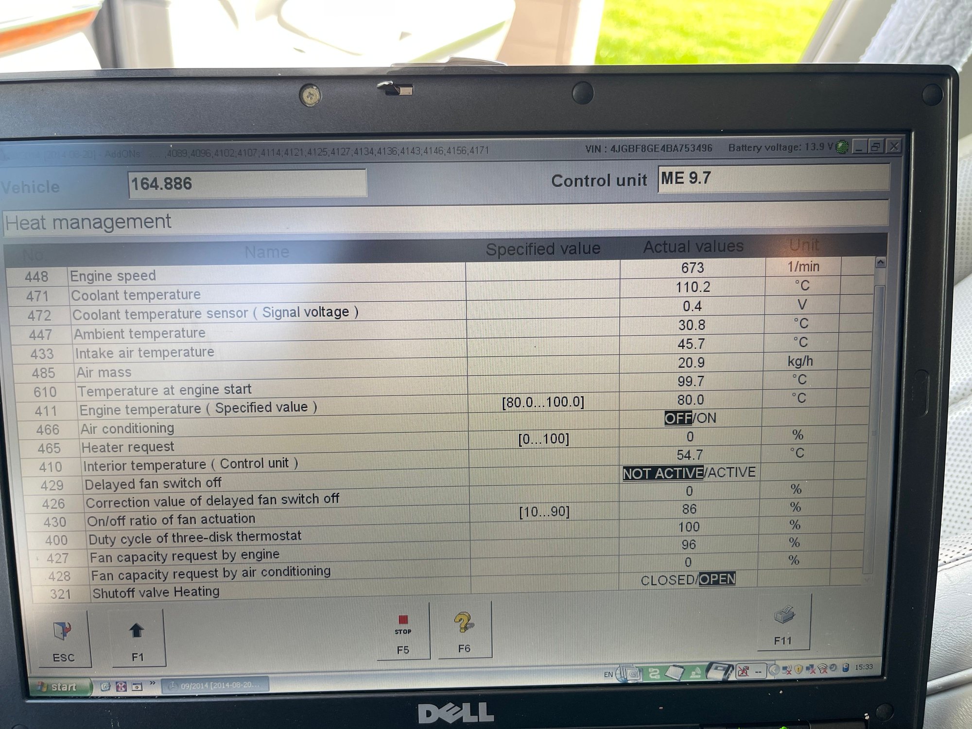

star system readings

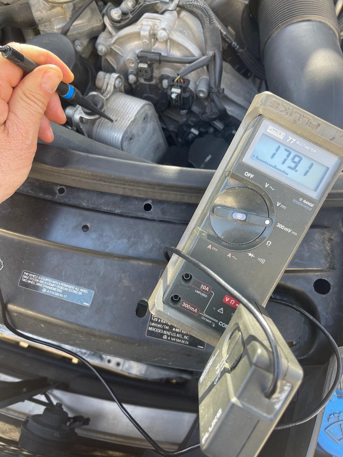

overheat
You would think that if the true temps were 230F that when I probe the upper radiator hose and manifold/cooler that they would be very high also ?
This Fluke temps are in F

I believe there is a temperature sensor at the thermostat - it has four leads, two for heating the wax element and two (I believe) for a temperature sensor. In case you are not familiar with electrically controlled thermostats, they have a native set point of 212, and the ECU adds heat to the element to make the thermostat open at a lower temperature for certain driving conditions, e.g. full throttle.
There could be another temperature sensor elsewhere. Might see what WIS has to say.
Since you were touching aluminum parts that are in contact with the coolant, I'd say your temperature readings are accurate. Plus, they make sense; given that the ECU thought the temperature was too high, it would do everything it could to open the thermostat all the way, and 180F is about the lower setpoint, with presumably full current applied to the wax motor heating element. I'd guess the temperature sensor is faulty. WIS should tell you what to change in that repair. Do inform if it turns out the sensor is not at the thermostat.

I'm stumped. Somehow the ECU is getting bogus high coolant temperature readings because the AC is running.
One clue is that the readings are not weird, like surface of the sun, but high-normal. So it's not total failure of some component. Maybe it's something stupid like the AC high pressure line pressing up against the coolant temperature sensor.

Today I had a couple of readings during my ac running ?? Low temp at the thermostat housing 160ish and close to 200 at the oil cooler???
Now that's an interesting data point.
I am not familiar with the route the coolant takes, so I can't comment on how this might happen.
However, didn't you previously see similar readings between the two while you were having high system-reported temperature?
Contact thermometers are difficult to use well.

Contact thermometer
I have used these old Fluke temp probes for years … during engineering heat sink readings and they always lined right up with epoxied thermocouples . My new hobby of installing mini-split heat pump units I always use the old fluke temp probes… I think i have 3 of them.
And yes I had a couple readings where the oil cooler and thermostat housing were almost identical .

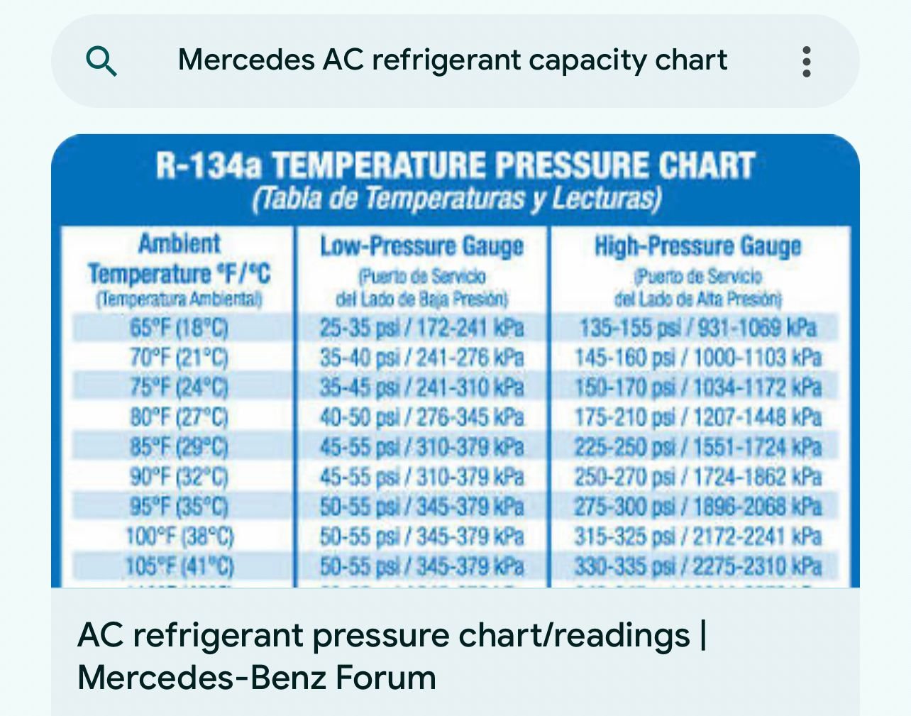

Todays findings after a few Dr Appts ( I should be going to see a Shrink for buying another 164 chassis)
Decided to run another 2 gallons of distilled water thru it and hook up my ac gauges… well first it was definitely low on charge and took 18-20oz’s to bring it up to a decent pressure 35# low side and #125 high side while producing 40 degree air on max .
It took over 30 minutes before the fan went on full 100% speed.
I talk to two MB people today .. the parts guy at our local dealership .. he says the most sold part is definitely the thermostat and housing . My Indy shop basically said keep up the good work and let him know what I find because he would be doing the same thing ..
My thoughts after tinkering this afternoon are pretty simple … between my fluke readings and the internal readings there seems to be about a 20 degree difference and I believe that is why the fan is coming on so strong… so going to stick with changing the thermostat and temp sensor .

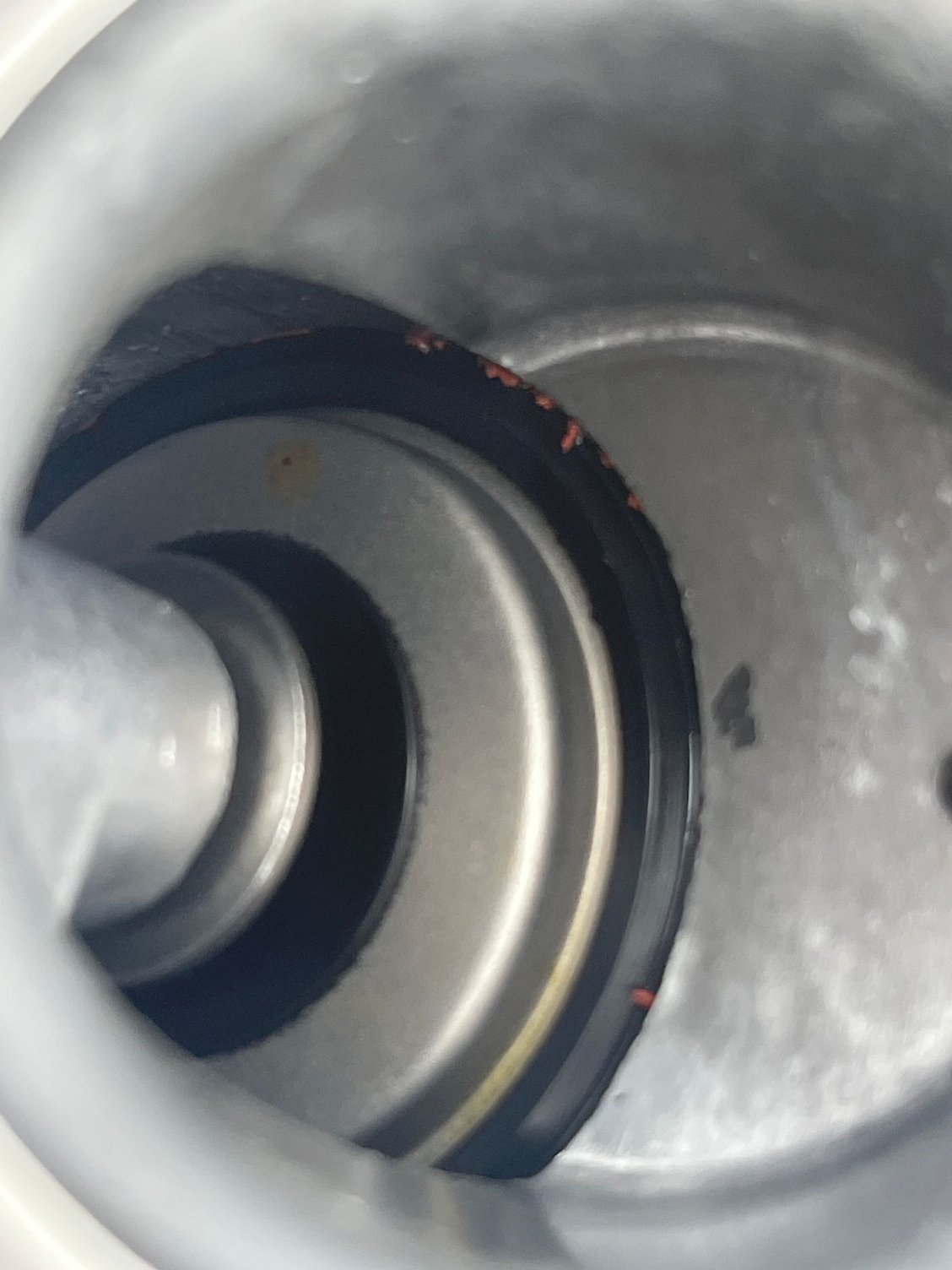

Orange material thru the cooling system?
Getting ready to replace a few cooling components and while waiting for thermostat and temp sensor to show up I tore most of it apart.. so far in the top radiator hose and inside the thermostat I am seeing some orange material.. didn’t see it during my 3 flushes with distilled?

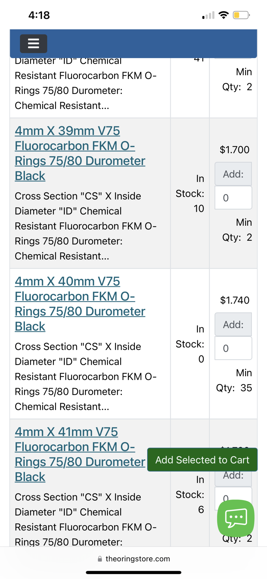

Another subject is O-rings
I have a great source for Orings and I sourced the thermostat size at 4mm x 40mm or possible 4mm x 39mm and Viton 75/80 would be a good choice .
I bought the O-rings for the transmission shift spools a couple of years ago for the 2008 GL550 when a couple of orings fell apart and caused a limp mode. Another subject for another day!!

I wonder what those orange particules are. Copper maybe?

Orange stuff could be excess silicone from a previous repair/replacement of something. Do they feel "silicone-ly"?
If they're harder feeling, it could be coppery stuff from a coolant system leak repair "in a bottle".
Just a couple random guesses

About the only steel in the system I know of is the water pump's impeller.
