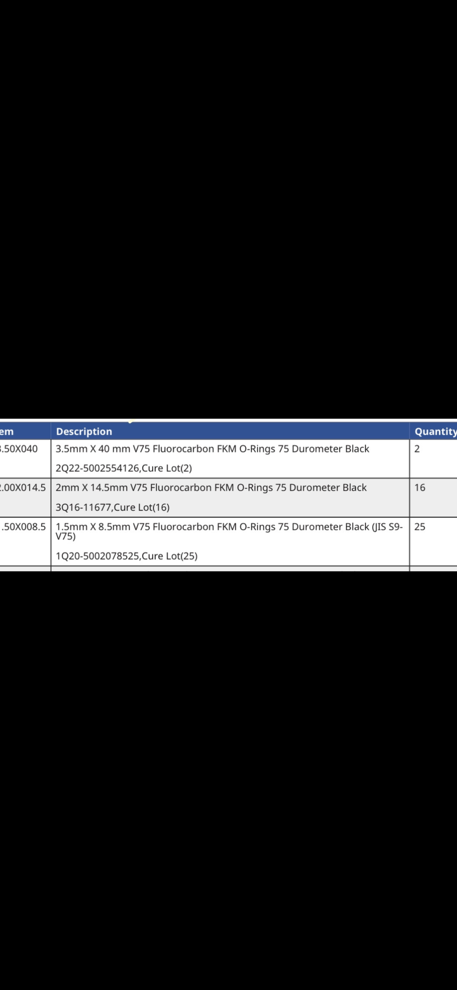

New Zealand. Yeah, that was the problem. Used a VPN and theoringstore showed up fine. So 8.5mm is an inside diameter. They have a very good range. 8.5mm seems to be a bit of an odd size. But I'll track some down.
Cross Section "CS" X Inside Diameter "ID"1.5mm X 8.5mm V75 Fluorocarbon FKM O-Rings 75/80 Durometer Black (JIS S9-V75)

sizes
1 each for shift spools ..total 8 spools
total 16 Orings
