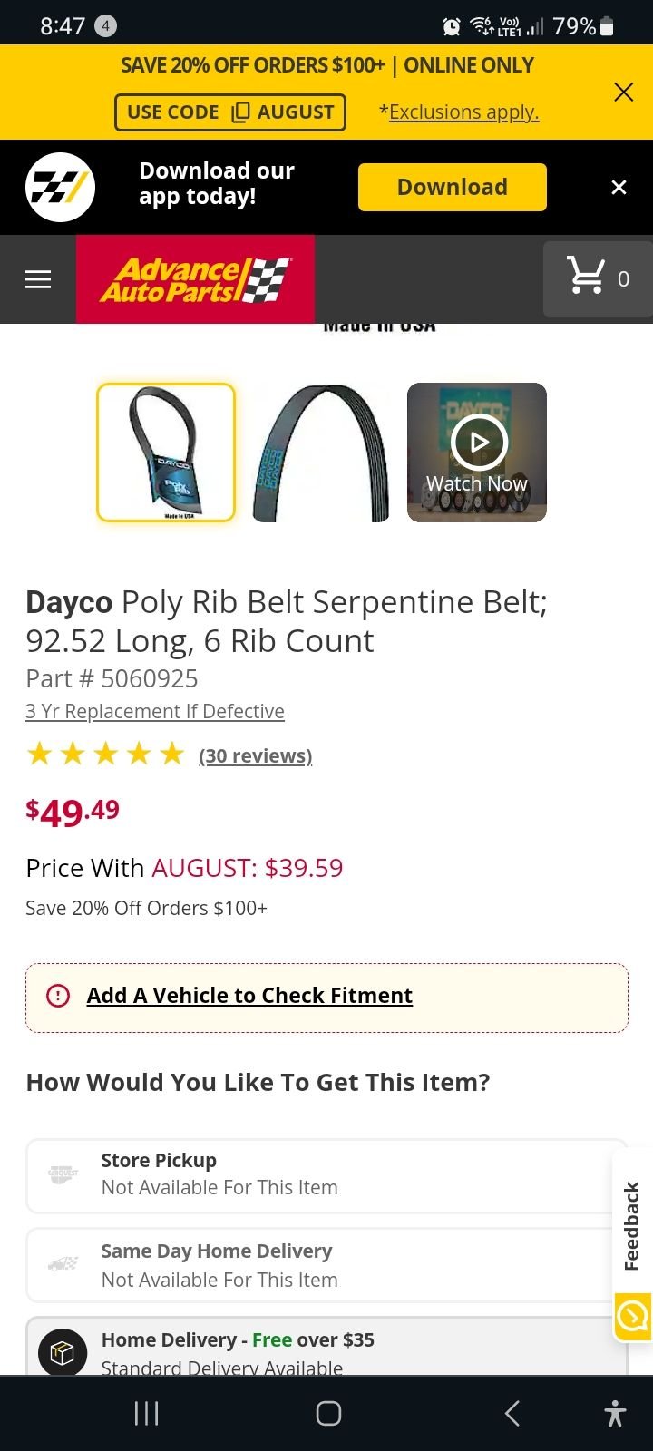

Seeing this in another post so I saved it for future reference. I'm told that this belt will fit when bypassing the ac compressor.

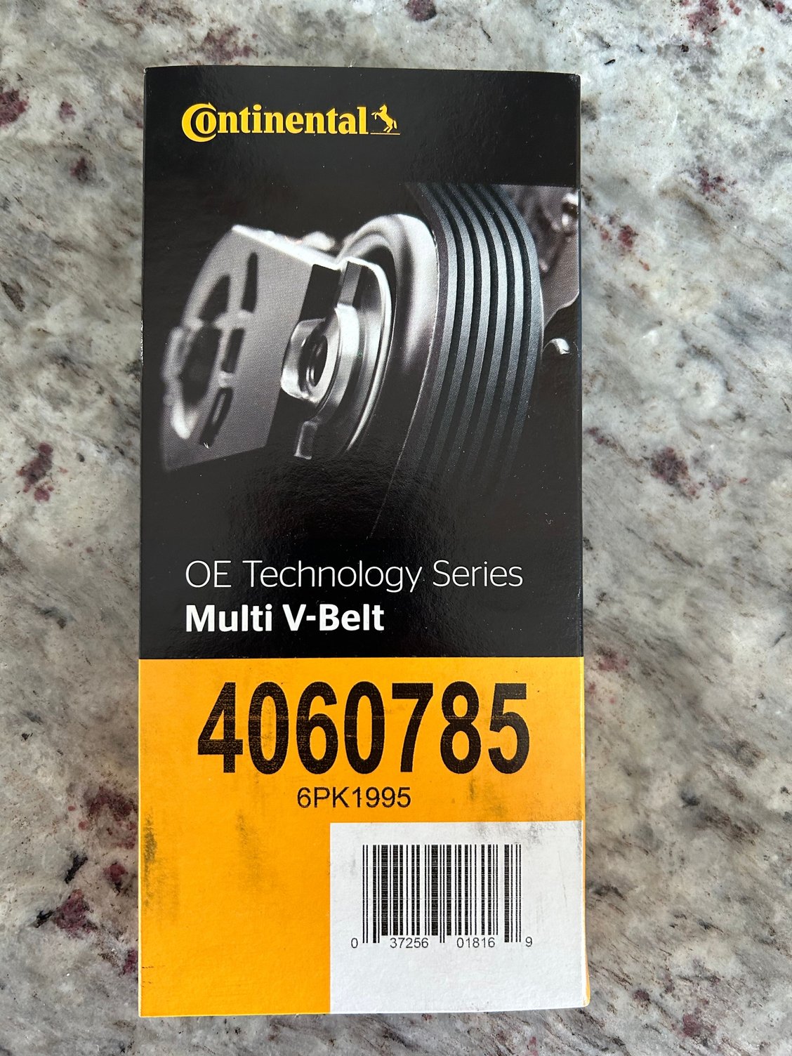

Thank you, both. The 92.52 belt was entirely too long. I am assuming that is the belt for a gasoline/petrol engine and I have a diesel engine.
Long story short, the OM642 diesel will need a 78.5 belt to bypass the A/C compressor.
Unfortunately, the belt rubs on the seized A/C clutch and I didn’t check until I had everything back together. It will be fine for the short term (2 short trips this weekend) but I need to see if I can remove the clutch from the A/C compressor. If memory serves, I don’t think the clutch is replaceable on the GL350 compressor.
Thanks again for the support and hopefully this can help the next person stuck in a pinch.
