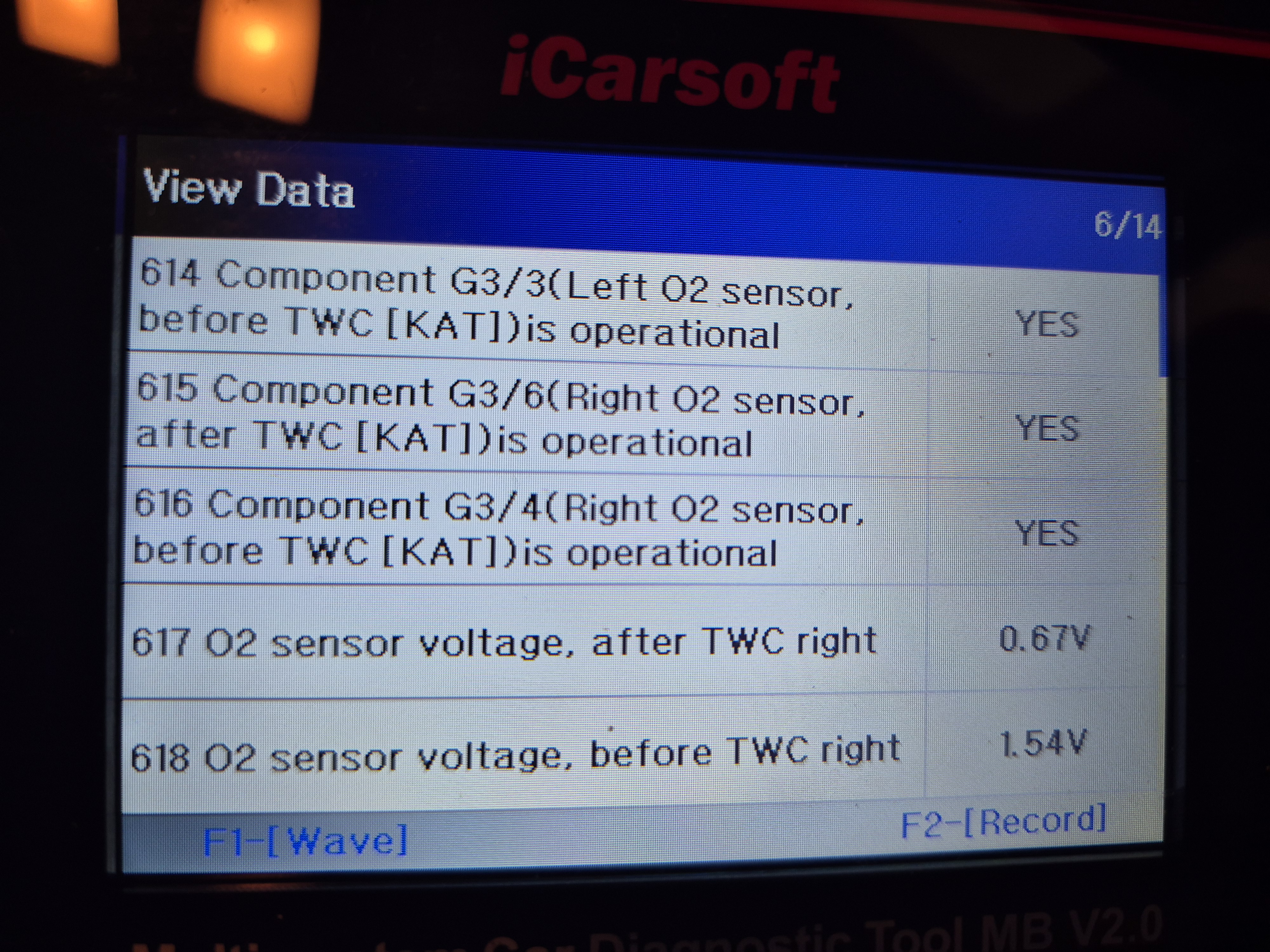

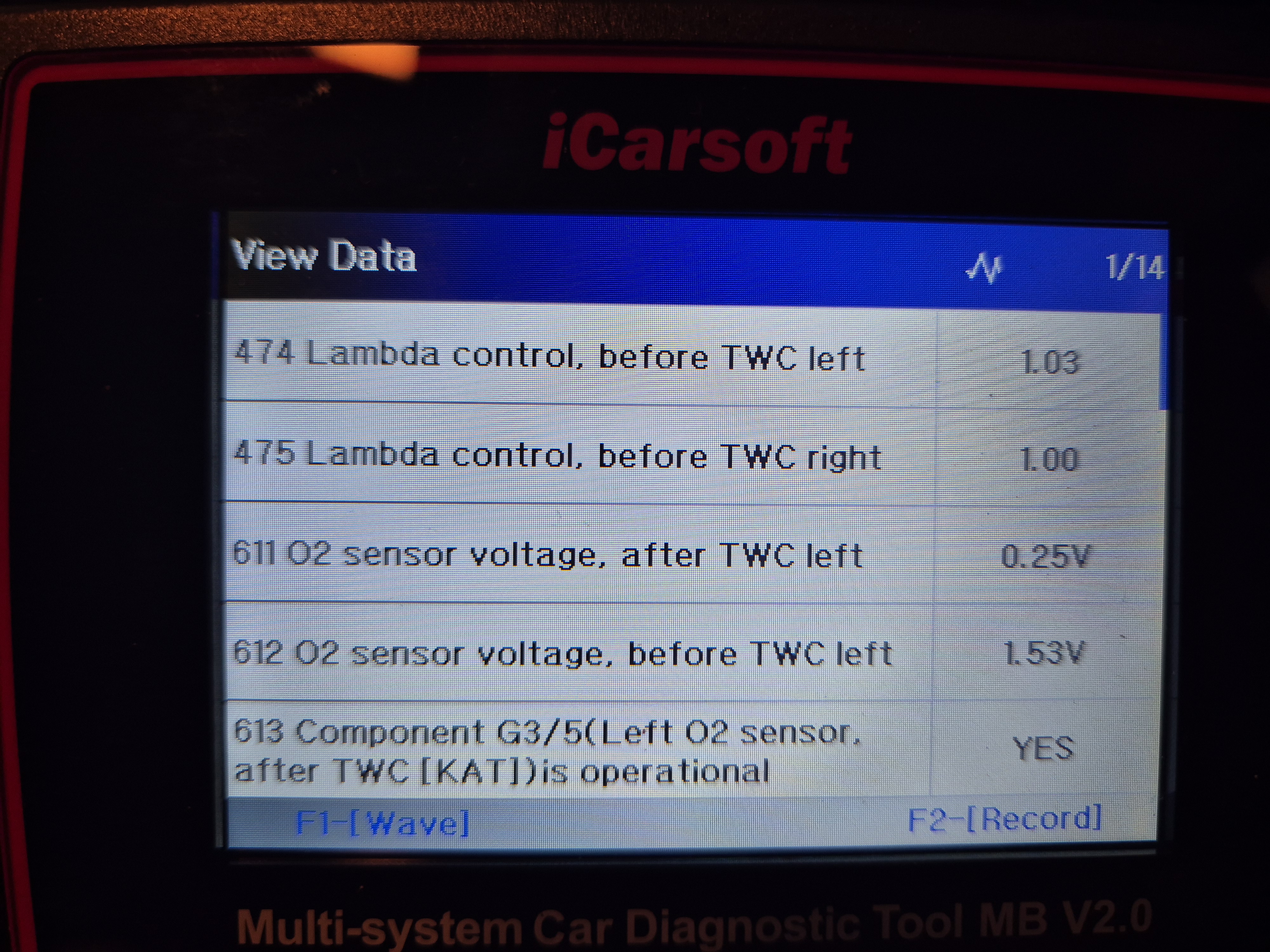

Old Feb 3, 2025 | 12:31 AM
BlackML550's Avatar
Joined: Jun 2014
Posts: 1,085
Likes: 442
From: Melbourne, Australia
2010 ML550 VIN WDC1641722A564750, 2010 B180
Originally Posted by BlackML550
Ill check tomorrow and let you know.

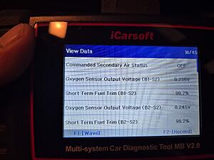

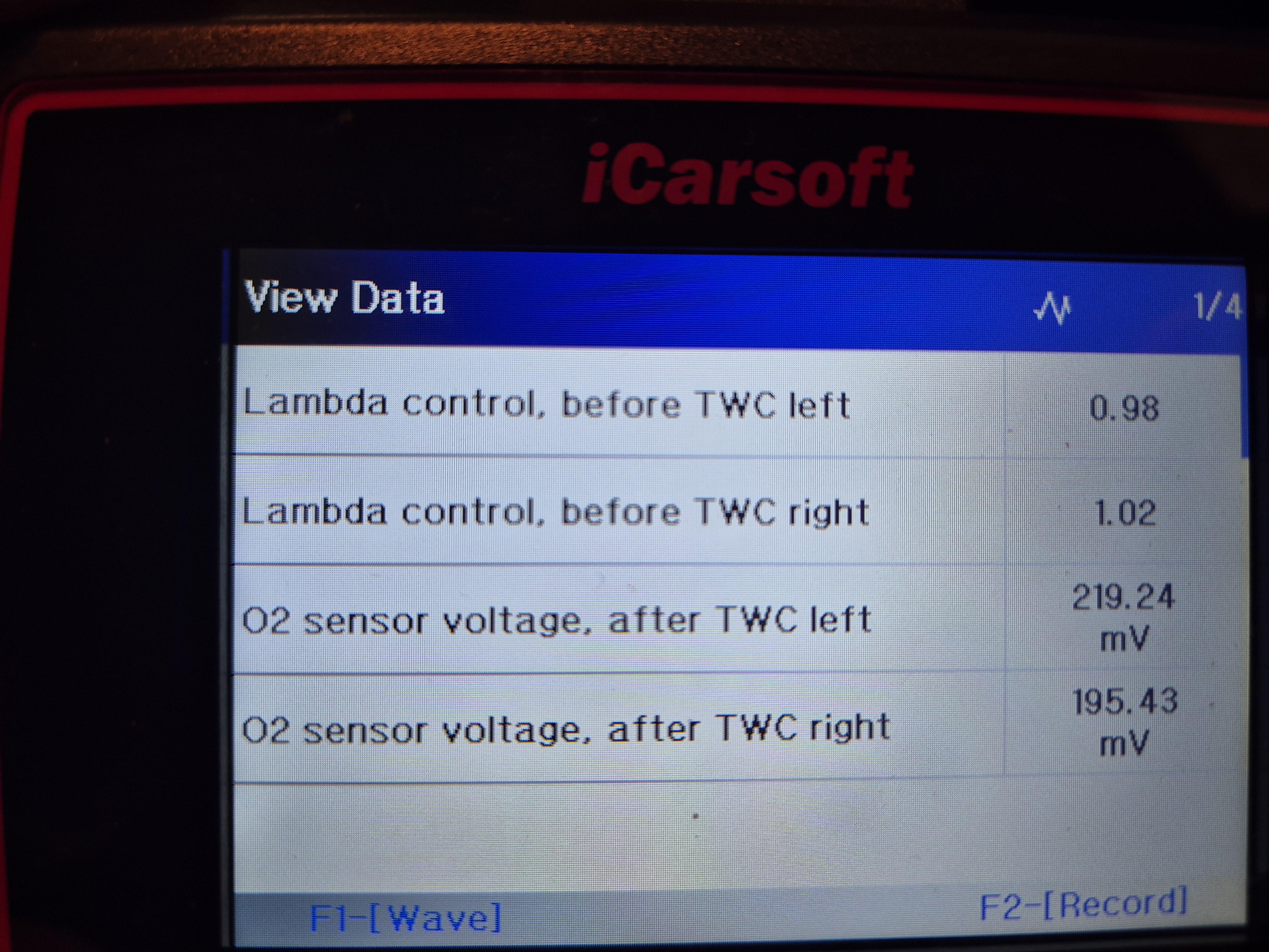

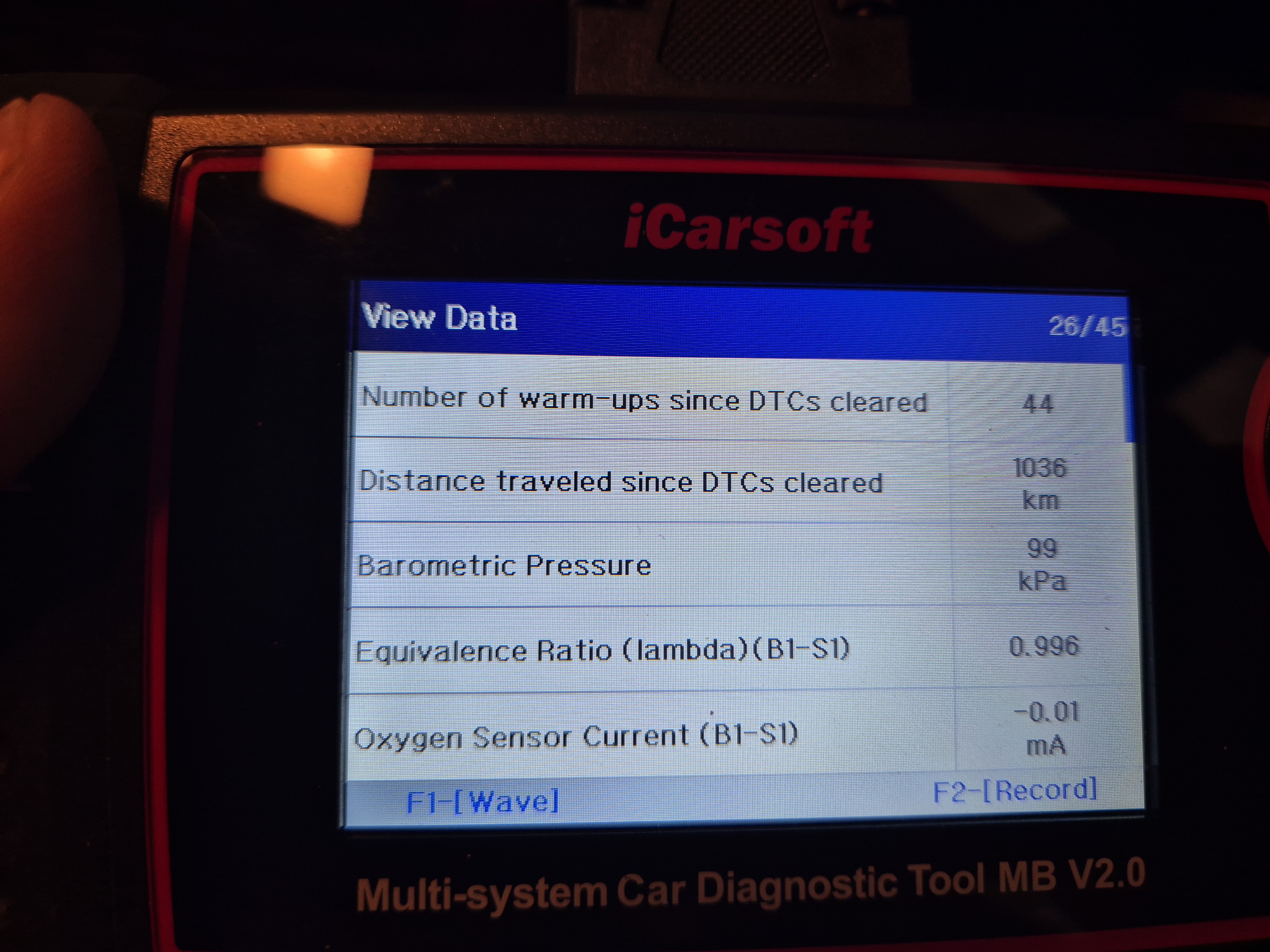

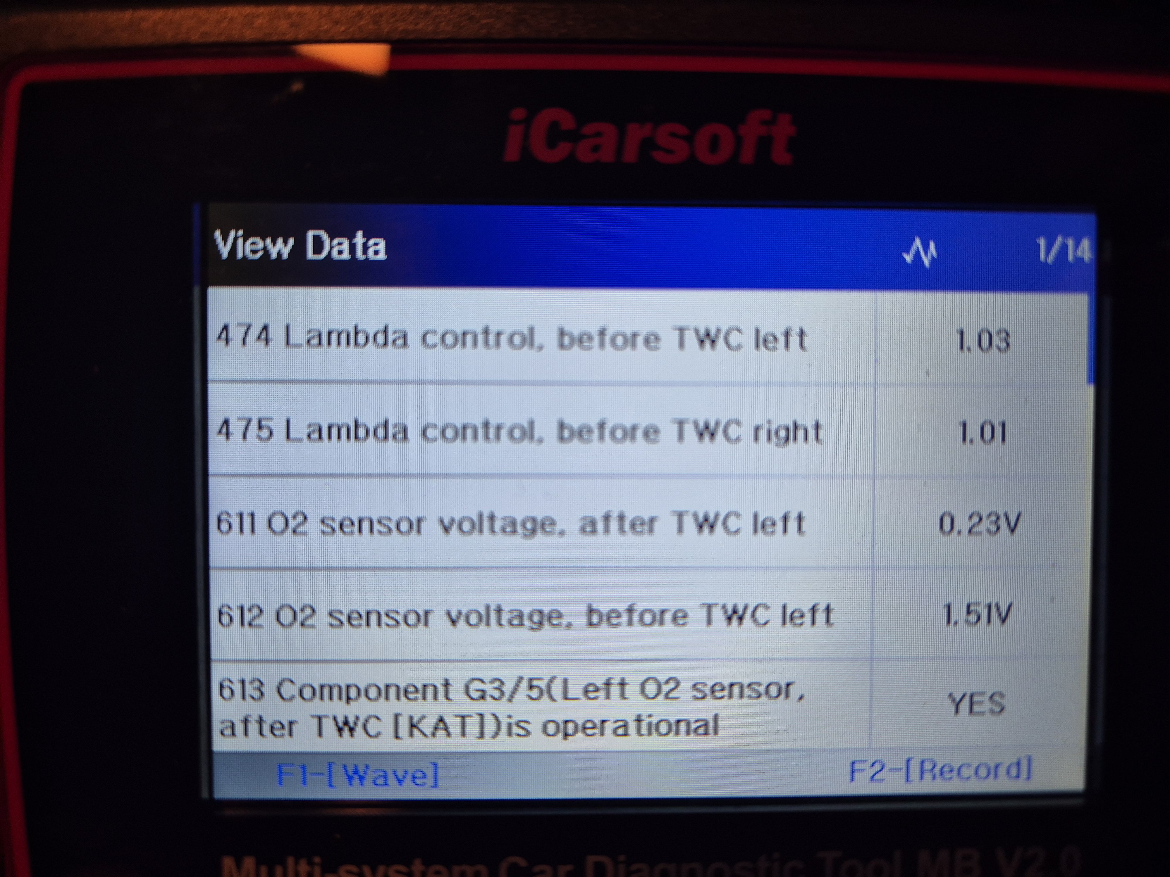

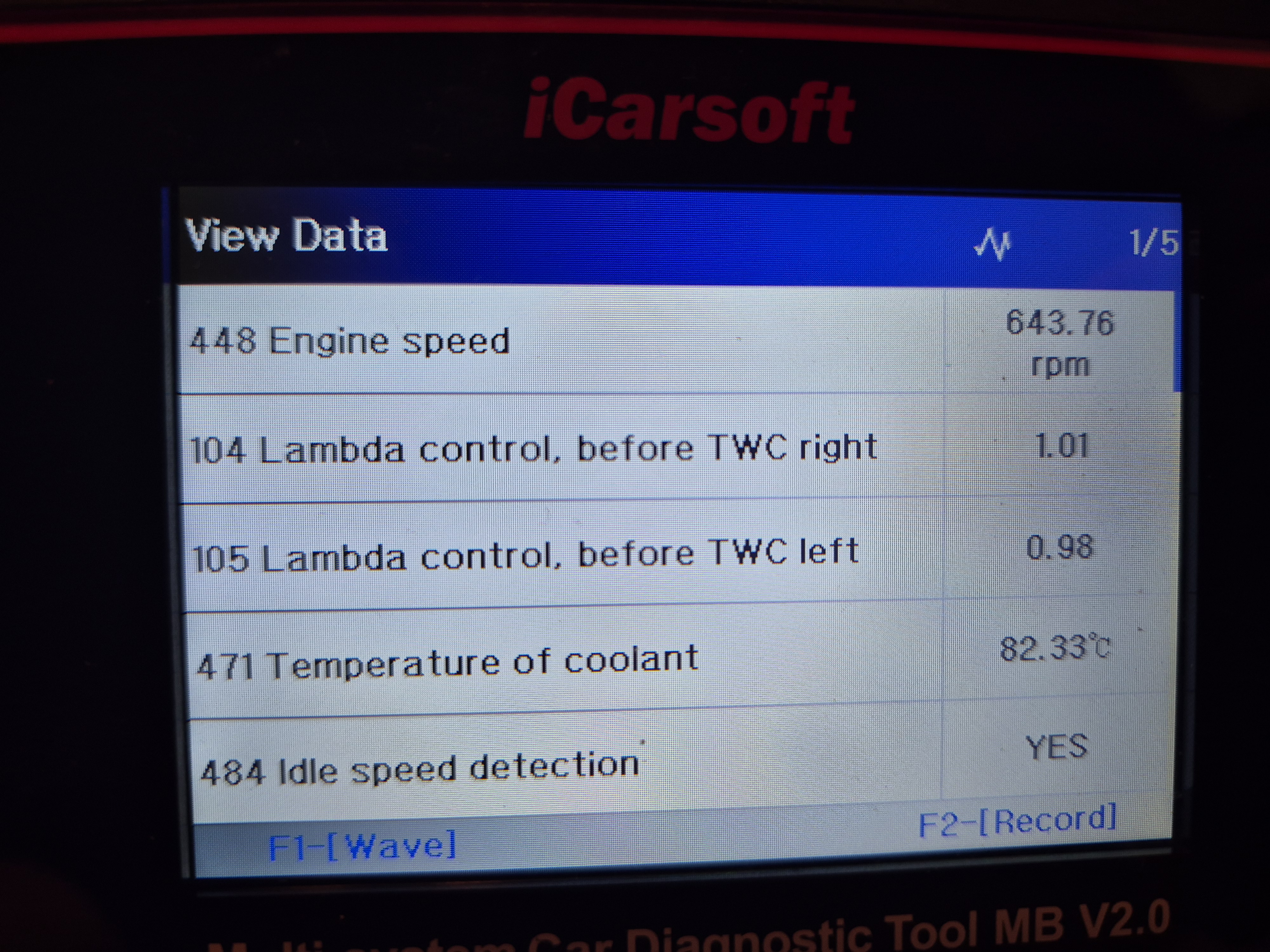

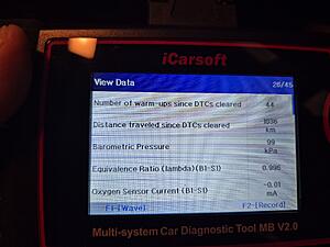

Sorry its taken a few days. Here are screenshots of my ML550 data. Cat temps at 394 degrees C on both sides, noting a very hot day here with tempreture about 37 degrees C. Car was at operating temp after a drive and engine was running when the data was taken. There's a bit of double up in the data as they were taken from different screens that sometimes duplicate information. Hope this helps.
Attached Thumbnails Funny exhaust smell-20250203_161830.jpg   Funny exhaust smell-20250203_161824.jpg   Funny exhaust smell-20250203_161814.jpg   Funny exhaust smell-20250203_161617.jpg   Funny exhaust smell-20250203_161600.jpg
Funny exhaust smell-20250203_161558.jpg   Funny exhaust smell-20250203_161505.jpg   Funny exhaust smell-20250203_161444.jpg

Old Feb 3, 2025 | 11:17 AM
vesiadog's Avatar
Joined: Jul 2016
Posts: 701
Likes: 129
From: NE OHIO
1998 SL500,2011 GL550,2009 ML350,past 1995 E320 Cabrio ,2005 ML500,2006 ML500,1996 SL500,1972 280SEL
thanks
Thank you for all the readouts. The biggest difference with the readouts is the Cat temps..741 F vs 831 F… with mine being hotter. ??? thanks again for taking the time.
