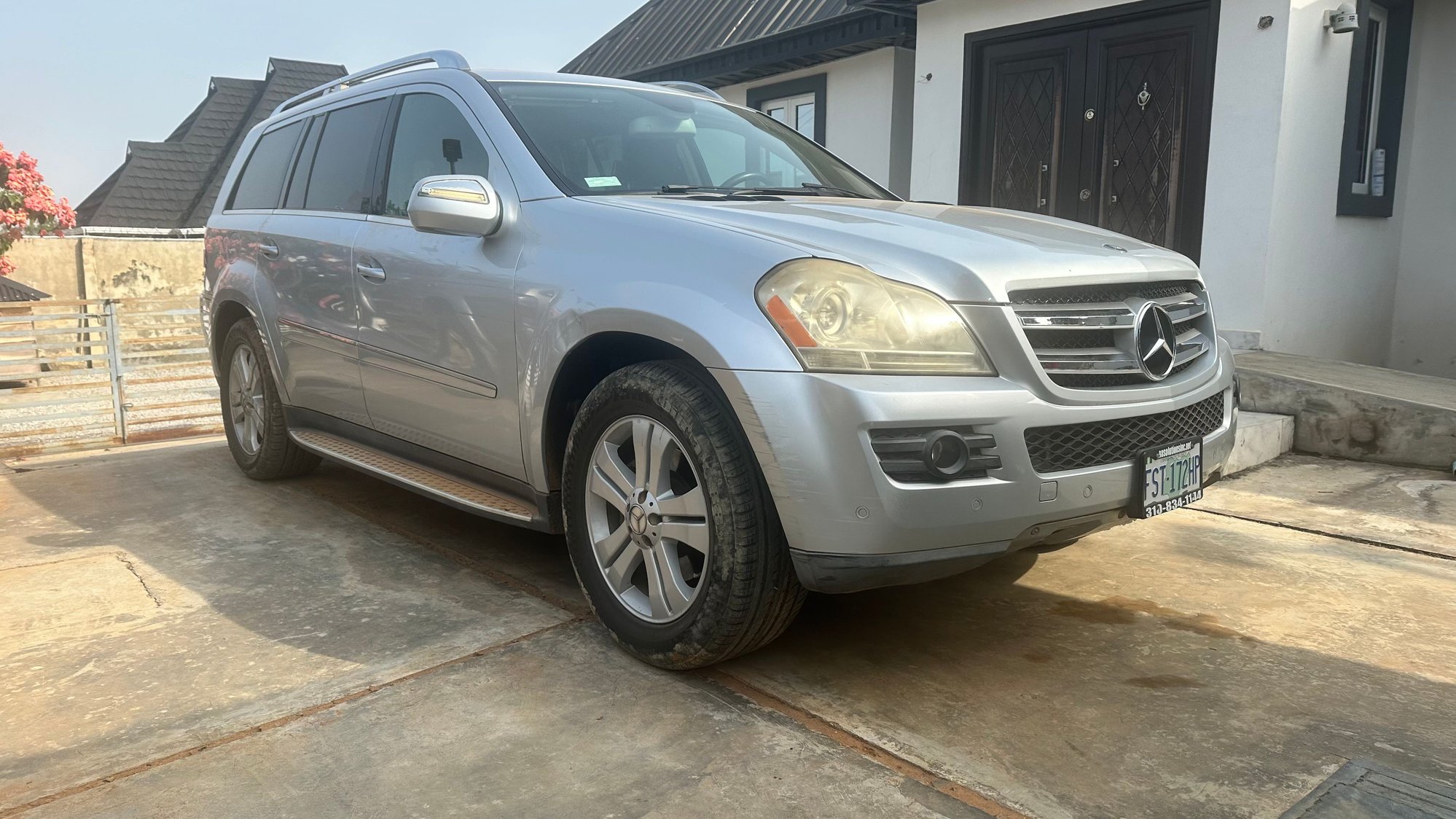

I purchased my 2009 GL450 in 2021 for $8,900 from a curber in Southern California.
Zero service record has been wonderful in Nigeria. Well except for the balloons due to our deplorable roads here. I changed to regular suspension which rides horribly compared to the Airmatic. I’ll be going back and just deal with it.

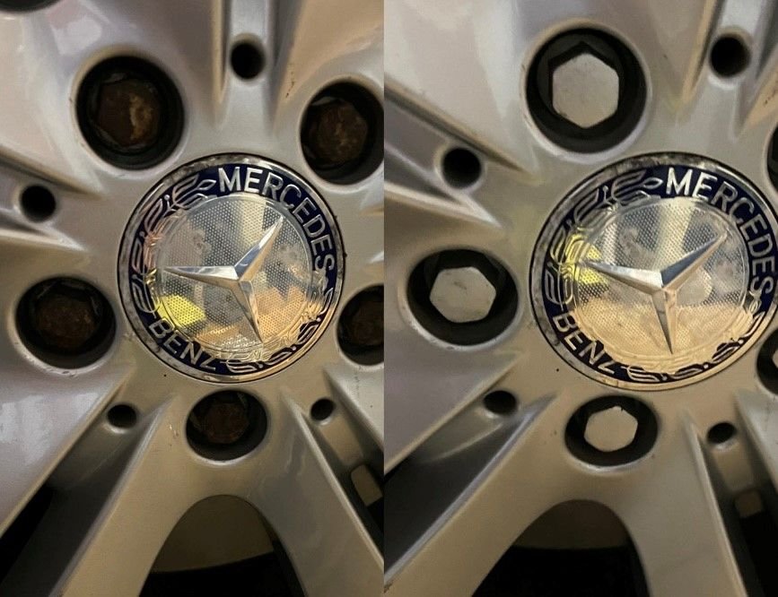

Swapped out the rusted lug bolts with new ones, the old ones were really bad. I figured out the 12V passenger footwell thing, it was just a bad connection at the positive terminal inside the connector but I cleaned it up and it works fine. Next is a deep interior detail.
