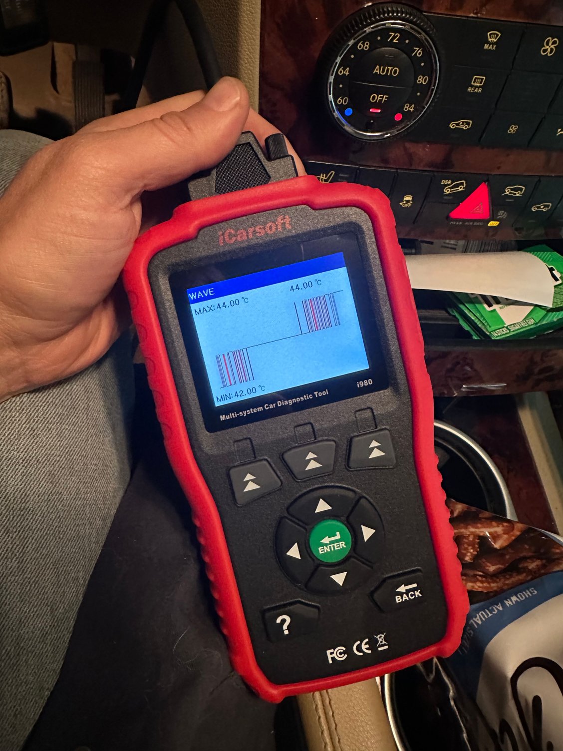

I am still driving the car but a little confused on what to tackle next. I hooked up a nicer code reader to it (icon t7) and I have no active codes. The only thing I can see is that the evap pressure is way out of spec.
Right now I am leaning towards the transmission or torque convert being the problem because I have had a few random clunky shifts. Any ideas would be greatly appreciated. Thanks.

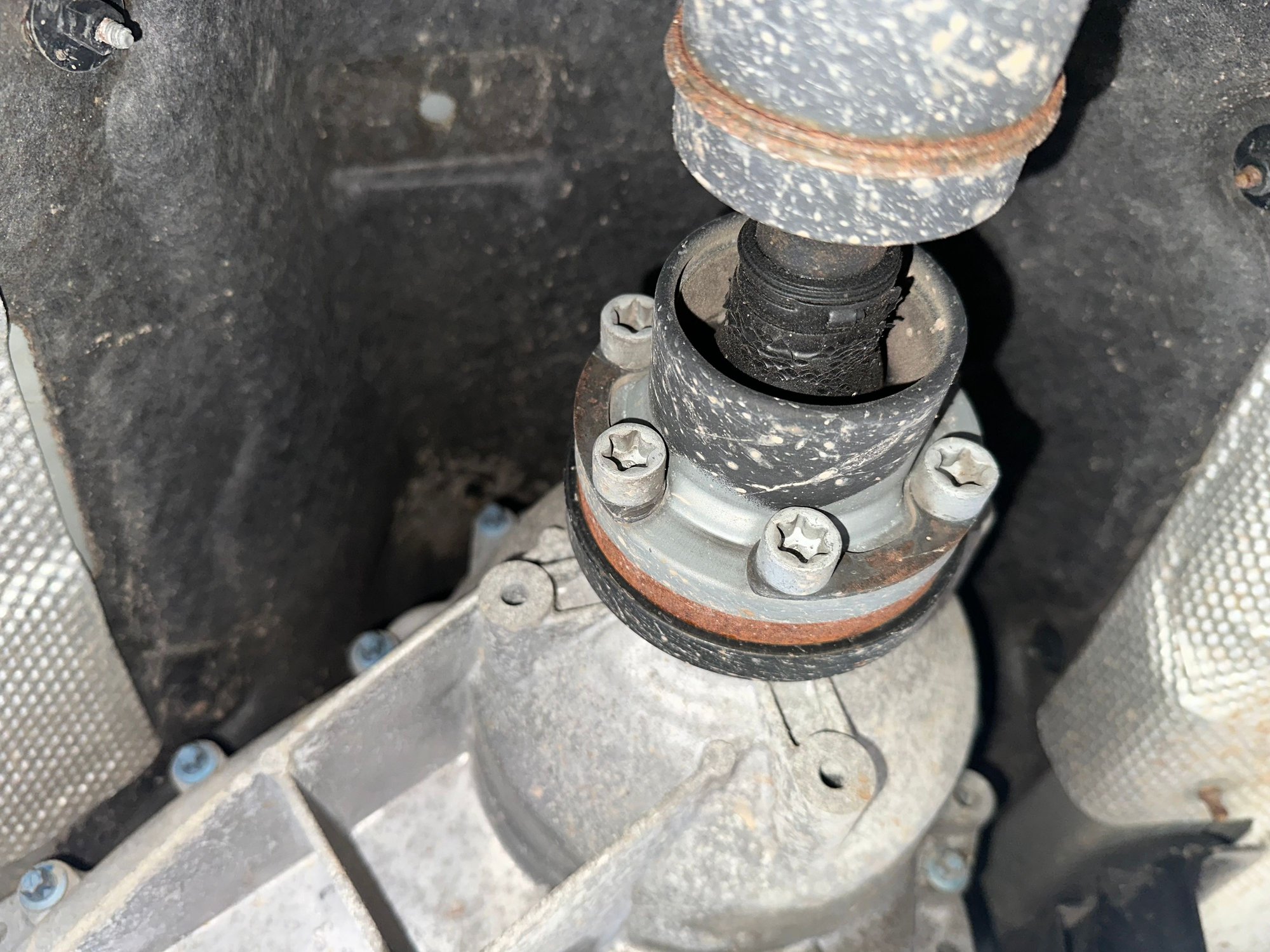

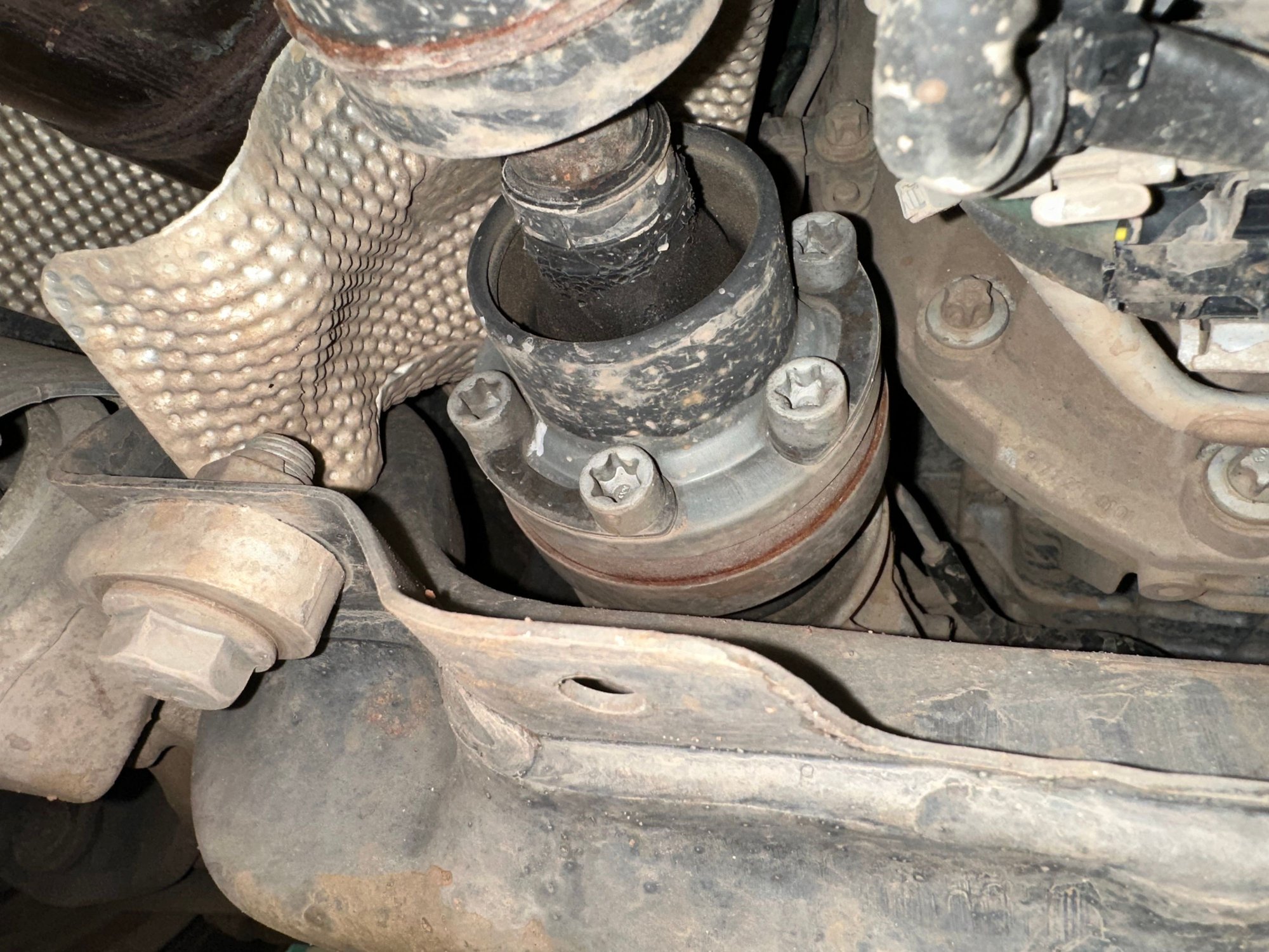

This is either as simple as a cracked giubo in the driveline, or your torque converter going out or locking up when not commanded to
I recommend getting under the car and looking for a cracked rubber disc that connects each driveshaft. These are known as giubos.

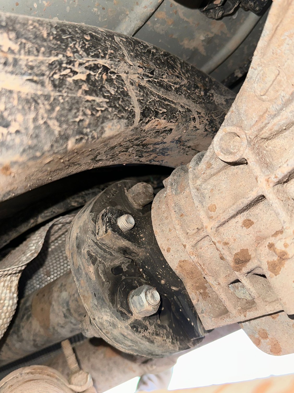

Checked the giubo joints.
I checked the giubo joints and they all looked good. I didn’t see any cracks or threads coming out of them. I did see some oil leakage on the transfer case. Should the transfer case be able to move upwards from the bracket that is below it? I was able to move a transfer case up about 4 to 6 mm from the bracket below it with my hands.
So at this point, I’m guessing that I need to troubleshoot the torque converter. Are there any diagnostics that I can do myself or do I just need to take it to the dealership to get checked out?

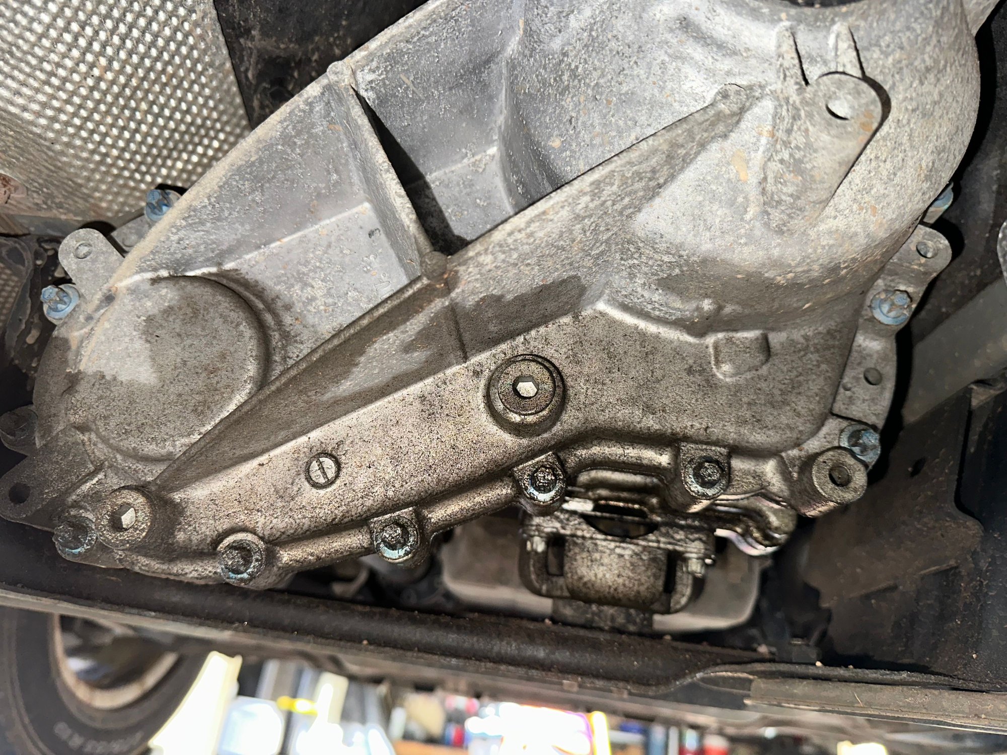

No, the transfer case should not move perceptibly.
While you are in there, check for other things that are visually not correct - perhaps a torn or collapsed motor mount/transmission mount.

Video of transfer case movement
Here is the video (see link below) of me pushing on the transfer case with my hands. Is this movement normal. I wasn’t sure if it is supposed to be hard mounted to the bracket below it. There is relative motion between the bracket and the transfer case.

you seem to be very adapted getting under the car so get under there with a crowbar and attempt to pry. Failed or failing motor mounts will manifest themselves in the engine, moving around when placed under load such as when shifting from neutral to drive or reverse.. You will see the engine move and it will feel rough across the entire spectrum.
I looked at your video. It’s too short and it does not conclusively show at that mount is bad.
So get under there with a prybar and attempt to force it up and down, taking care not the damage the mount any further
The motor mounts in the X164 are not active. Although previous poster meant well, commenting about other Mercedes parts and procedures to a relative newbie such as you is more confusing than helpful.

Checked for play

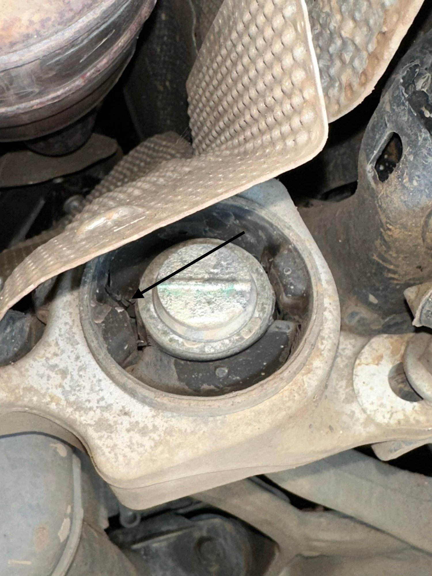

I finally felt good enough to check those few things out:
1. Took a video of the engine movement when shifting from park-drive-reverse. It looked minimal to me. I also looked at the motor mount on the passenger side. Looked good to me. Here is a video of the engine movement. https://share.icloud.com/photos/031u...UHZN2_hVWXR6Ig
2. Looked around at all the joints on the front end. The lower A arm mount on the passenger side is cracked. Doesn’t seem like this would cause my shuddering but I guess it’s just something I’ll have to deal with later. I added an image of this below.
3. Took a better video of the up and down play in the transfer case mount. I only had to apply very little pressure with the crow bar to get movement. It looks like this is some type of rubber mount so I guess movement is ok but it does seem a little loose. Here is a better video than last time. https://share.icloud.com/photos/019M...oTMjzbCU2IRLxA
I did go back and reread all of the input from people on this forum. One of the questions was if I took it to a reputable trans shop when they said the fluid looked good and the level was good. This shop was who my parents used in Pennsylvania but they were not a Mercedes specific shop. Personally I did not really trust them. It just got me thinking. I have no idea if or when this trans has been serviced. Would a transmission flush be a good idea before I go further? If so, is there a good video or thread on this process. I’ve never done it on this vehicle and the lack of dipstick is mind boggling.

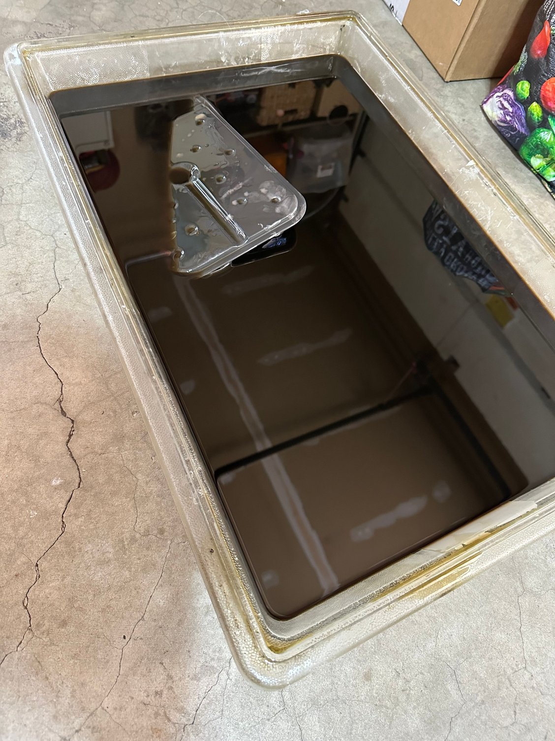

Changing trans fluid
I am 90 percent of the way done with the fluid change. I just need to refill it. I bought the icarsoft scanner that the internet said should pull the trans temp. I also changed the transmount because there was a guy with a YouTube video about his gl550 with a shudder and that was the fix. I don’t think it’s the mount because the amount of motion with the new mount seems the same as the old mount. I’ll let you know if this fixes the problem. I give it a 25% chance but the fluid was pretty dark so it needed to be done anyway. Thanks for checking in.

Update: might be fixed.
I’ve driven it for a day after the trans fluid change and the trans mount change. No shuddering so far but I’ll only be convinced after I’ve put some longer trips on it.
I ended up draining about 8.5 L of trans fluid (by weight) and I put in 9 L and a little bit less than a L came out. I used the Fuchs brand. I was able to use the icarsoft i980 scanner to read the trans temp. I think it was about $100 on Amazon. It was really hard to find the menu where you can query the temp so don’t give up. I’ll give an update in a week or so. Maybe I fixed it, maybe I didn’t, but this forum helped me a bunch. Thanks.
Old Oct 9, 2025 | 12:47 AM
Ddienno's Avatar
Joined: Sep 2025
Posts: 15
2012 gl450
I’m gonna call it a success
with a slight bit of hesitation I’m gonna call this problem solved. I drove the car down a 6000ft mountain from flagstaff to Phoenix and back again at about 80+ mph and I did not feel any shuddering. There was one moment going up a really steep short hill in town where I might have felt something but it may have been my paranoia.
what I learned.
1. dont trust the transmission shop. They just lied to my face and told me my fluid looked good and the level was right. After changing the fluid, I 100% guarantee they never looked at the fluid.
2. people on this forum are helpful. Thanks
3. Mercedes are designed in a very special way. I’m an engineer so I simultaneously understand some of these design decisions while hating them when they break.
