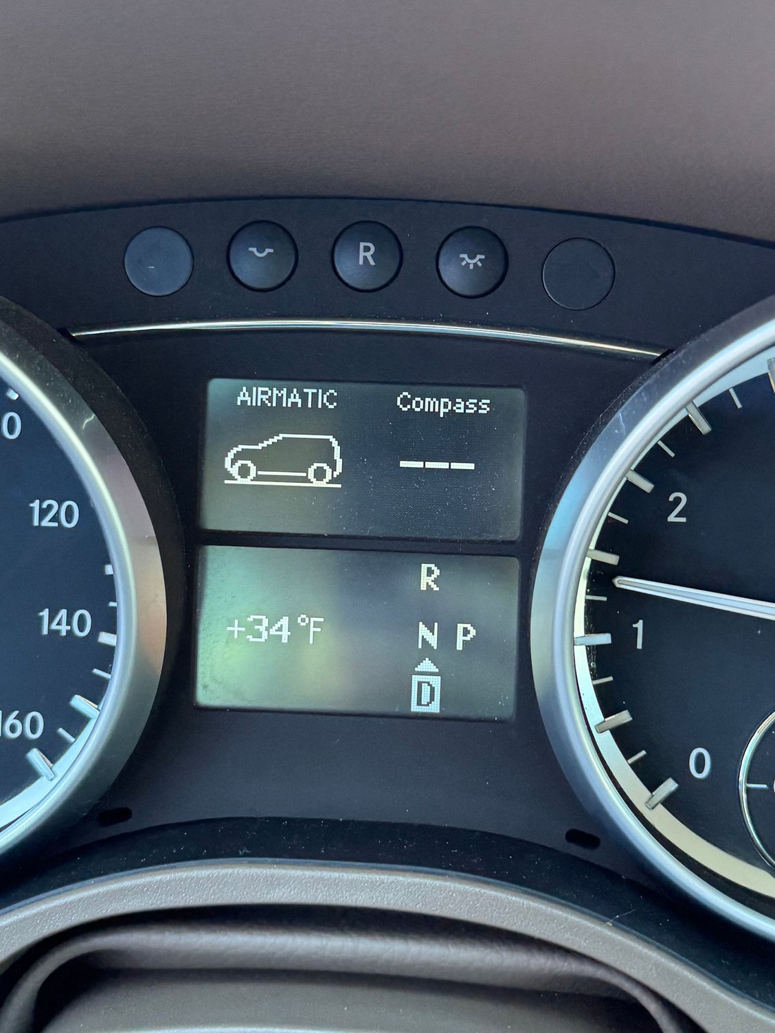

Hi all I have a Gl 450 in the last few weeks on the dashboard. The compass has not been working and when I put the car in reverse the rearview camera does not work then I shut it off and then it’ll work is this have anything to do with the cold or could it be something else? Also when this happens I’m not able to change the radio station from my steering wheel Any ideas? thanks

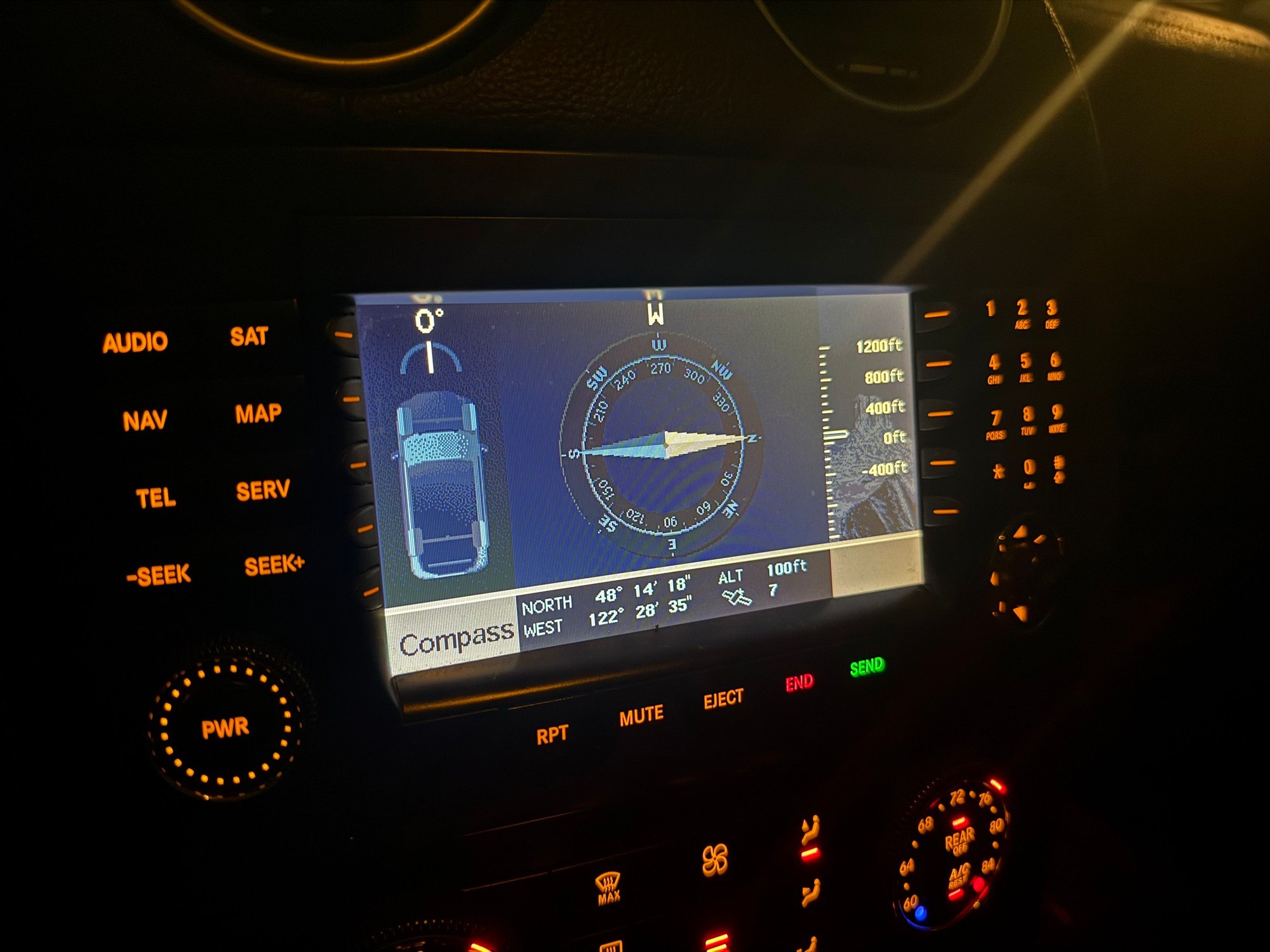

Does the compass work on the command screen?

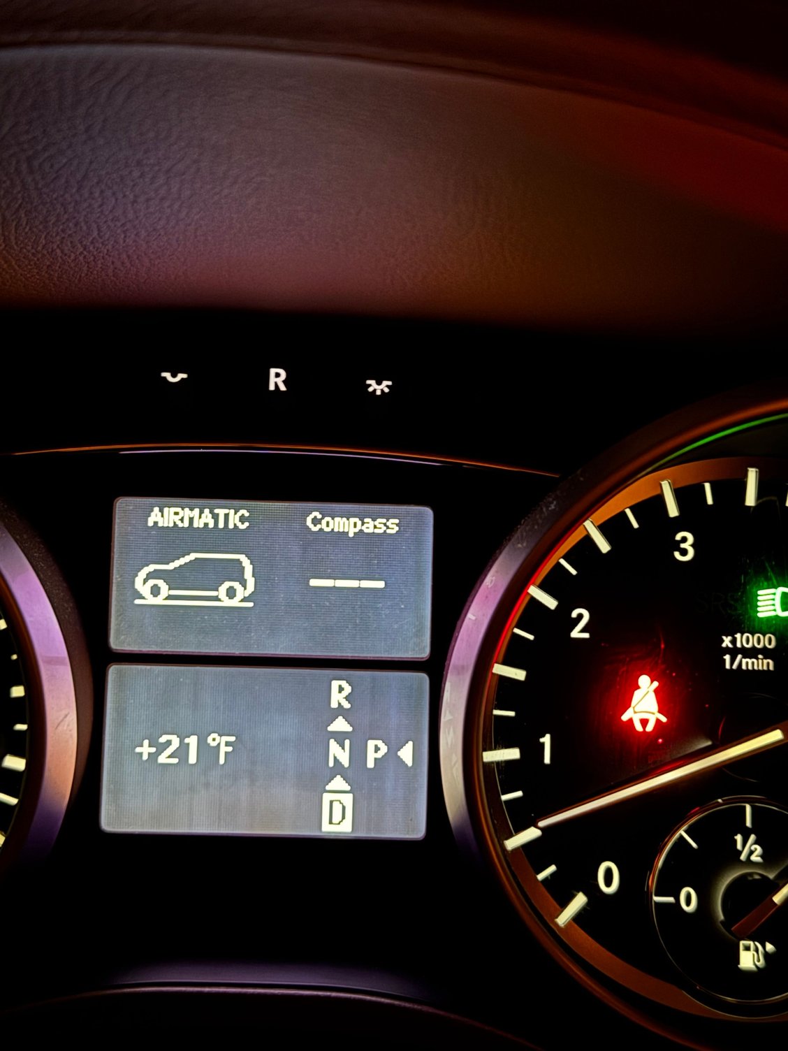

Yes the compass works. But sometimes it just freezes. I wasn’t sure if this could be caused by the extreme cold we have been having

The compass readout in the dash display is just a repeater of the COMAND system screen where you can read out position, exact heading, number of GPS satellites, elevation and steering angle. If any of those inputs are intermittent or missing there, it could help narrow down which sensor or gateway is having issues.

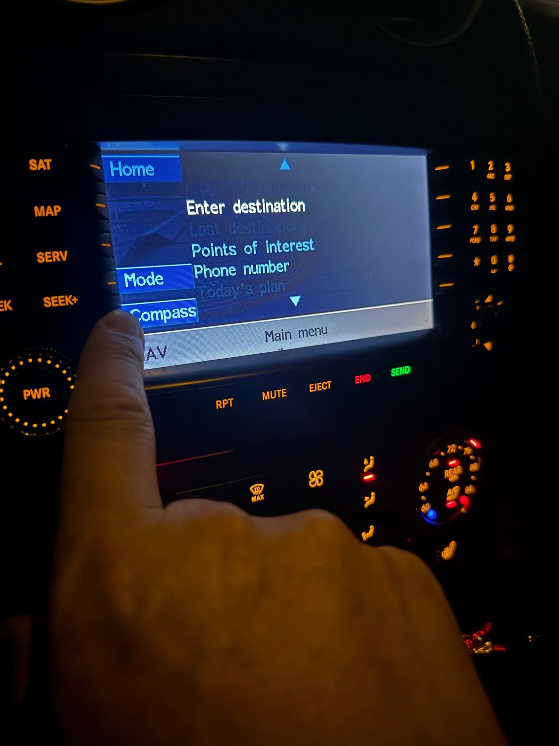

No, no under the center COMAND screen -> NAV -> Compass
There should be a lat/long, elevation, and satellite read out. Confirm that this works.
(I don’t have a degree read out in my dash display because I have the EORP and the diff lock status override that.)
