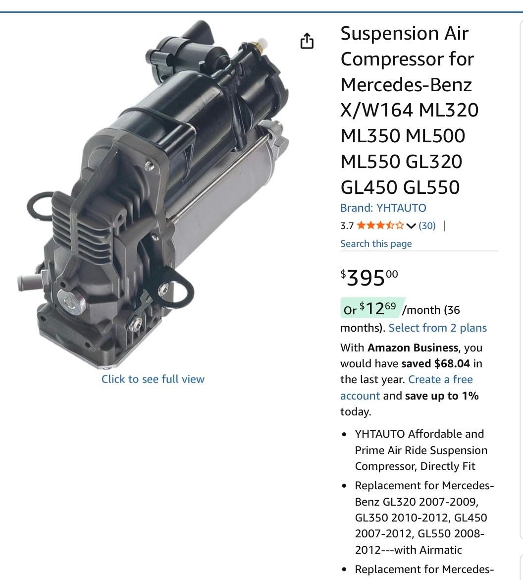

If you get a new compressor, just grab one from Amazon, they are cheap and last long enough. I've had one running with zero issues, so far, for over 5 years.

I checked fuses and relays all good. It appears compressor does run as soon car starts and it keeps running . My. Entrap reservoir is showing 48 psi in scanner and all for airbags are at over 80 psi. If compressor was doing anything I would expect reservoir pressure to go up.. looks like compressor is done for. What Amazon compressor did you use ?

There are cheaper ones on Amazon, but this one worked for me.
