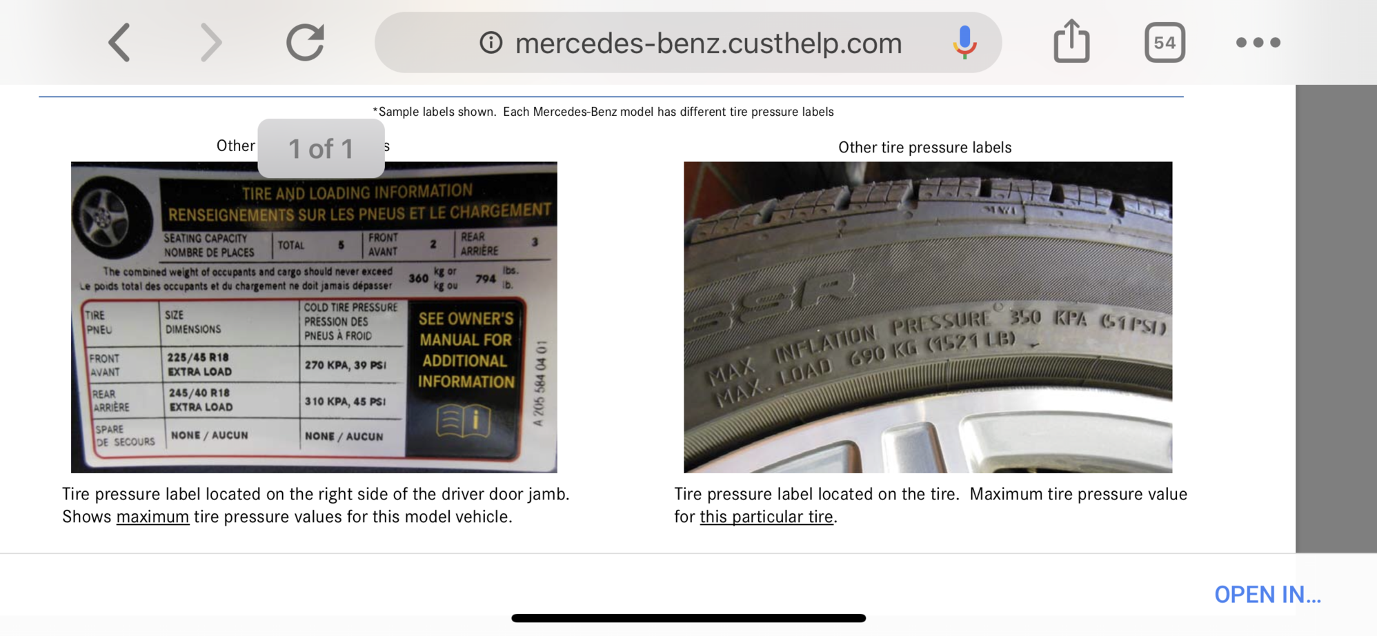

this is mercedes really means w those two dumb stickers

Tire pressure is a compromise. Anything above the lowest safe pressure for the weight carried and below the maximum on the tire sidewall.
32 PSI at all corners is the factory recommend pressure for normal loads in order to give the best ride and even tire wear all around.
