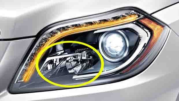

Does anyone know what this part of the light is? I haven't seen it illuminate. Originally I thought this might be the cornering light. Perhaps a sensor? Turning on the highbeams just rotates the Bi-Xenons up.

I had the exact same question and I have spent some time recently trying to figure this out. I do not see the cornering light.
Old Nov 4, 2014 | 08:49 PM
JimBarnhart's Avatar
Joined: Nov 2007
Posts: 1,425
From: Minnesota
2015 Ram 2500, former 2013 GL350, 2007 GL450
I've never noticed it either. In my old 2007 it turned on the inside corner fog light - back when fog lights added light.
Actually I have the same question, found no purpose of these lights. I think it even has a bulb correct?

[QUOTE=Ah_gl450;6221181]Actually I have the same question, found no purpose of these lights. I think it even has a bulb correct?[/QUOTE
This is just a semi-educated guess, but I THINK that what we are looking at is the area where a bulb would be IF the vehicle was not equipped with the "intelligent bi-xe system?"
Old Nov 5, 2014 | 01:20 PM
43221B's Avatar
Joined: Jul 2009
Posts: 814
15 GL550
Okay, it appears this topic has been discussed in the W166 forum. Apparently, what I circled in yellow in the picture above is indeed a cornering light that...get this, is NOT functional in the US.
Below is a thread from the W166 forum complete with pictures and a video toward the end of the thread that shows how the light would function if it were to be operational.
https://mbworld.org/forums/new-m-cla...ng-lights.html
Yup.....that's what I said earlier.

I'm just amused that such a large part of the headlight assembly is non functioning.
I guess Mercedes can't use the cornering lights within the headlight assembly because current Federal regulations mandate that the headlights must work symmetrically. I think we are really missing out because Mercedes is doing some pretty remarkable stuff with these headlights in other parts of the world. I noticed that one of the Mercedes European websites mentions that the headlights go into a fog light mode when you select the fog light switch and the headlights are aimed outward and down toward the lines of the road in an effort to reduce glare and improve the visibility of lane markings.

43221B - I had a 2012 Audi A7 with the LED headlights and they worked just like you state above. The car didn't have true fog lights, it would simply adjust the light pattern as you state. It helped on rainy nights to see lane markings. It also had cornering lights in the headlights, similar to the ones circled in the post above. They only worked below 20 mph when you had your signal on. Again - it was "cool" but I don't miss them. Not sure if it's a federal regulation since it was a normal build for a US destination.
