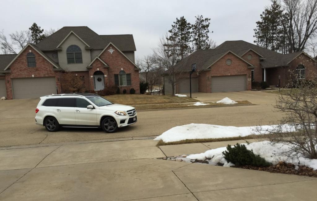

Looking for data on wheel/tire setups on the GL (X166). Maybe this will help others with offsets and tire diameters and widths.
I'm also looking to see if 305/40/22 with offset 49mm will fit a X166 without issues, I know it will on a X164. Not sure if anyone has this setup.
Here are a few of mine that I've run with no isssues:
Offset: 46mm
Tire: 295/40/21
Offset: 46mm
Tire: 295/40/21
Winter Setup with OEM AMG 5 Spoke Wheels painted himalayas grey:
What is your wheel/tire setup on the GL (X166)?-mb_zpsdxwaz1pj.jpg

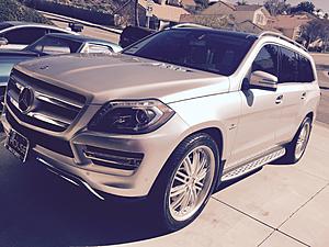

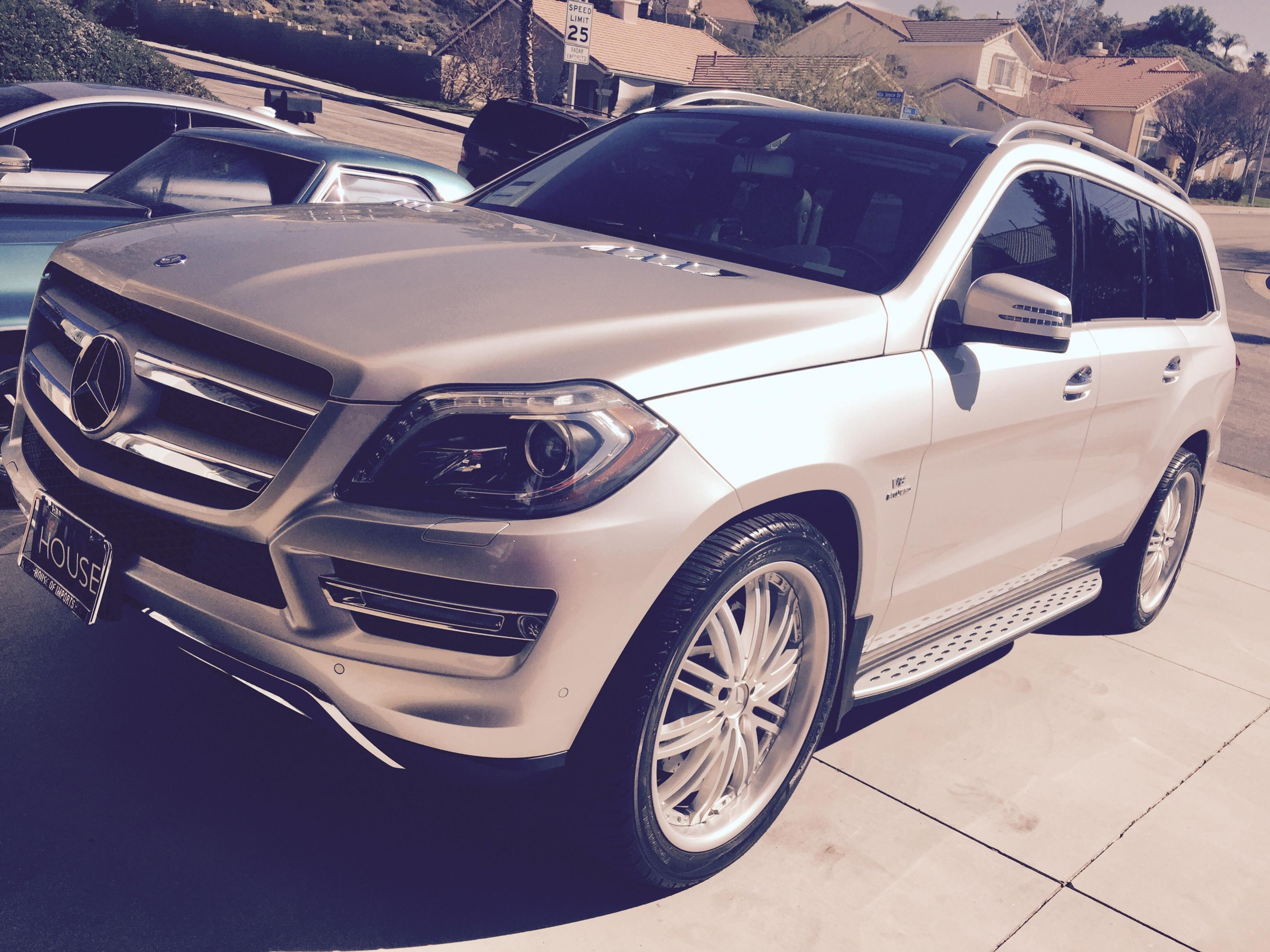

Here is mine. 285/40/22 52mm offset
Attached Thumbnails What is your wheel/tire setup on the GL (X166)?-image.jpg

52mm at what wheel width. Does the 285/40 extend further than the wheel arch?
