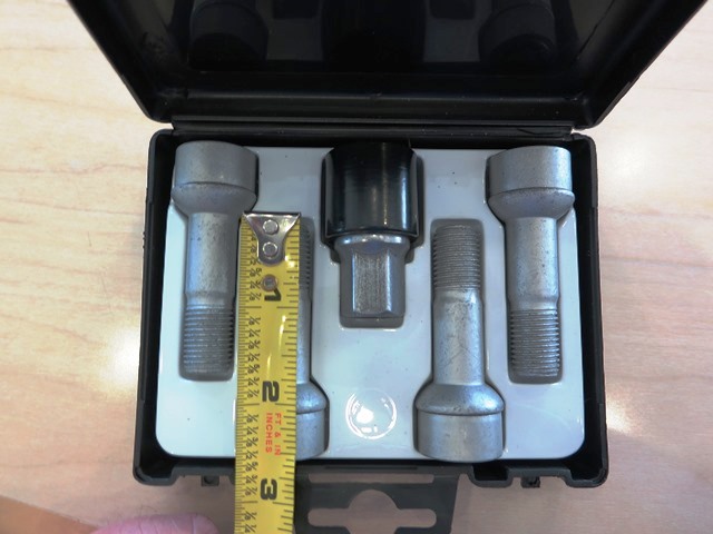

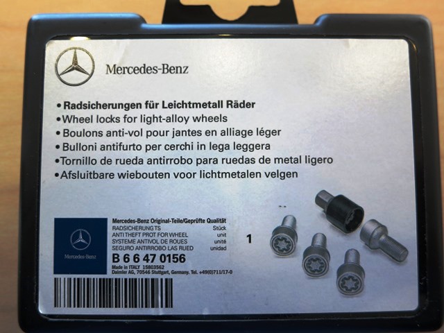

What you need to know...
Under MB part# 6-6-47-0156 (Silver) rim lock set - $127.50 list with dealer net $95 - so that you know the dealer isn't ripping you off.
I have attached 3 photos - the boxed silver wheel lock set with key wrench - comp photo showing measurement - and a shot of the "code #" for this particular set and NOTE key lock code is BOTH the 3-digit large code PLUS 6-digit smaller code.
Hope this helps... keep the beat !
