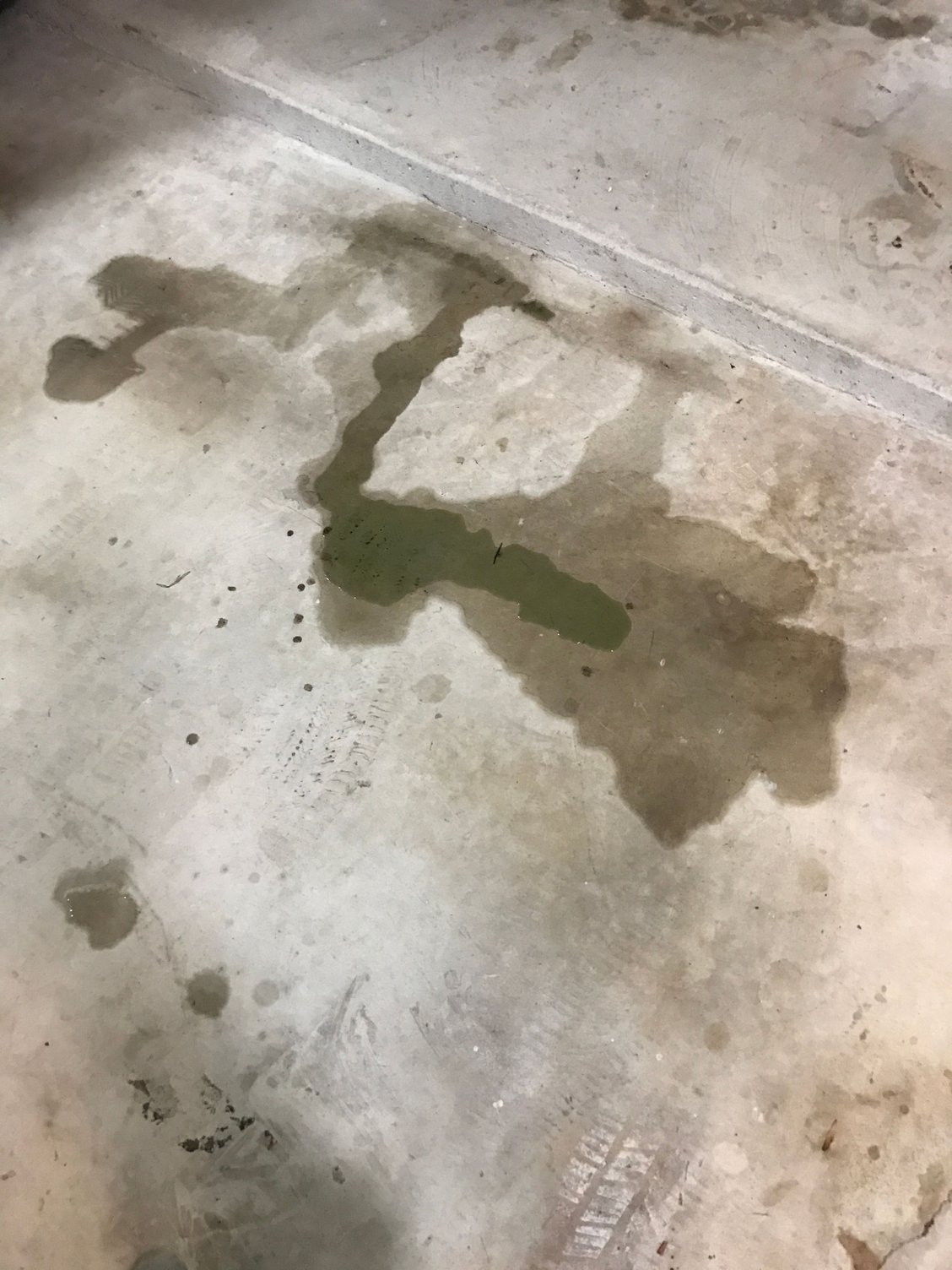

Coolant Leak
Got into the truck this afternoon and had a "check coolant" message. Thought it was odd as we just purchased the 2014 CPO GL 450 which was serviced for the 30,000 mile service early ( truck has 29,500 miles). Did some research and people said it was common that the sensor was pretty sensitive. Well the misses leaves to go out with her friends, and I go into the garage and notice that there coolant all over the ground. Of course I told her to come home and when I lifted the hood it was squirting out of some canister, and there was little to no coolant left. Waiting on tow service now!!!!
Ill keep everyone posted on the problem
