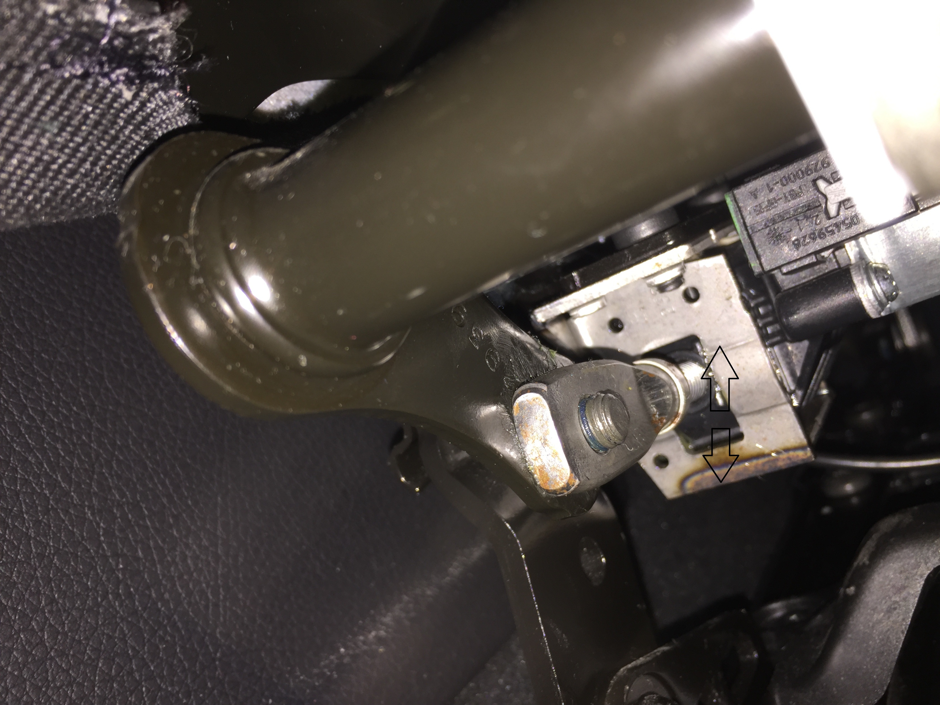

So I've had a look underneath and whilst looking in, used my hand to lift the seat up and down to replicate the bounce whilst driving and the noise seems to be coming from the area in the picture, the rod coming through a bracket arrangement taps steel to steel which I can hear, a lot.
Dealer said without spending any time on it at all that the seat was loose on the frame and they wanted like £2,000 GBP to replace, but I don't think that's it so definitely not paying only to find the problem still exists.
Can anyone help me with a suggested fix?

Compare it with the other seat or to a seat on the same side with an other GL , which does not have the problem.
