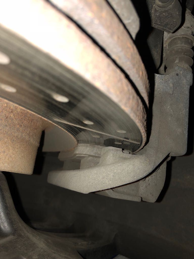

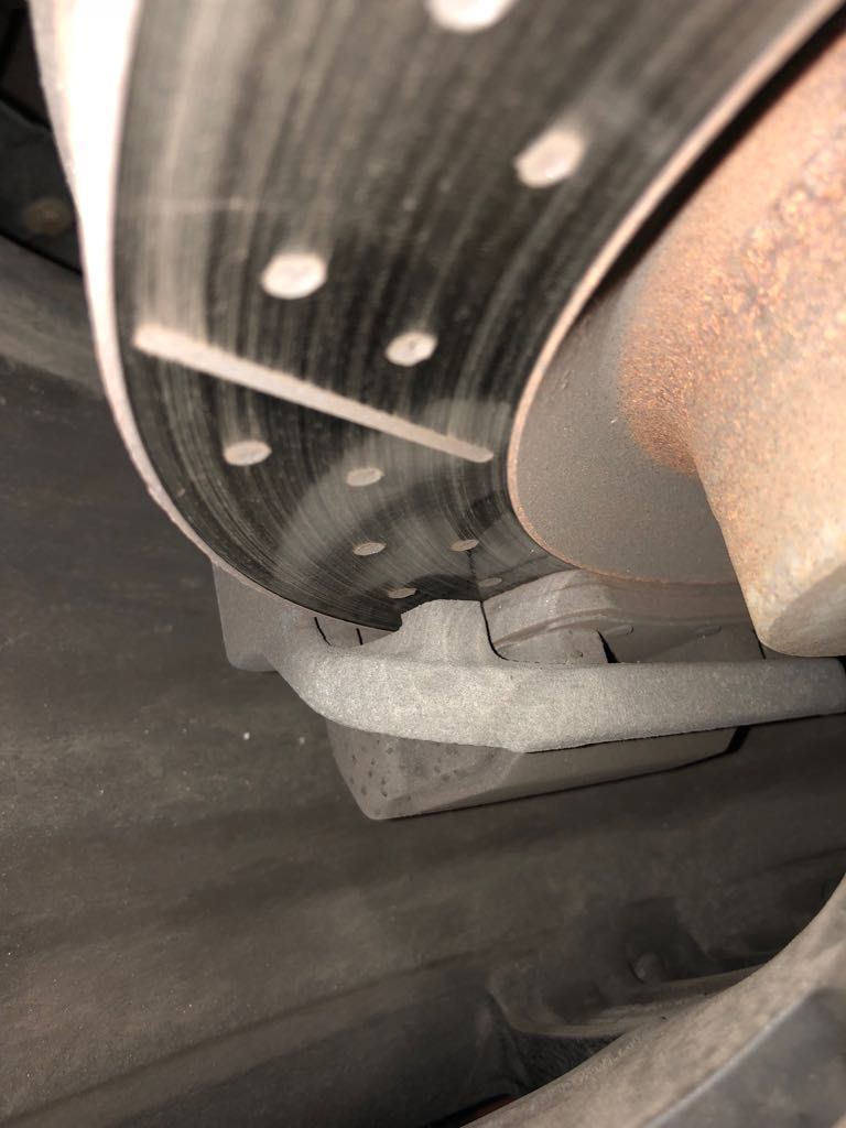

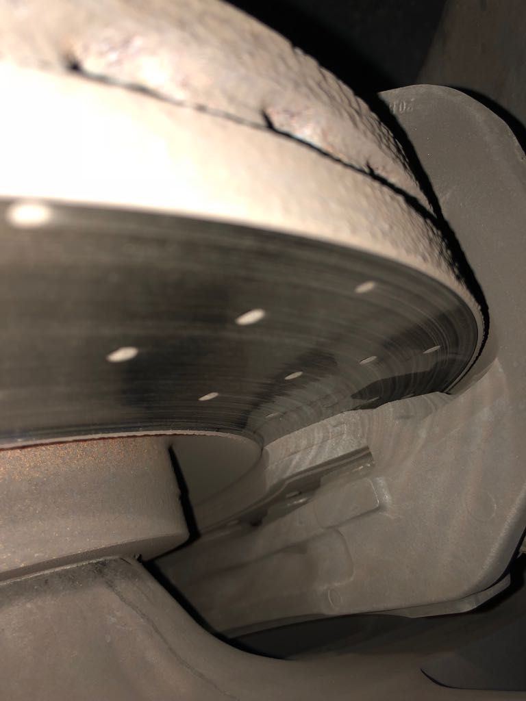

Photo of each corner attached, Im not an expert but think these pads look ok still, can someone please confirm?

By know means an expert, but two of the pics look thin. Not sure what you meant by corners as I only see three pics here. Anyway, there is a wire sensor inbedded in one front pad and one rear pad. When pad(s) wear to the sensor point, it triggers the message. 10k is way too little. I got 27k out of rears and thought that was a bit short, but with all the safety (auto brake, lane depart, etc) I understand rears are activated more often and tend to wear sooner. I switched to a duralast brand to see if I can get more out of them.

told you I’m “no” expert. Now I see 4 pics. Pics # 1 and 3 are the ones that look thin. Other two appear to be much better shape. You may want to verify all four were changed, as you’d have to be a really heavy braker to go through a set in 10k
