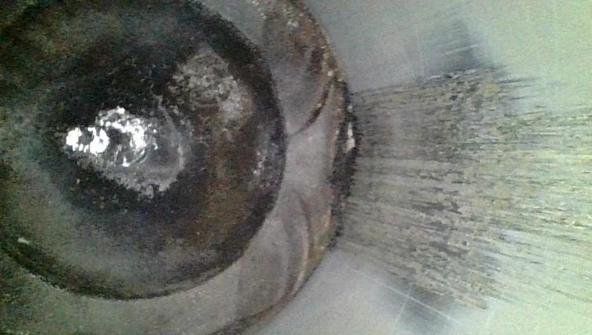

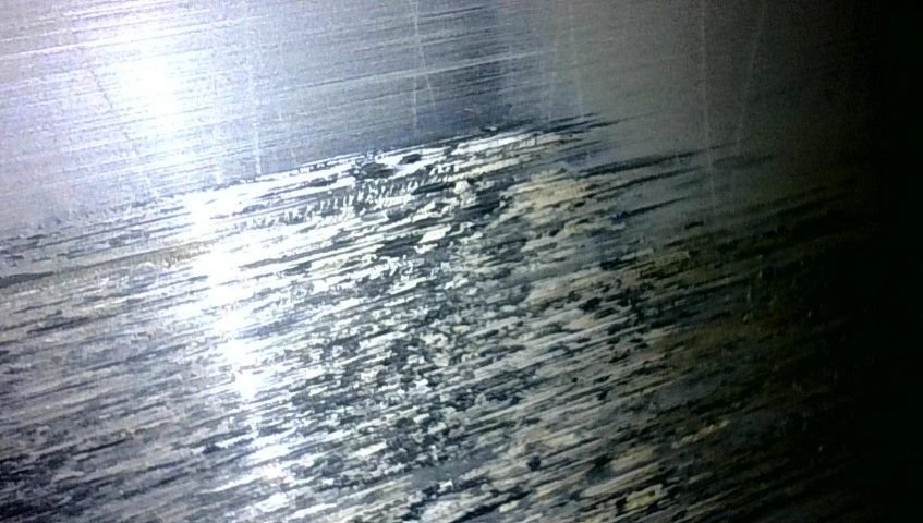

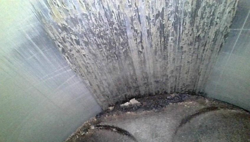

2013 GL550 and 2015 GL63 AMG
No CEL, no codes (using Autel Maxisys Elite), and only slight shake at idle after warmup. However, pulled plug and borescoped cylinder #5 awhile back. Anyone want to know what scoring looks like..here are the pics. Couldn't be more clear that the previous owner neglected some oil changes or overheated this M278. I've been religious about oil changes and have never overheated it.
So, anyone have a used M157 or M278 block I can buy for a good price? I'm not too concerned about cylinder damage on the build block since I'll be building a stroked/sleeved M157/M278 with the stock M278 turbos. Will probably upgrade the exhaust and add a mild tune while continuing to run my 120k mile stock M278 until I swap the built engine over a long weekend.
Sorry to hear everyone else who's had to deal with this issue, especially on lower mileage GLs and GLS models. I guess I can count myself lucky that is still drives fine and has plenty of power at higher mileage
Cylinder #5 intake side scoring
Can you say "deep" scoring?
Thanks, these are some of the clearest photos on this site for the scuffing phenomenon.
