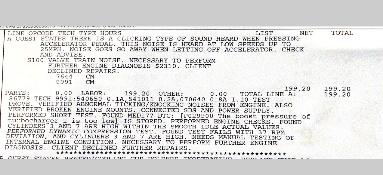

Would the check engine light come on?
I took my GL450 in to the German auto repair shop, check engine light on. It was making a sound only when the gas pedal is depressed. The cost to further diagnose the problem: $2300, which doesn’t fix the problem...could it be the cylinder head?

I took my GL450 in to the MB dealer, no check engine light on. It was making a sound only when the gas pedal is depressed. The cost to further diagnose the problem: $2300, which doesn’t fix the problem...only diagnosis
Not sure what to do...see photo for MB dealer’s write up. Do we diagnose ($2300) and repair to the tune of “thousands” over the $2300 to diagnose? How much will 2 cylinder heads be to replace? It’s out of warranty, so it’s all out of pocket.
others can chime in these approx cost to do something like it. But $2300 just to tell you that you’re screwed and to fork over maybe double or triple that sounds crazy. Maybe try a good Mercedes independent shop with better diagnostic equipment and knowledge.
If I were you, I would get a horoscope and inspect all the cylinders. I ended up replacing my engine due to scoring in 5. Which is common evidently. Long story I can tell you if you are interested.

Thanks. I'm not sure replacing the engine is worth it...no clue on that cost. We did take it to another shop, they didn't have the right diagnostic equipment. I'll try a German specialist to see if they can diagnose the issue for far less that $2300 USD.

Valve train noise - means they want to take off your cylinder head covers and inspect valve rockers and hydraulic compensators. Now if your car is close to 100k - you will have to replace those plus replace camshafts. It is well known wear for this kind of engines. (it is even hard to find used camshafts in good conditions)
Interesting thing is that dynamic compression test cylinder 3 and 7 fail - which are opposite cylinders from left and right banks. Anyway find any regular motor shop and do regular compression test (by pulling plugs and using manometer)
