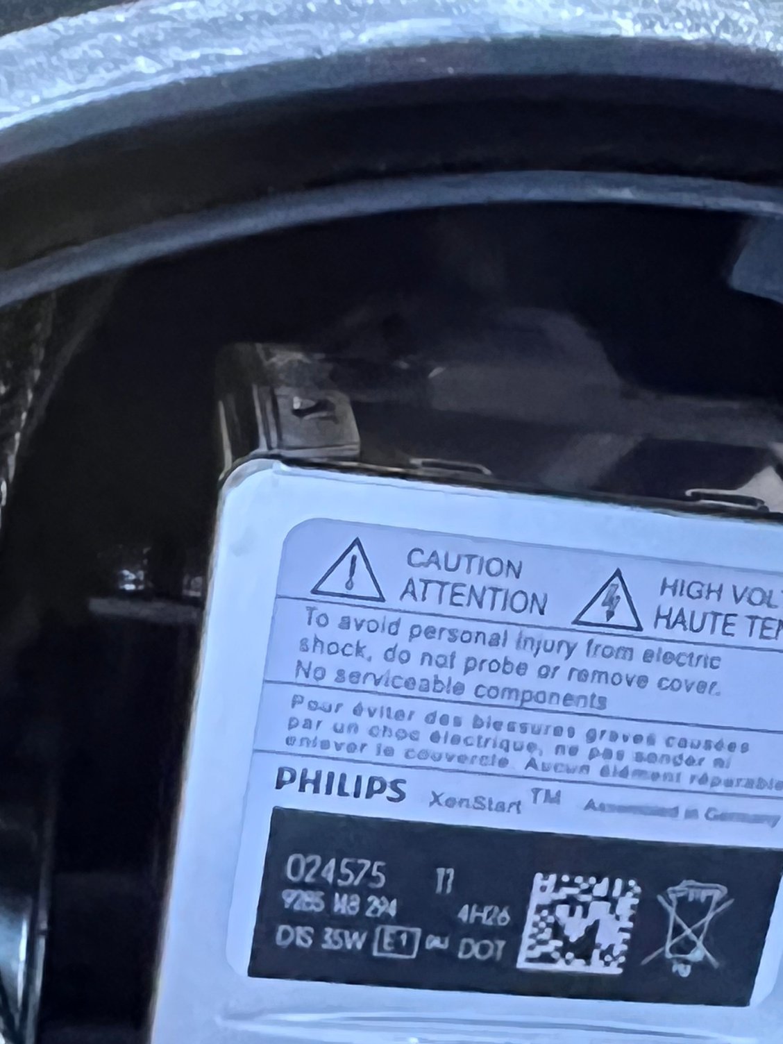

I have a 2015 C350 and I want to replace the bulbs to a higher end bulb (basically want the more whiter light) it doesn’t look like I can change the bulb bc the screws are on the inside of the headlight housing. It appears I’d have to take the headlight apart to do so. Trying to avoid this. I don’t have the two little metal clips holding it in.

looking a the crap pic I assume that’s the igniter that connects to the bulb. There should be a few wires connected to it that will disconnect when you twist off the igniter from the bulb.
then swap in the new bulb
connect wires to igniter
connect ignite to bulb
best bulbs to get what you need are the Osram Cool Blue Boost aka Osram CBB. I use them in my E55/GLS63 and old Rover. Cheapest place to get them is Amazon for about $120 a pair. You need D1S from the looks of the pic. Now the lens and bowl of the projector can play a part too.
The bulbs on the GLS are much improved but they don’t rival the all new headlights and Morimoto EVO projectors is swapped on my E55. Or the Rover that simply got a new lens and spacers. Doing that all involves opening the headlight and you likely don’t want that.

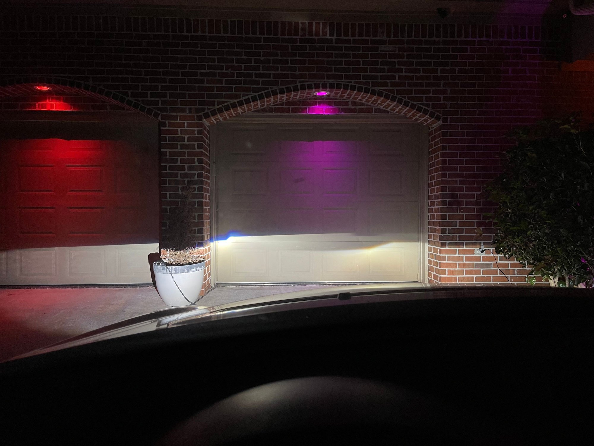

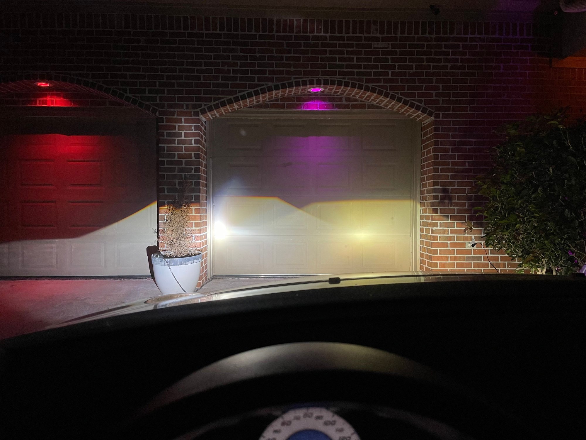

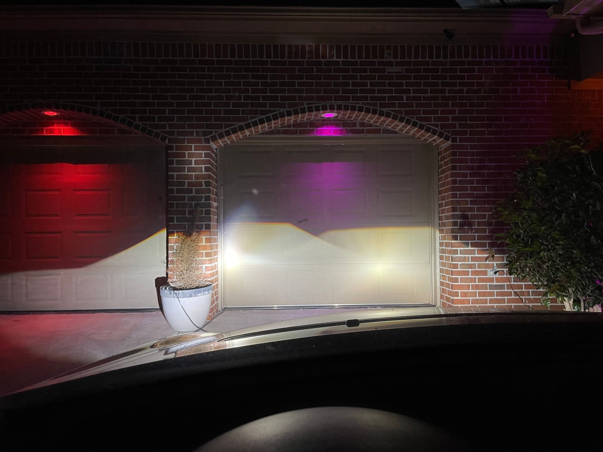

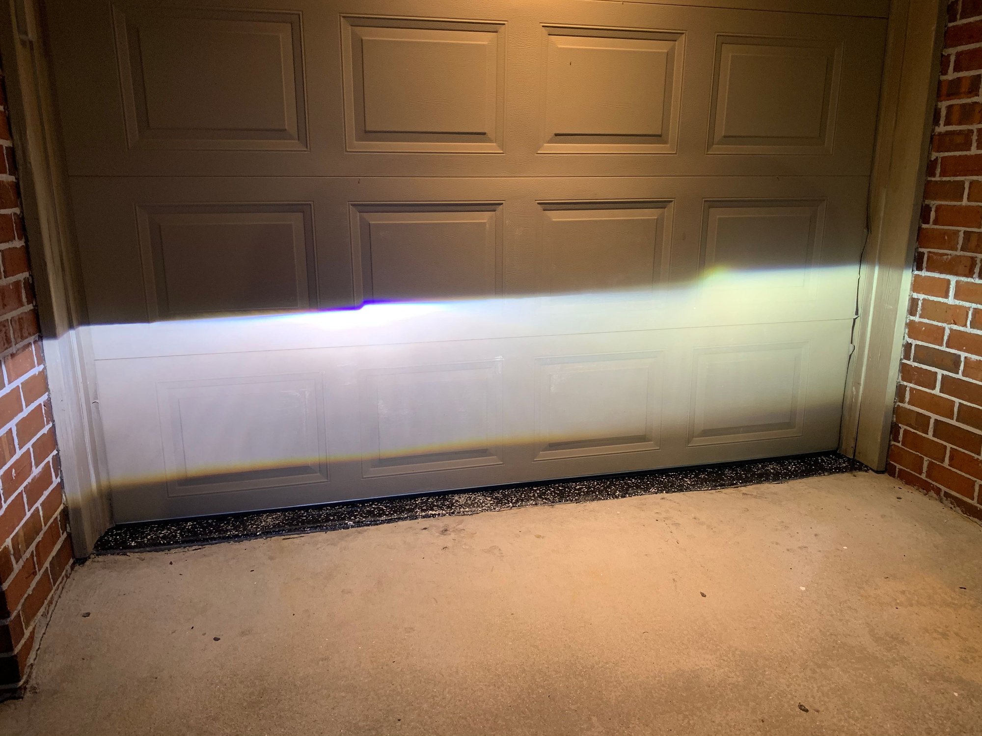

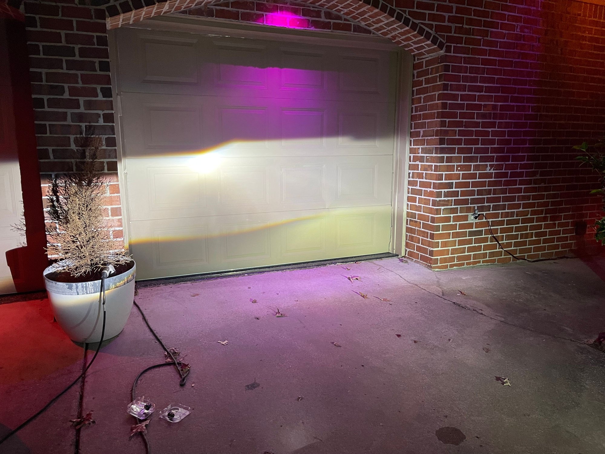

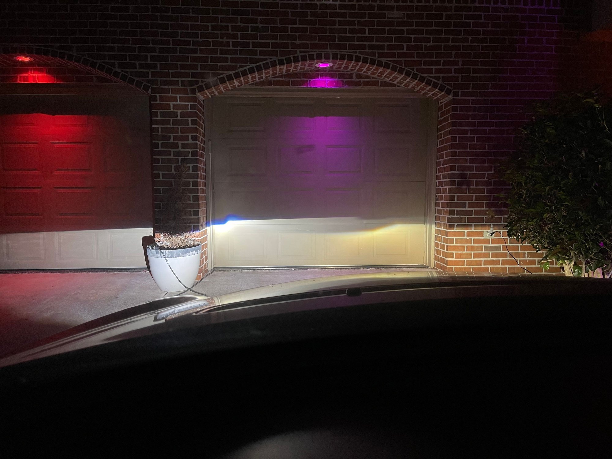

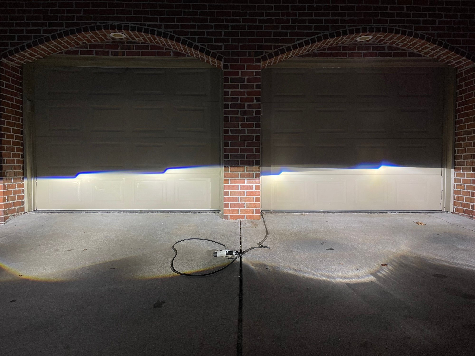

However a few pics but none of the GLS63 but I can get some tomorrow but they won’t compare stock vs CBB.
Rover with CBB and clear lens with spacer vs stock.
New E55 stock vs old E55 stock
E55 CBB and EVOs vs new stock
High beam E55 CBB and EVOs vs stock
E55 CBB and EVOs vs stock With CBB
High beam E55 CBB and EVOs vs new stock with CBB
One is G63 LED vs E55 with EVOs and CBB Can’t tell a diff now at all. G63 left and E55 right
