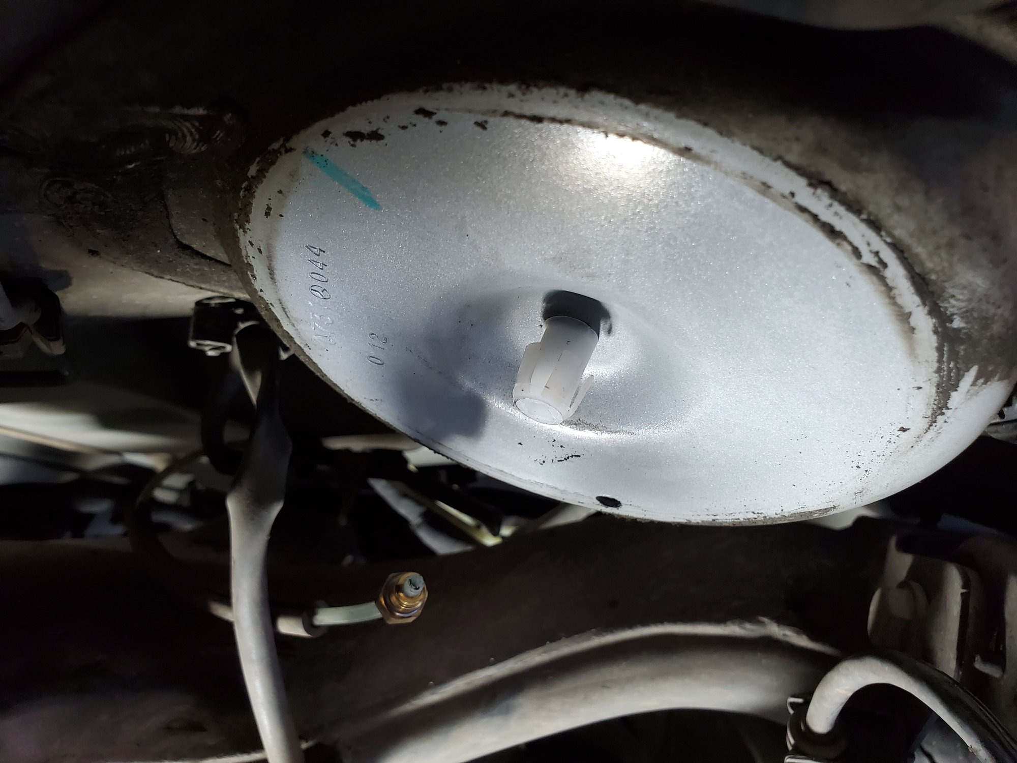

Here's what it looks like?
I decided to change my airbag because I was switching out my Winter tires to my all seasons. The process is pretty easy; easier than a rear brake job. There are no bolts involved (after removing your rear wheel).
You will need to a 10mm crescent wrench to remove the air tube at the rear top center of the airbag (I let the air out slowly because I couldn't remember the process to stop the air suspension from activating while jacked). And make sure you use those jack stands!
You cannot see it in this pic but this is what the airbag looks like on your vehicle. Note: I'm not replacing the struts, only the airbag.

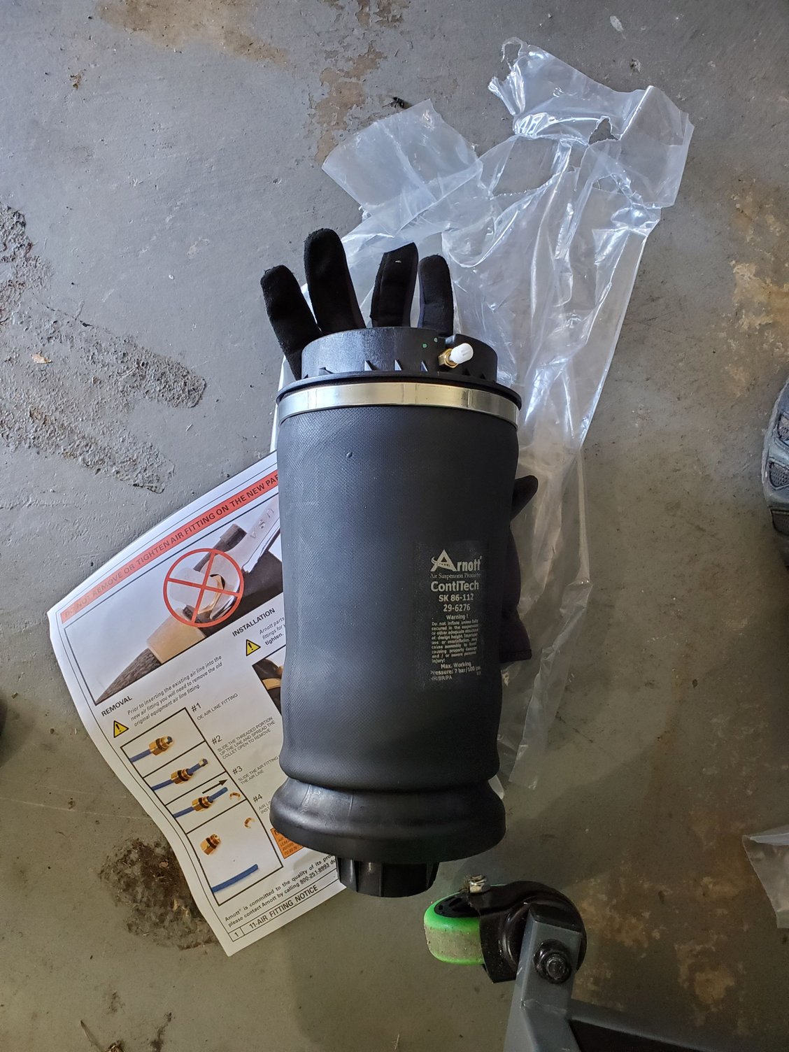

After I removed the air hose, I simply compressed the air bag and pulled it out from the bottom. At the top there is a white grommet(sp?) that holds the top in place at the center of the airbag. Note: I ordered an Arrnott replacement airbag and it came with a new grommet.
Here's what the grommet looks like once I replaced it (screwed old one off/screwed new on on). You can also see the remove hose with the copper/gold fitting still attached. Per the Arnott instructions the fitting is to be removed complete as it will not be necessary on the new Airbag. (the fitting is built in, just insert ihe hose and give a quick tug to make sure it stays in place)
After the fitting is removed and your new grommet is screwed in, compress the new airbag and install in reverse order. ensure the hole for the hose is facing the same way the original airbag was so that you can attach the hose. Be mindful of that center grommet as you align the airbag, as well as the rubber damper that aligns at top of the airbag.
After I seated everything properly, I put a few bolts on the wheel and opened up the drivers door to activate the air suspension but it only raised the front. So I ended up starting the vehicle and the entire vehicle leveled out.
I haven't driven it yet, I just moved it from one set of garages to another to park. The air has held for the last few hours so I assume its good to go. I've done this process on my 164ML on the exact same side. The x166 seems slightly easier to do though (maybe because there is more space to work).
My symptoms were the occasional sagging overnight and guaranteed sagging after using sport mode or spirited driving on back roads in comfort mode (which automatically kinda puts you in sport mode). I had the replacement for over a year but dreaded attempting to repair this it as I could not find instructions for x166 airbags.
