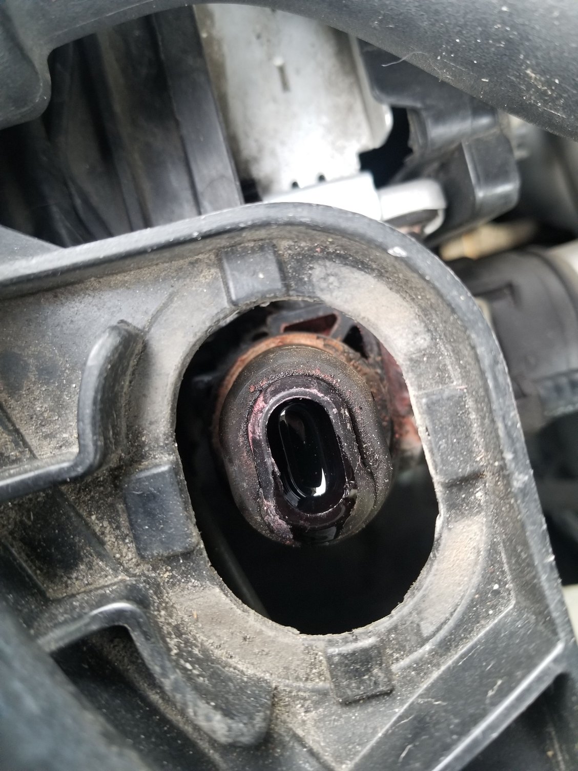

Driver side radiator mount.
So, under the plastic cap mount that holds this together, I finally found my leak. Send like it is coming up from here. Never seen that before. It is also a very slow, slight leak. Definitely some odor in the cabin of coolant.
Has anyone found a good writeup of replacement? There is some patchy info on YouTube, but nothing cohesive. Or, is it straightforward?
Thanks
Old Nov 7, 2021 | 09:36 PM
chassis's Avatar
Joined: Sep 2018
Posts: 14,696
Likes: 4,587
From: unbegrenzt
2017 GLE350 4MATIC
The solution is a new radiator, correct? This failure has been posted on this site before, I don't recall which vehicle model/year. Probably model year in the 20-teens, just a guess.
Old Nov 8, 2021 | 08:32 AM
silvergl's Avatar
Joined: Oct 2018
Posts: 255
Likes: 77
From: New Jersey
GL 450
Leak
That, is my plan, i ordered one from FCP. Pretty inexpensive for OEM. I will keep digging for more replacement info. That seems like a really odd place to leak. I hope it does not blow up on me the next couple days.
Old Nov 8, 2021 | 09:14 AM
chassis's Avatar
Joined: Sep 2018
Posts: 14,696
Likes: 4,587
From: unbegrenzt
2017 GLE350 4MATIC
It leaks because of cracks which develop near the plastic clip you removed. The radiator is held in place by the feature which fits inside the clip, so the perpetual vibration and shock loading of the radiator against its attachment is carried through the part which cracked.

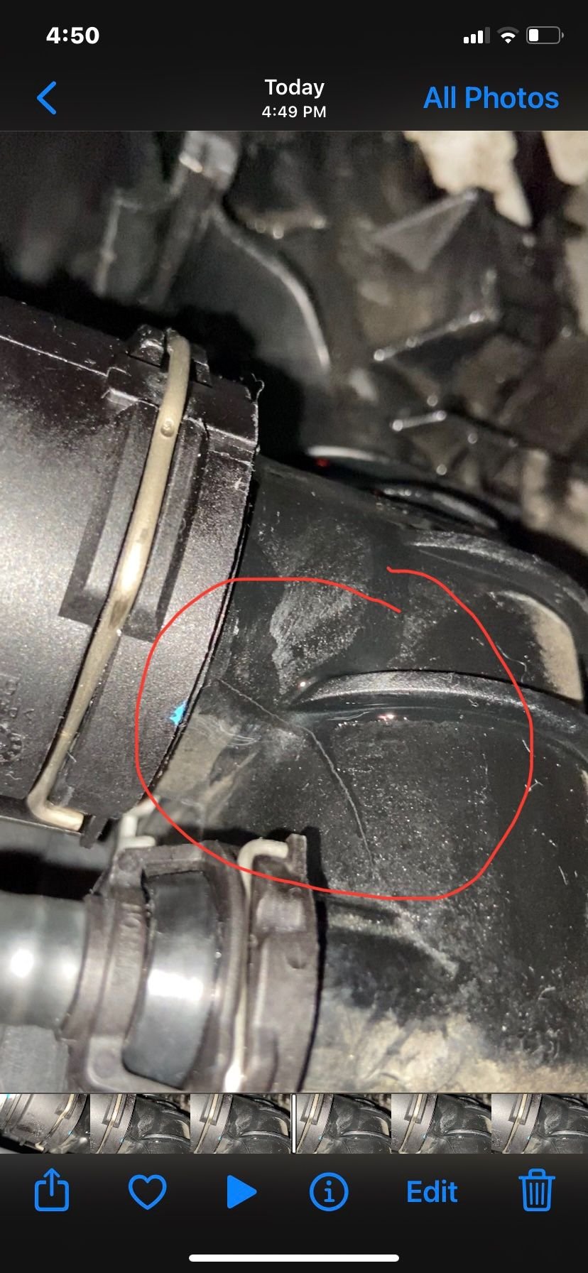

I literally just had to order a new radiator today because coolant starting blowing out the plastic part of the radiator on the inlet right underneath the windshield fluid tank. I first thought it was the hose and replaced the hose only to find out it’s the plastic. I got the oem radiator part number 099-500-46-03 ordered and should arrive in a couple days… I looked at after market ones but feel like there has to be some reason sacrificing quality why they are half price. Dealer quoted me $800 to install the radiator, but would love to do it myself and save the money. I found a YouTube video where the guy took off the bumper. However it was the model before the x166. So any advice looks like it would help out a few members on here.

This is my crack…. I looked online and they make a plastic welder made by Polyvance specifically for fixing radiator plastic. Every time I try to take a shortcut usually ends in disaster. Will start the project Friday afternoon. Best of luck to you as well.

These type of cracks mean your engine mounts gone. Check engine mounts
