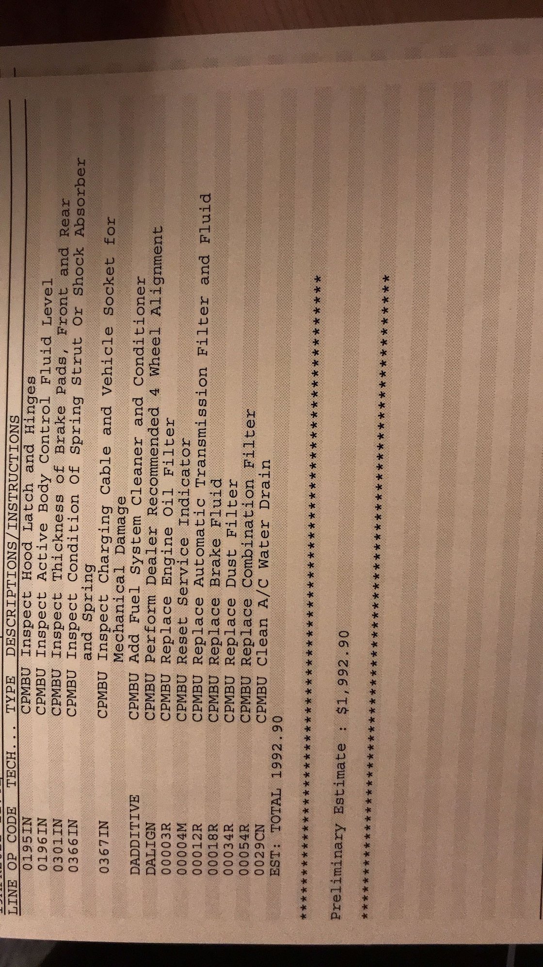

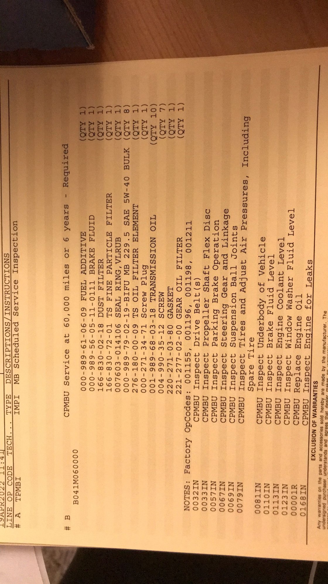

How much 2015 GL450 60000mile service B?
Usually expensive like this?
just some replace and mostly is inspect?why so expensive?

Did you have all the work done or is this a quote?
skip everything but:
engine oil and filter
transmission service
cabin dust and combination filter
brake fluid replace
I would add engine air filter and spark plugs replacement if you haven’t had them done already.

Thank you answer my question sir
It's just a quote.
You mean just tell them do
brake fluid replace

Yes.
