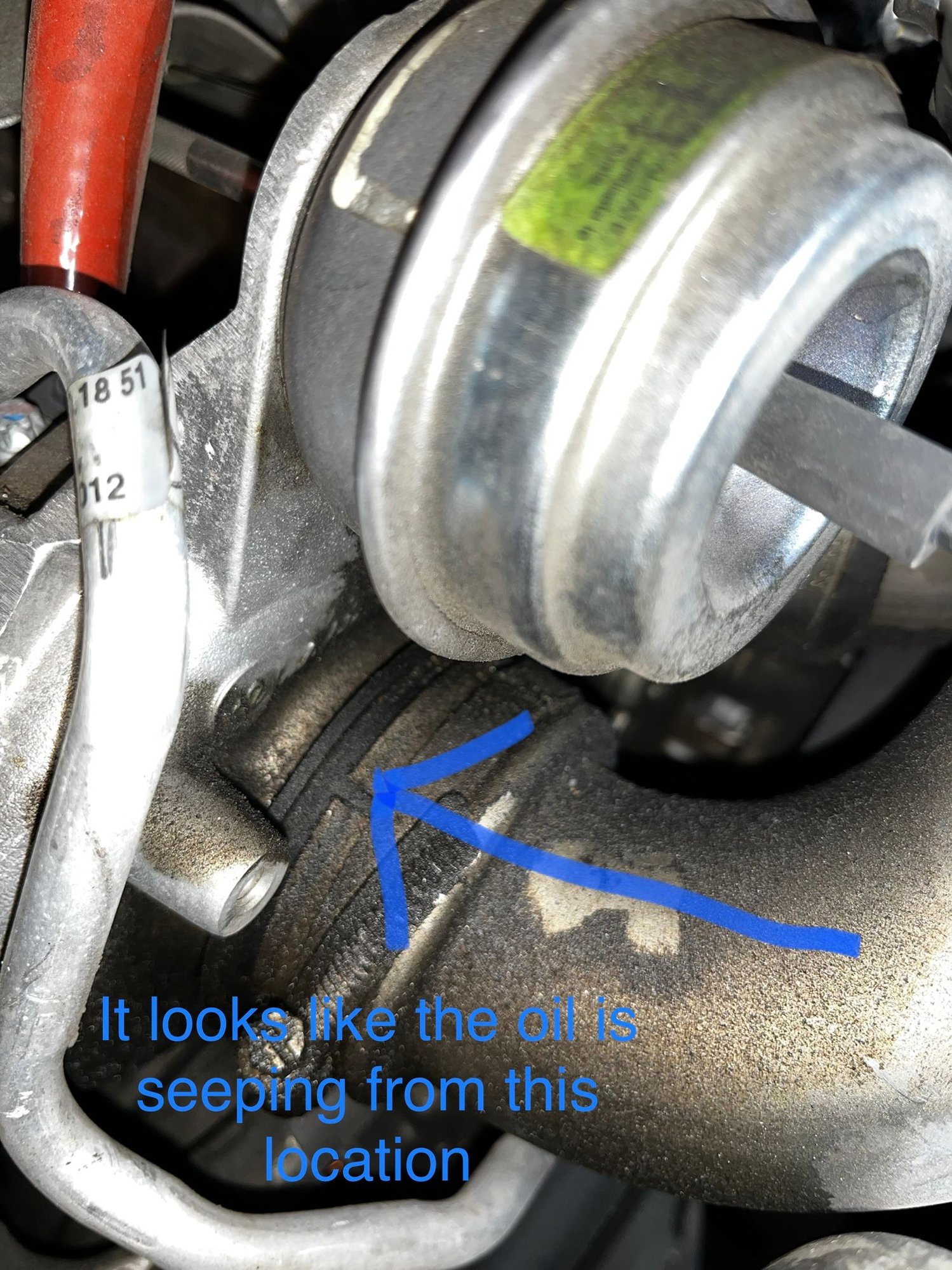

Can anyone tell me what the oil leakage could be caused from that is on the outside of the aluminum air charge duct that’s downstream of the engine filter? Thank you everyone in advance.

Turbo, head cover leak, front cover leak under cam magnets and etc. Wash it and observe.

I think you have more than one leak.
The first couple of photos show the common front cylinder head cover leak. Easily fixable by dealer or indy.
Last photo shows an active and more serious imo leak. Could be turbo oil supply.
Agree with cleaning all of the oil away and watch it closely,
