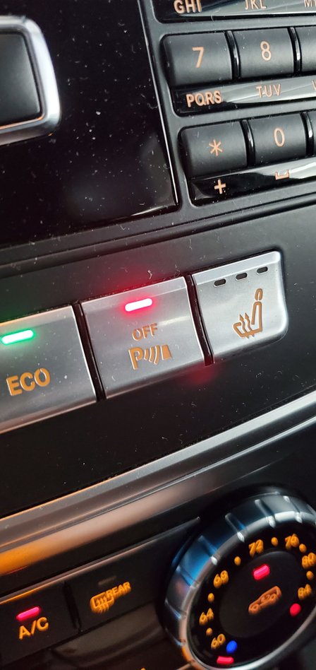

Hi All,
Proximity sensors stopped working. When car is turned on the bars on the dash flashes with 2 bars on either side then goes off. The P button on middle console glows red. Any idea what's going on?

Sorry to hear about this, you might want to connect an OBD scanner and see what code(s) it throws and which sensor is causing it. PARKTRONIC likes to shut off the whole system when one sensor is not willing to work which doesn't help with troubleshooting.
