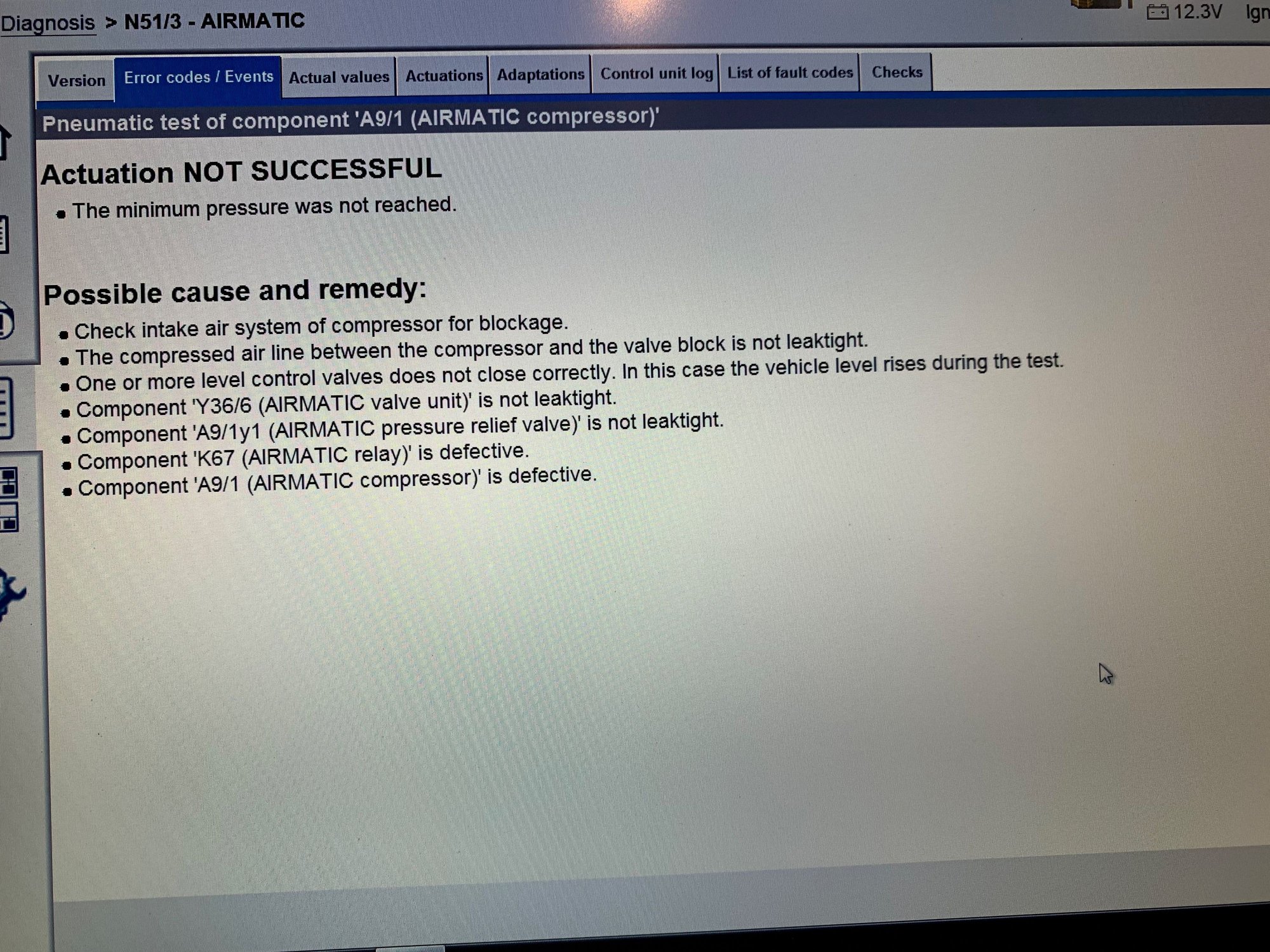

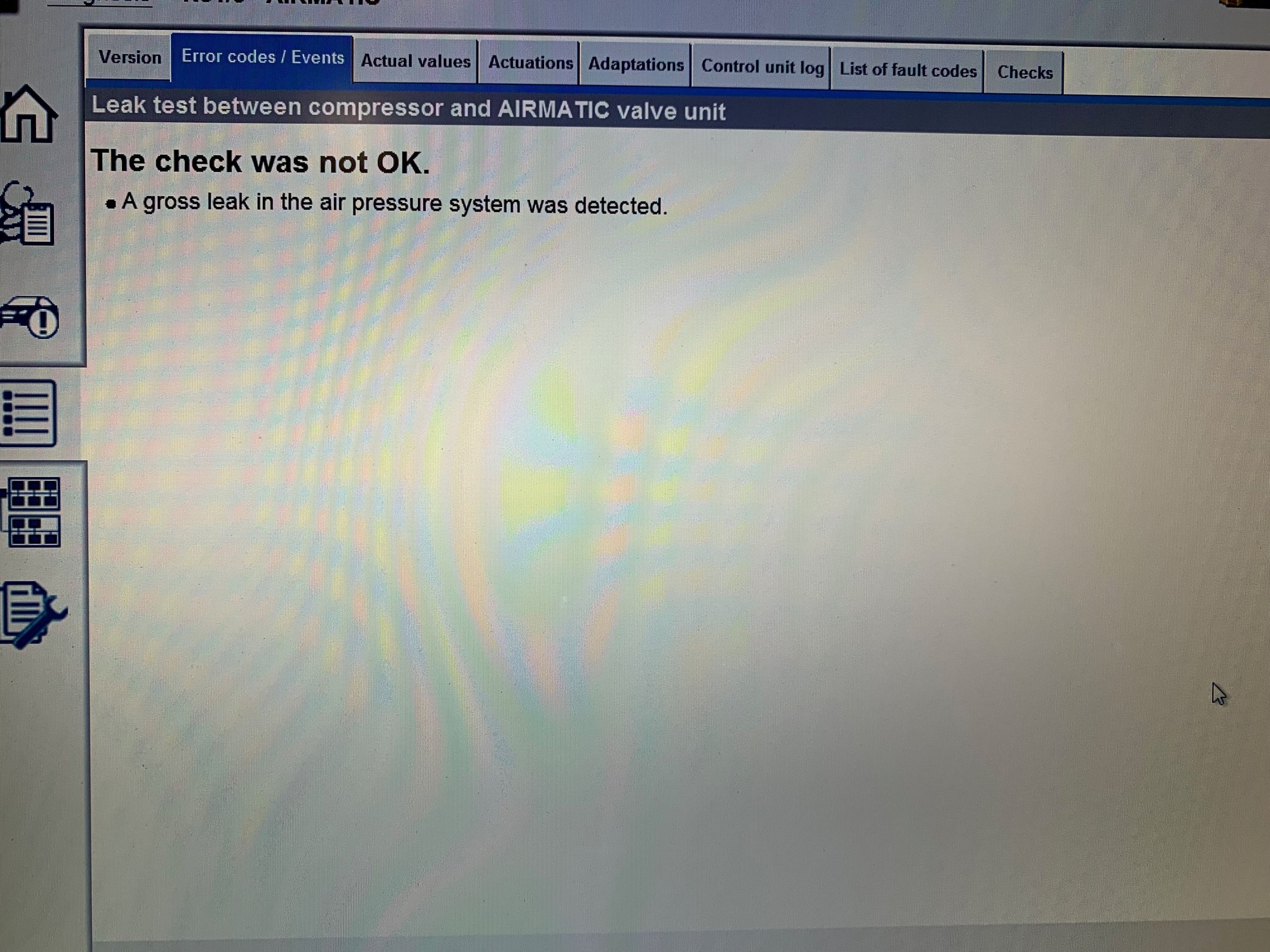

So I was able to successfully run Xentry and found several error codes stored. Running some of the tests I received a failure indicating "gross leak in the air pressure system" located between the compressor and AIRMATIC valve unit. Further tests narrow it down to the compressor, control valve, or line between the two (separate pressure relief valve test showed that was acting normally, the vehicle did not rise during the test ruling out the level control valves, the compressor turned on so the relay should be OK, and pressure is made so the air intake should be fine). While observing the test, the pressure built quickly to 60-70 psi, but could get no higher.
As this issue seems somewhat intermittent I am leaning towards suspecting the valve unit. I know those seals inside the valve can fail to seat sometimes, and since they move I know the seats can sometimes seal, sometimes not. I would suspect a leak in the system somewhere else would suggest a non-moving part?
Some of the error message screenshots are attached. I would appreciate any feedback on how to test these components or previous experience.
Leak test between compressor and valve
Pneumatic test of compressor
