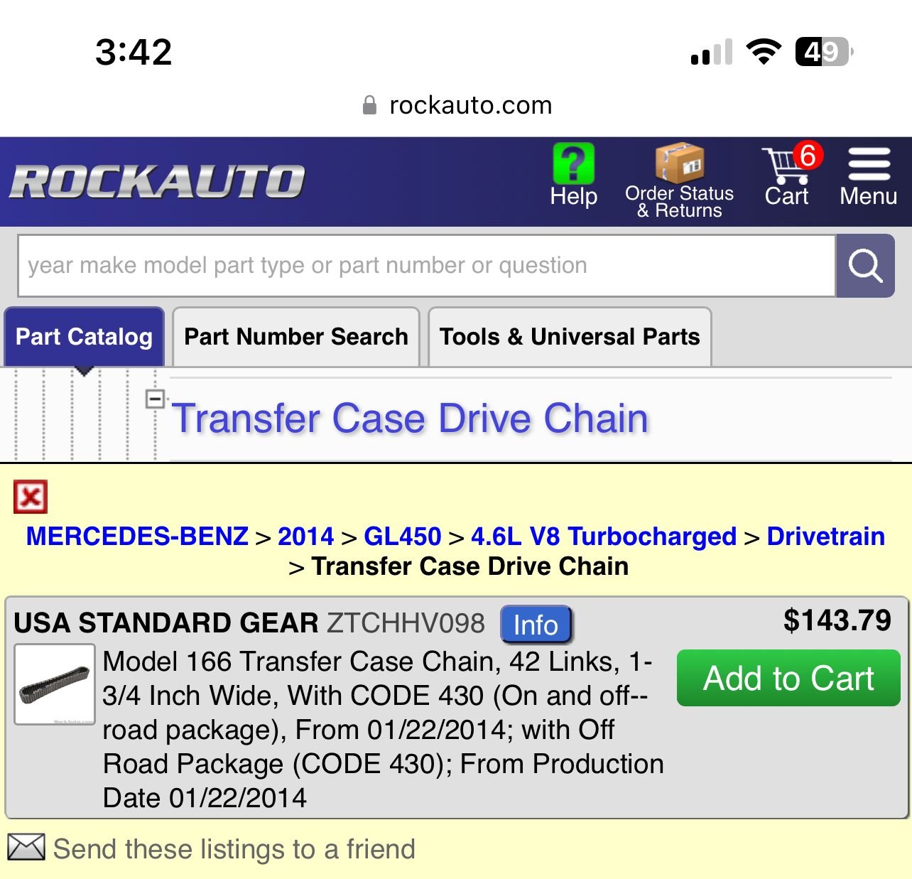

Looks like on quick look the chain is the same for reg or off road. We replaced only the chain in our tuned 550. Took my buddy at best an hour to pull out and back in. No issues in over 20k miles or more in the last 2.5 years
i used this chain from Amazon
labwork GearTransfer CaseChain A2512800900 Transfer Case Chain Fit for Mercedes ML & GL & R Series 2003-On Transfer Case (HV-091) https://a.co/d/e84Mo7n

Thanks but seems to be only for 2014-2019 GL/GLS per the Rock Auto site. When I pick the 2013 year, they don't show a transfer case chain at all. I'm not a DIYer so hesitant to play around with different year parts since the car at least runs for now.
