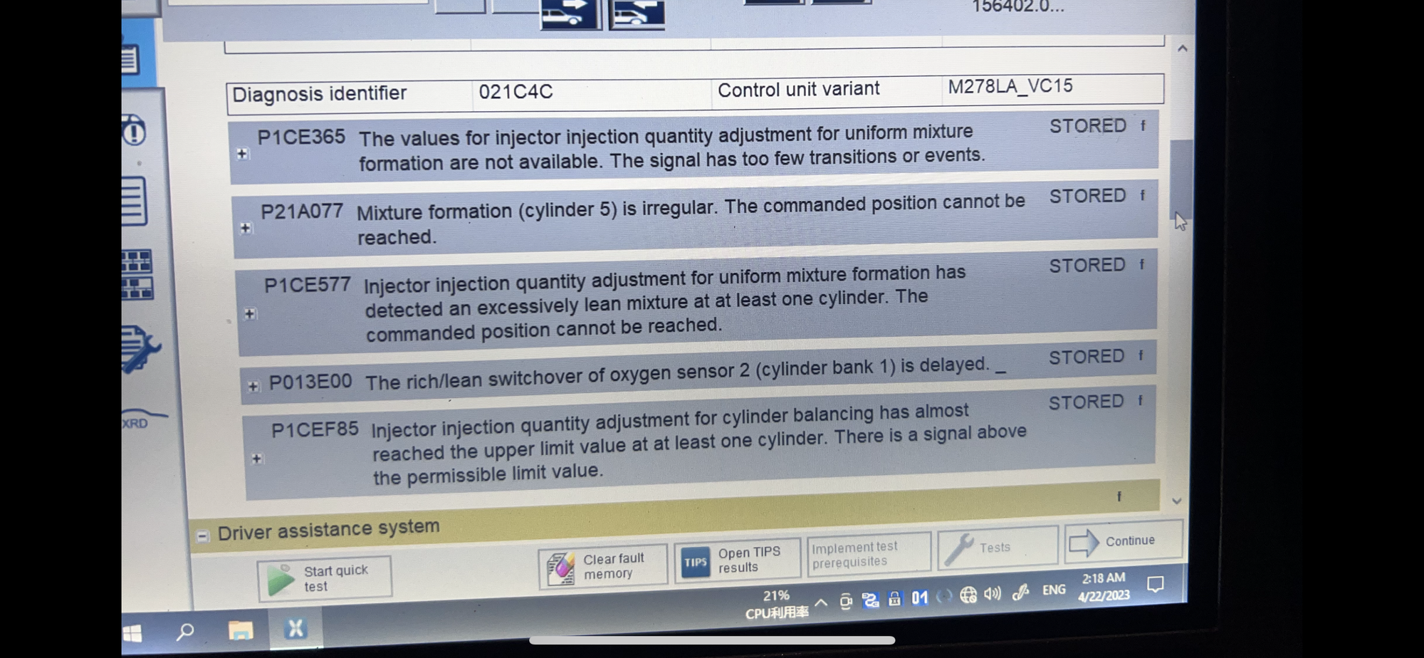

Old May 12, 2023 | 12:42 AM
Htownbenz's Avatar
Joined: Sep 2019
Posts: 16
2012 Mercedes e350 coupe, 2014 Mercedes gl550
Mine has these codes
See my photo, I got this code , are these in reference to the extended warranty regarding exhaust valve ?
QUOTE=mekantor;8758242]I would always see this one. The injector couldn't be adjusted enough to overcome the loss of compression.
[/QUOTE]
Old May 16, 2023 | 10:26 AM
W205C43PFL's Avatar
Posts: 32,336
Likes: 6,314
[/QUOTE]
Anyone figured out if it is indeed referenced to the warranty on the exhaust valve?
