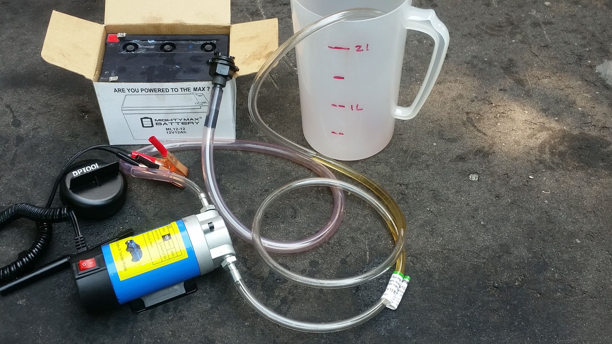

I would change the fluid according to many write ups.. if you have a torque converter plug let it drain also. I would not start it up and drain .. way too many things can go wrong for a beginner. Break down and buy a change kit pump… well spent money. I have used mine 15-20 times or more changing fluid on many MB 7 speeds.
Spend some time reading and watching youtube videos . Here is a simple read thru

atf fluid pump
https://www.ebay.com/itm/28491373503...mis&media=COPY
