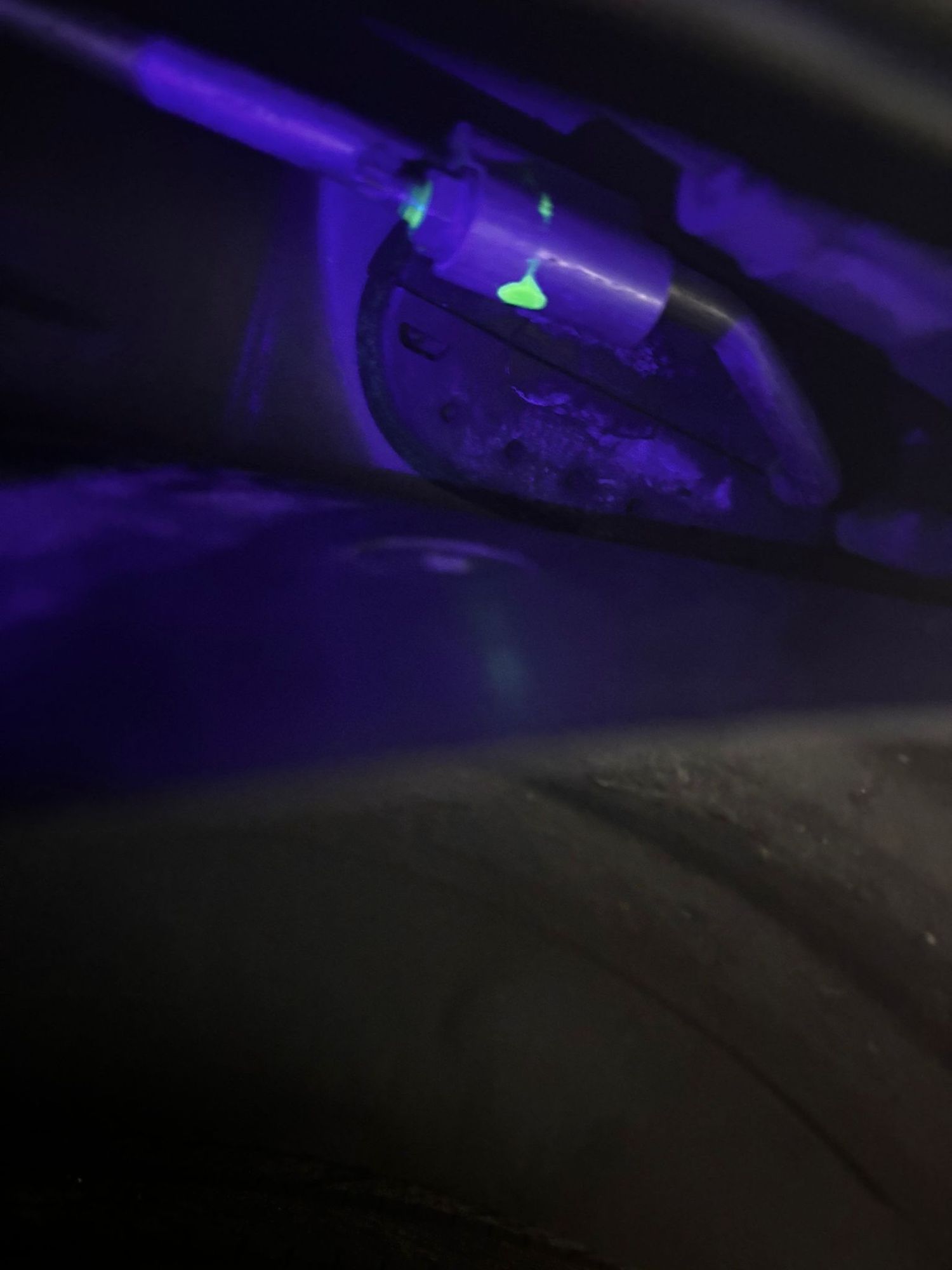

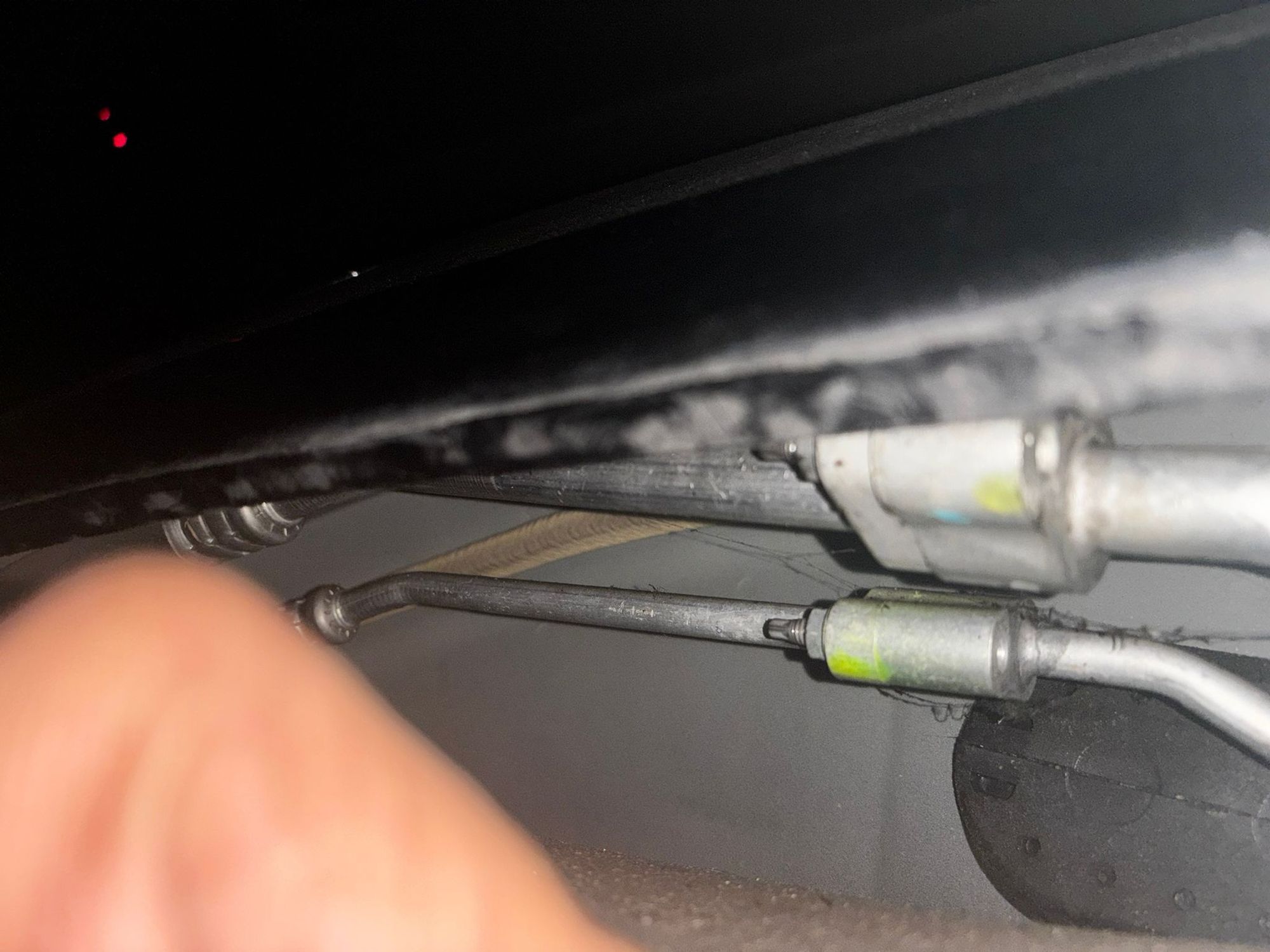

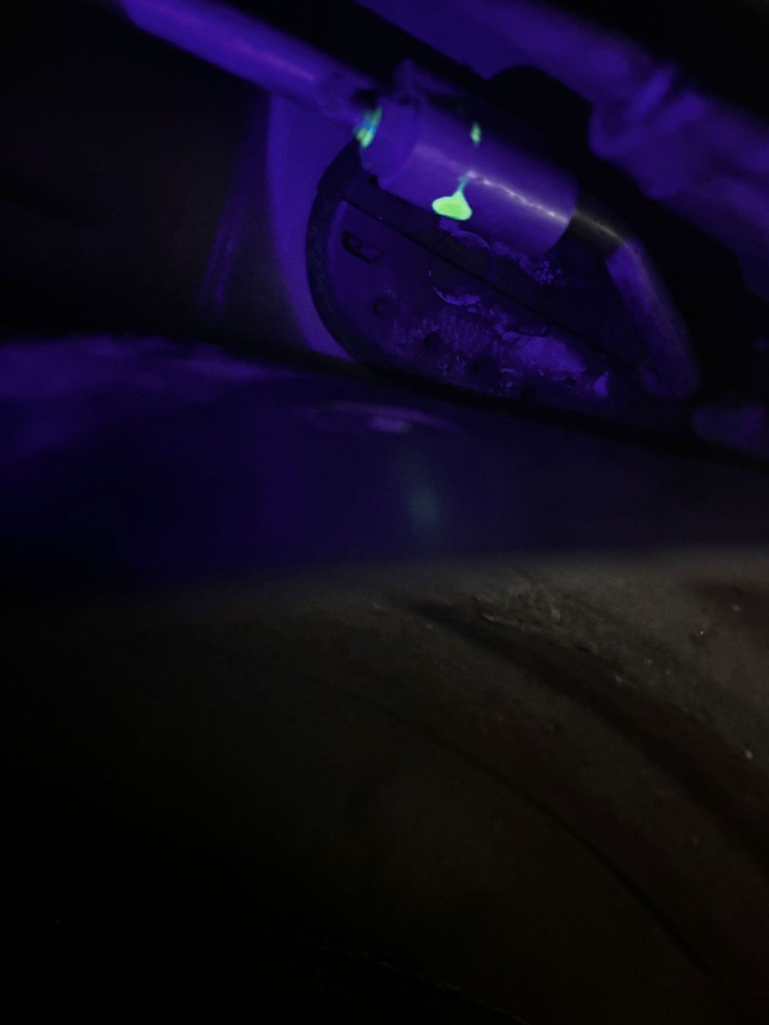

I have a 2014 GL 450 and am experiencing A/C issues for last couple of months. Inserted some UV die in the line and located the leak in the AC line above the driver side - Rear wheel well. It is in the Warm/ Liquid line.

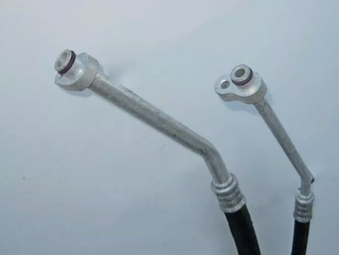

Has someone experienced anything similar and pls advise on a diy fix such as a line splice instead of replacing the entire line from front to back (A1668306015)? From the last pic, it seems if we just replace the O ring in the line that should address the leak. Thoughts?

Thanks. Was able to figure this out. The Freon leak was from the seals where the line joins the rear evap. Was an easy fix to replace the O rings.

Just drove back by mechanic and showed him oily residue on back wheel well and lower bumper, as well as pictures from this forum. He pulled out UV light and confirmed this is indeed the source of the leak! He is going to have an evap on hand in case it is not just the o-ring.
