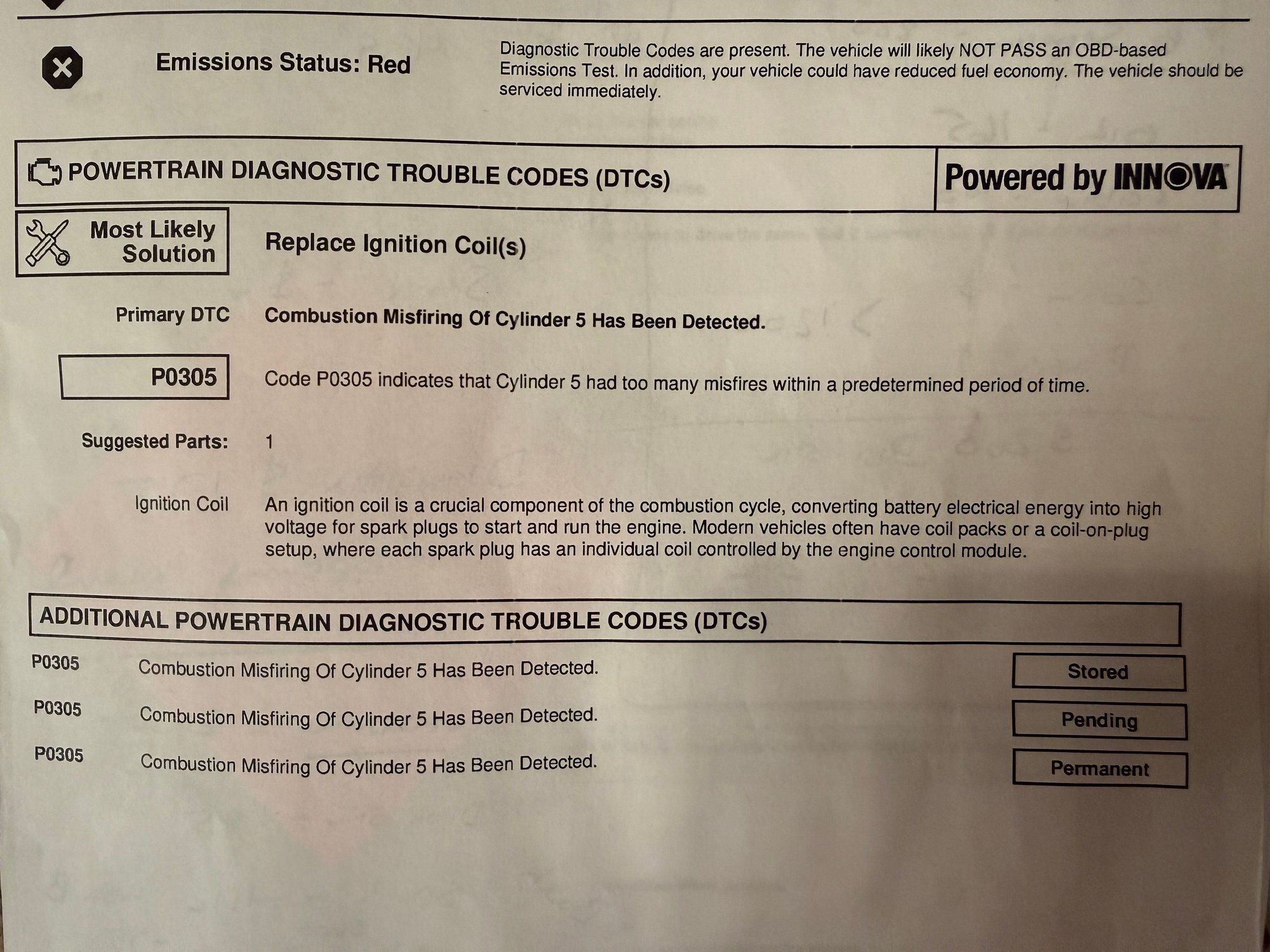

Can you share with us the CEL code? Also, a cylinder failing can mean a lot of thing like valve, rings, pistons, etc. What exactly did he say was needed to be replaced?
Old Feb 19, 2026 | 08:17 AM
Squatting Hen's Avatar
Joined: Feb 2026
Posts: 11
Thank you. Attaching everything I have.

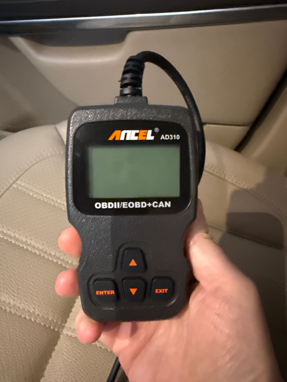

Also, I don’t have a reader. What is the cheapest one I could get to clear the code and see how long it takes to come back?

I've seen them as cheap as $23 on Amazon that says they can erase codes in the description. Do a little searching, a little reading on their functions. You'll find one for less than a shop will charge you just to plug it in and read it. However, most Auto Zones, O'Reillys, Advance Auto, etc. will read for free. Just roll in and tell them you have a check engine light and ask if they could read the code then erase it. Nothing ventured, nothing gained.

Bought this one and cleared the light. I am sure it will come back quickly though as it still shows on the reader.
Not sure if there are any other tests I should look at. It is a cheap one, but has a lot of stuff, things that make no sense to me lol.

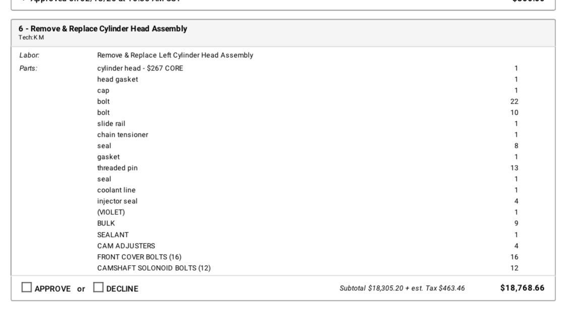

Whoa. Yeah, they want to replace the head and not telling you what is wrong. Having that P305 code is just that the cylinder is not firing. If they did the leak down, did he say where it was leaking? He should have been able to tell you if it was leaking from the exhaust valve, intake valve, or rings. That would mean that you had some sort of failure like a valve hitting the cylinder or something that fell into the intake to cause either the exhaust valve or intake valve to be bent. This is suspicious to me.
Now that you have a reader, try to change the cylinder coil from 5 to 6 and 6 toi 5. If the code read P306, then its the coil. Doing this is a very easy job with only 2 bolts for each coil. It can also be a shorting coil wire. Start with these and see if it fixes the issue. BTW, are you noticing that its running rough? running on 7 cylinders is very noticeable.
Also, he is charging you for every little bolt that you dont need. Like the front cover bolts. I dont know why he is saying you need 16 as there are maybe onoy about 8 of them and though they are torqued, they is no real pressure being applied to them like the valve/cam cover which I agree you need new bolt for. And there also isnt 12 cam solenoid bolt either. And those bolts are very expensive.

When a specific cylinder is misfiring well then it is something specific to that cylinder.
Read these links about troubleshooting a misfire; intended for novice mechanics:
also read thru the TSBs on this model/yr Vehicle.
OBD-II Trouble Code: P0305 Cylinder 5 Five Misfire Detected
P0305 Mercedes-Benz Code Meaning, Causes, Symptoms & Tech Notes

So did they already replaced the plug and coil as suggested?
That could solve the issue.
